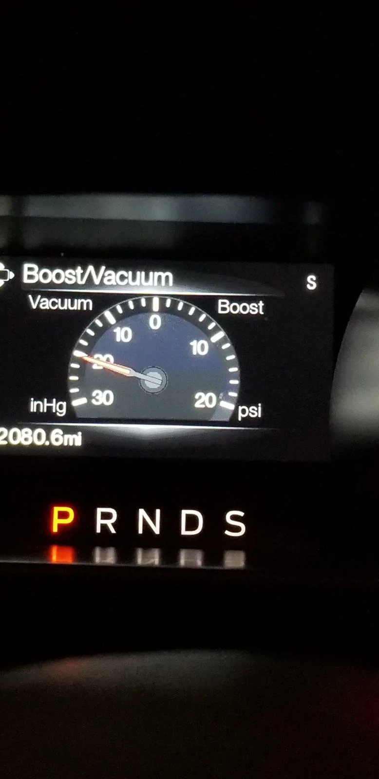

Only boost gauge is the OEM premium digital gauge. Here's a pic at idle. Anyone know what vacuum should be?

Vacuum at Idle, at your elevation should be around 20in/hg, so your gauge is fairly accurate. However, that OEM "gauge" isn't actually getting a manifold vacuum/boost source. The data is inferred based on things like throttle position, and RPM and probably other inputs. Basically the PCM is guessing what the manifold vacuum is. The more modifications you make to the motor, the less accurate I would think that gauge is. Also, I wouldn't expect it to react fast enough to register a rapid flutter in pressure, like a mechanical gauge will. For sure though, a compression test would be definitive. I think you would be able to hear a broken valve spring rattling or scraping, especially with a stethoscope.
