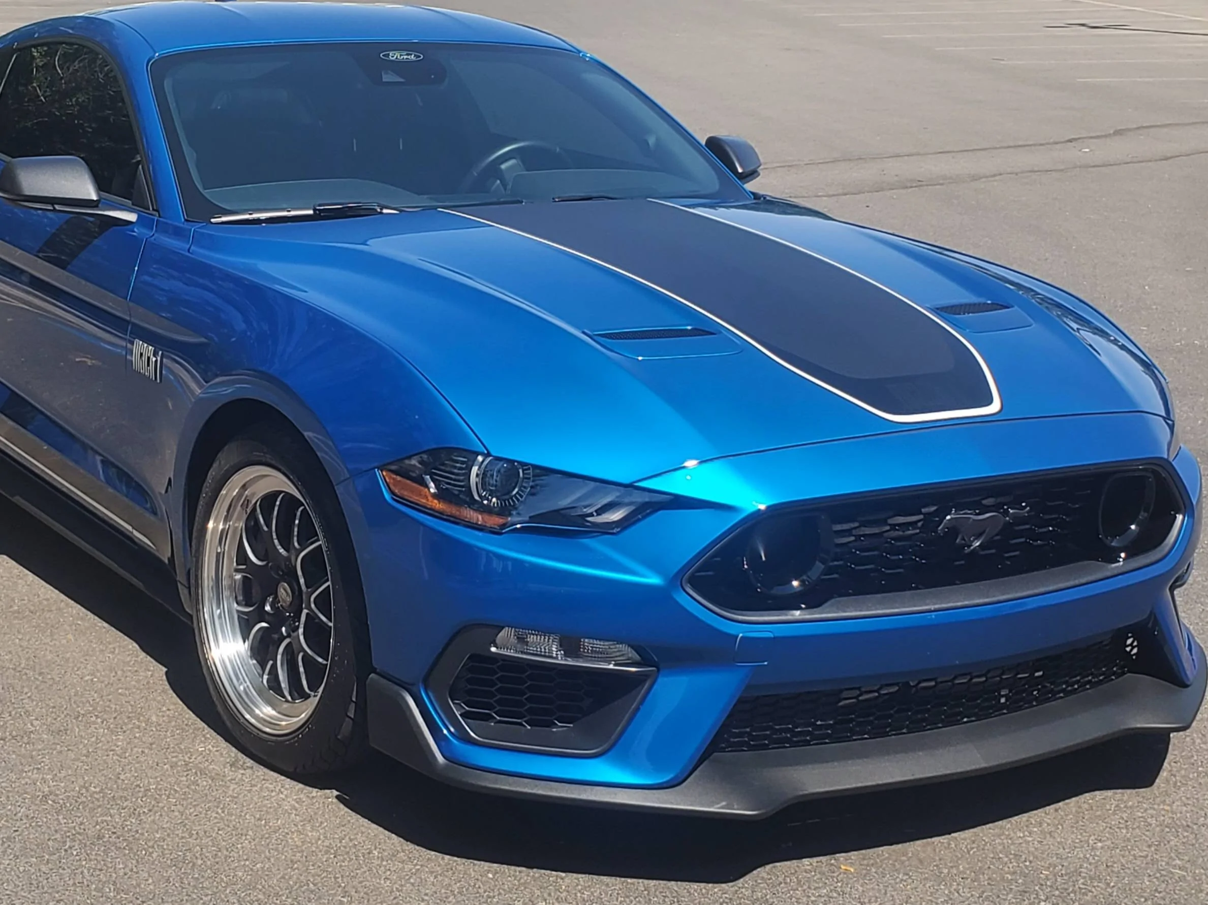

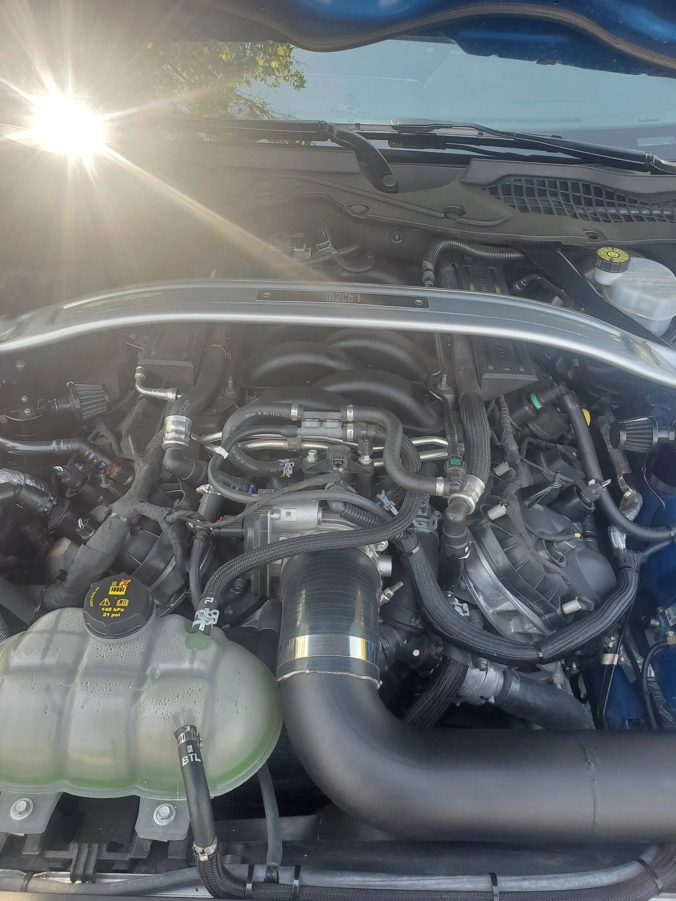

Hey guys new to the coyote platform. Been into the LT1s and LS1s for quite some time. I sold my 427 22 na maro 10 speed and came across a killer deal.
I found a 2021 Mach 1 manual with 9k on it 4k on the build. Its a gen 3 i have all reciepts on it as well. The previous owner put in boundary oil pump gears and crank pulley. Has a Hellion sleeper twin turbo system, 4 into 1 header option, 62/60 turbos. It has the 1050x injectors and w400 fuel pump in it. Resonator delete and digipower dual 3in cutouts as well. It was tuned by Lund using hp tuners and made 764 whp on pump and with 50:50 pump and vp 110 made 945 whp. The car with closed cutouts made 854 with them open gained 90whp where it got 945 whp.
The car is my daily driver and i am very happy with it thus far. But i want to know if im pushing it to hard? I drive pretty calm on the streets with some spirited driving just on low boost 5.5-6psi. To be honest ive not even tried high boost yet which is set at 12.5psi. The car is used for daily driver and some fun here an there with a few roll race days at the local track using a weld s77 drag pak. Was wondering if i should look at getting a better tune by someone like palm beach or wengerd? Seen a few articles where palm beach has been able to get over a 1000hp on pump gas on a stock sealed gen 3 same turbo system with some fore fuel system upgrades. Been looking into a fore system as well. Sadly i would love to have a flex fuel sysyem like my gm had but was told ford doesnt have this yet. There is just one E85 station here so dont want to be limited to having to fill at that one station. To bad there isnt a on the fly tune switch to go to 91 to e85. Maybe in the future.
Would just love to get some suggestions even if its your good leave it alone haha. Thanks guys excited to be a part of the coyote group so far very impressed!
