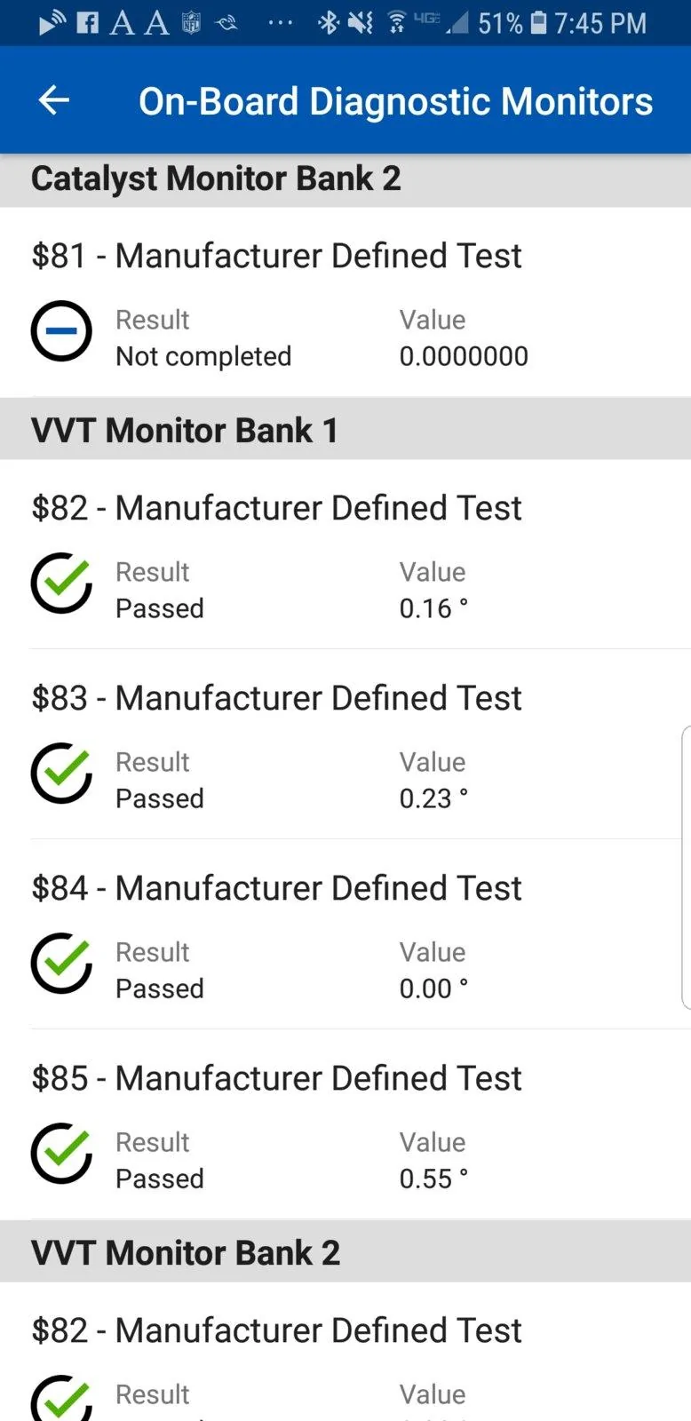

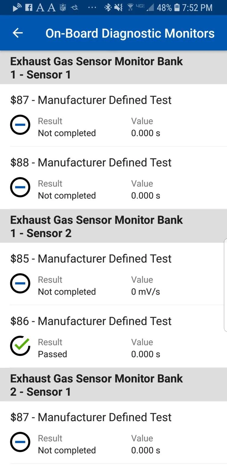

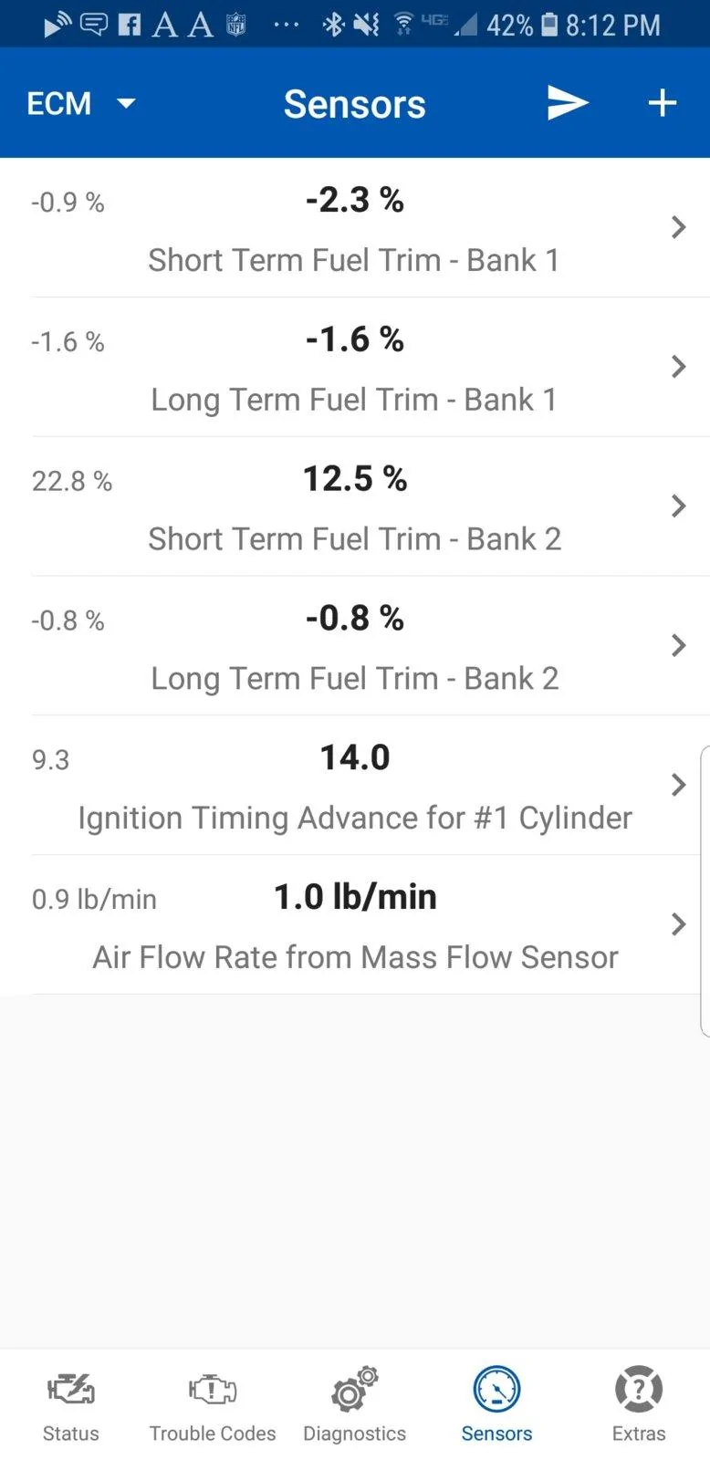

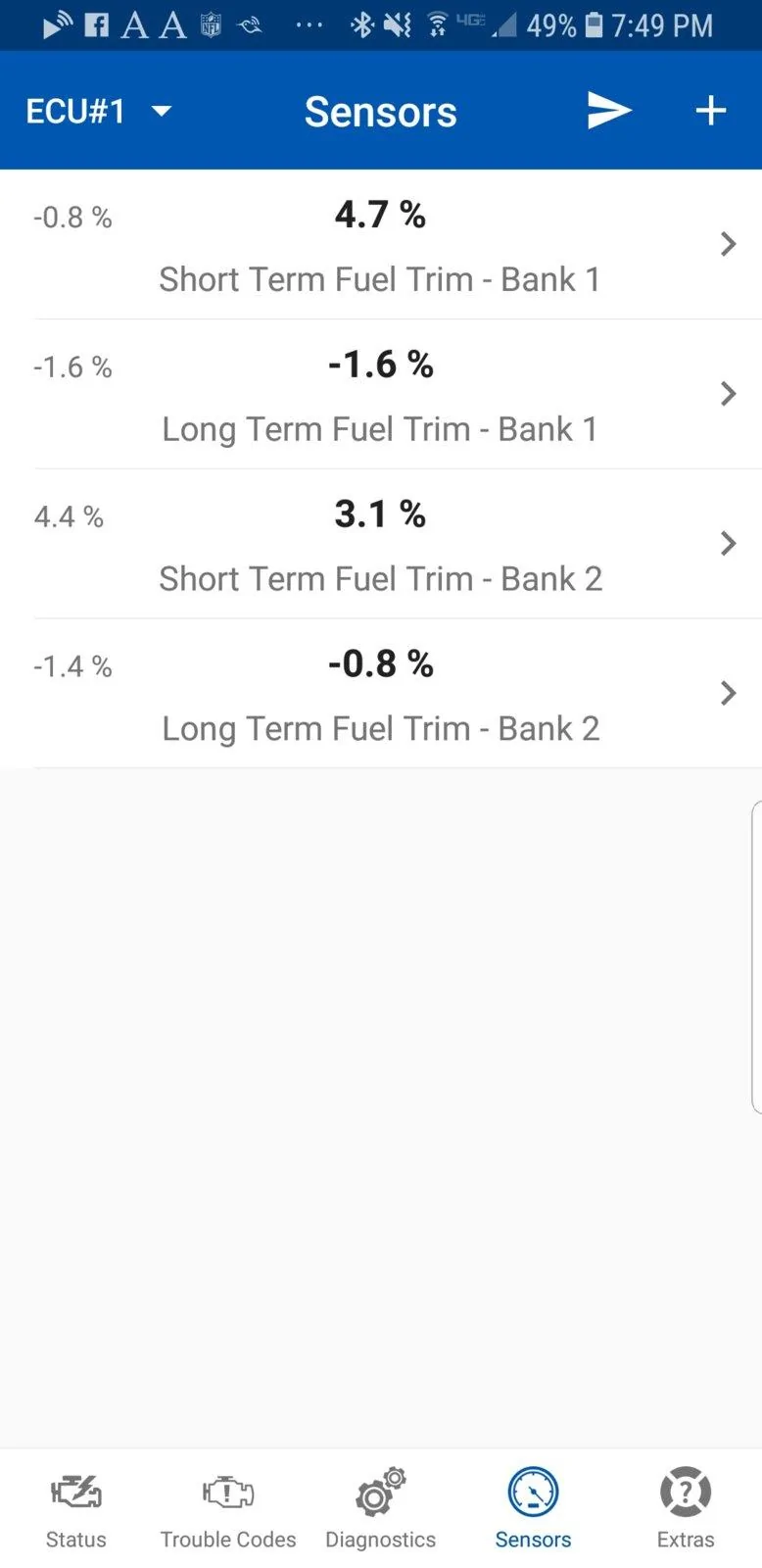

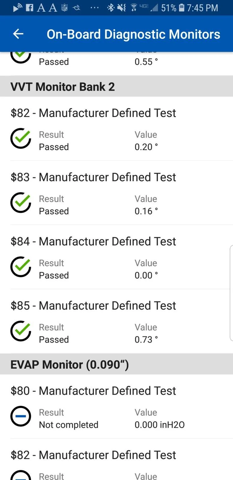

So I was at the track (HPDE) and when I pulled off, the car was running rough. Earlier in the day, I went off into grass but car was fine afterward. There was some grass dust in the air intake (stock) box and filter.
Now, it is running rough with strong exhaust fumes.
No DTC's, no CEL.
Car idles at 750-850 rpm. Runs ok above 2500 rpm. Drove hone from track (2 hours) but couldn't drive in 6th.
Short term fuel trim is up to 25% on bank at idle. No misfire codes. No misfire noted during idle. Or 2500 rpm.
Any clue? O2 sensor?
I haven't pulled any plugs yet or done compression test.

Both banks or just one? Check o2 readings, and maf readings for erratic behavior. Can't believe it hasn't set a cel yet. Flex learning could be bonkers as well.

I have screen shots on phone from obd2 scans.
