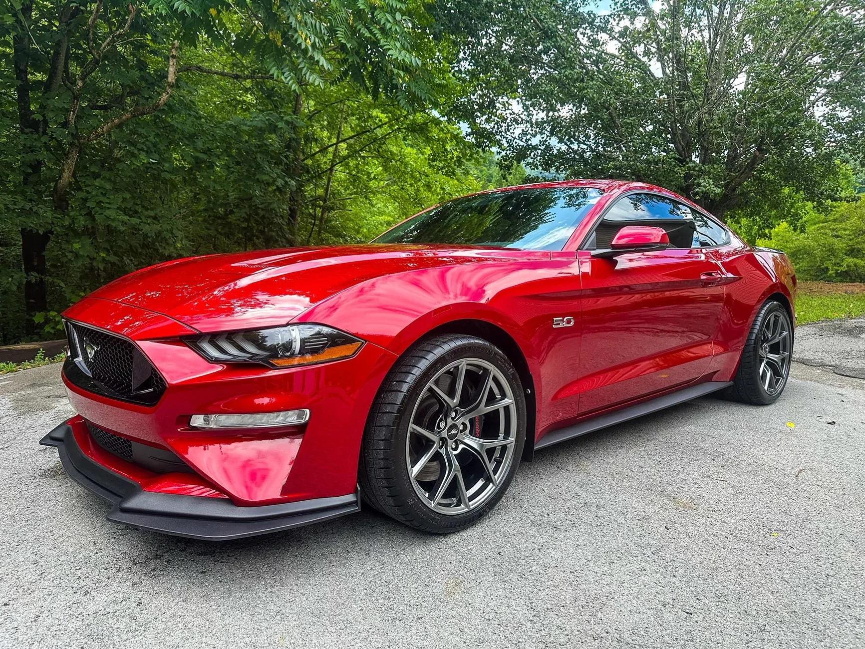

or find a set of 18-20 Oem PP2 wheels. Ford set it up for 305 square. You ll get a little polk in the front. What about GT350 setups, will they work?
Rear offsets on the GT350 spec wheels may be problematic on a GT. 19x11 +62
