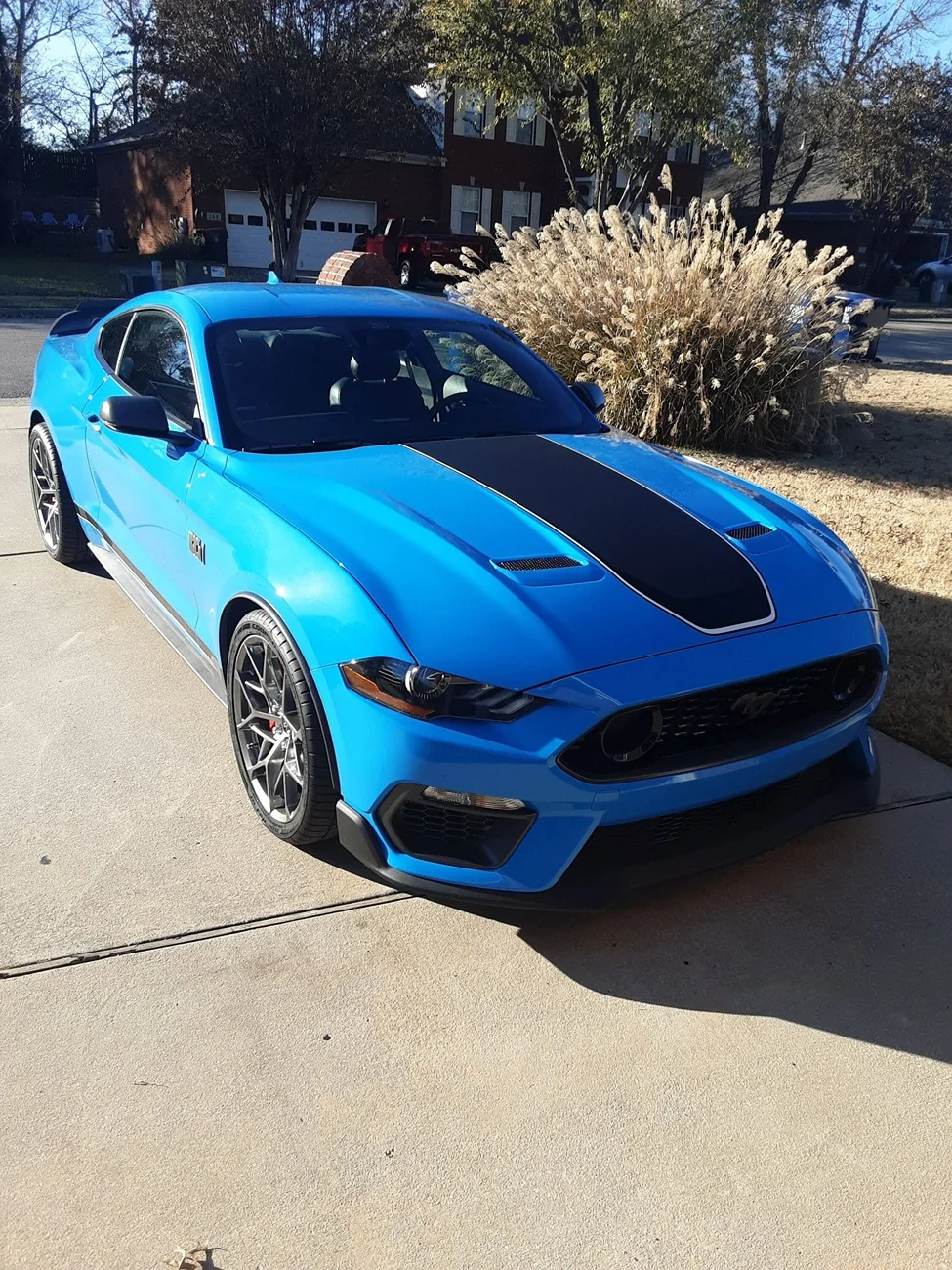

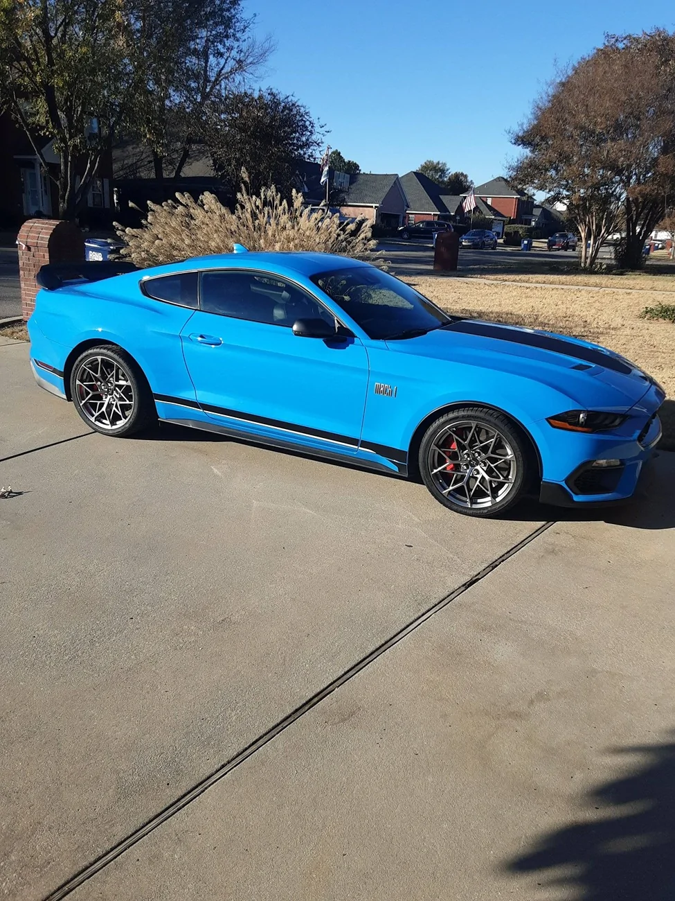

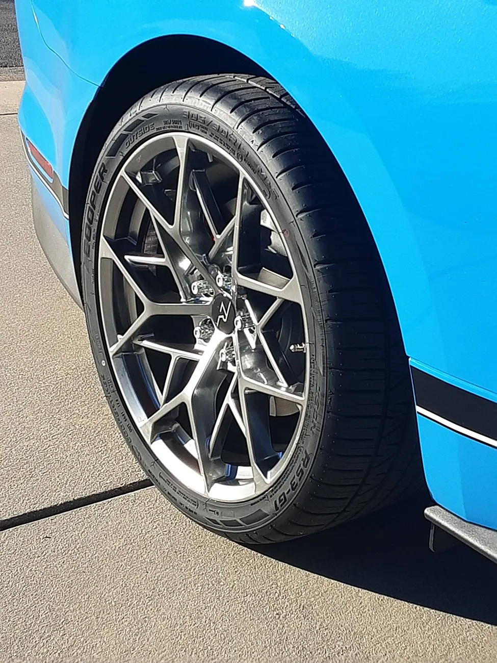

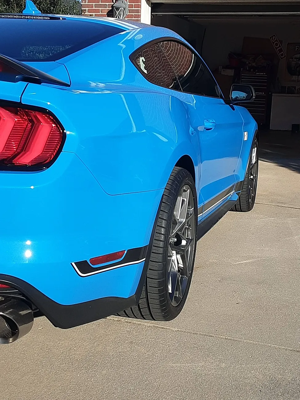

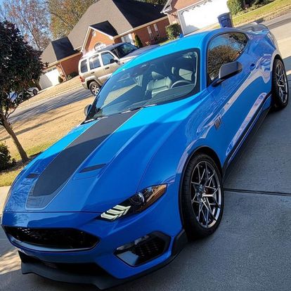

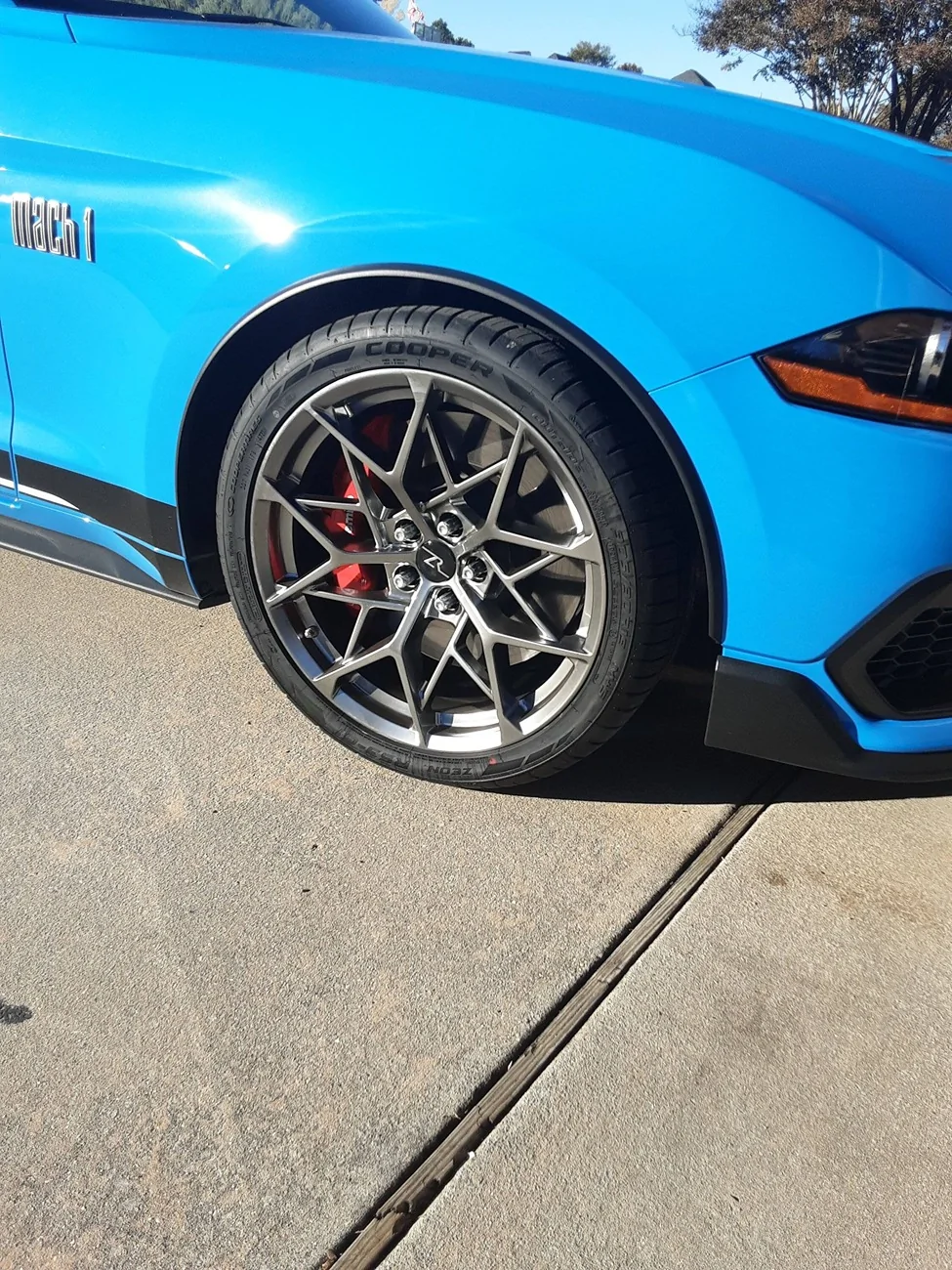

I just want 305's all the way around. easy peasy. it looks like i'll need a 10 wheel up front and I can go 11 on the back. not understanding why i'll need spacers in the front to run 305's?
I know you asked for some other side shots etc. I found these on an old post. Ignore the F-150 lug nuts. That all Discount had in stock to mount.
T Fades
Nov 21, 2023
118
170
CA
2023 GT 6spd active exhaust
If you are dead set on a specific tire size, to go the tire manufacturers website, and in the specs for a particular tire size, they should mention a range of rim width, and a measured rim width. If you want best performance, focus on the measured rim width.
A 305/35/19 has a rim width range of 10"-12". While they may 'fit' a 19x10 wheel, that would be for a bulged look and not ideal for performance. A much better size wheel for a 305 tire would be 19x10.5 or 19x11.
