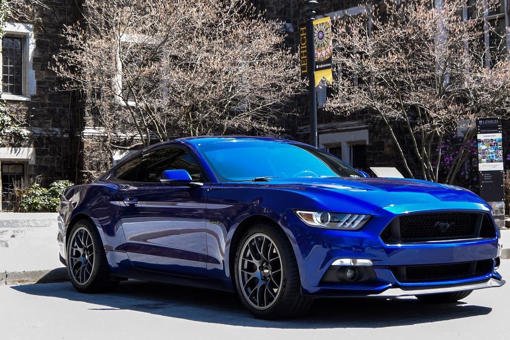

Below is one of our featured packages that is $400 off MSRP. I cannot list pricing in this thread but feel free to PM me if you're interested.

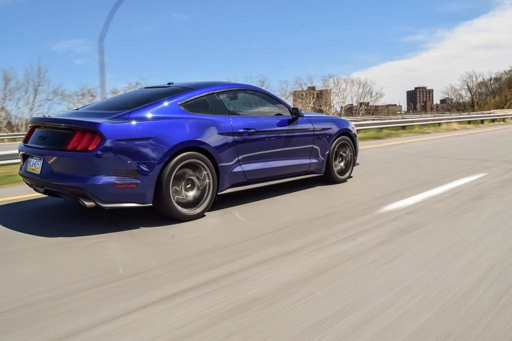

(4) 19x10” ET40 EC-7 Wheels in any finish
(4) TPMS Sensors & Color Match Metal Valves Stems
(4) 285/35-19 Michelin Pilot Sport 4S Tires
Free Mount & Balance
Here is Stephen's gorgeous 2015 GT on this exact setup. No spacers necessary or concerns about rubbing. Best part is being able to still rotate your tires around to extend their life.

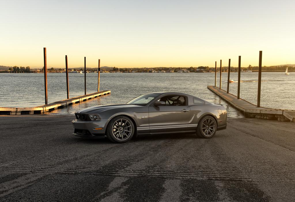

This S197 is running 19x10" ET40 all around wrapped in 285/35-19 Michelin PS4S

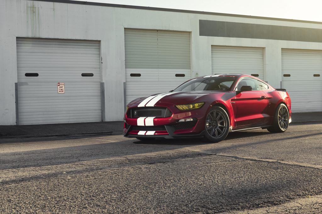

And this GT350 is sporting 19x11" front, 19x11.5" rear
