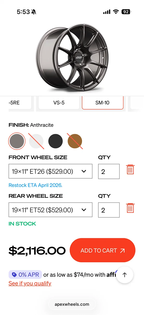

If you want to run 19x11 all the way around, go to Apex Wheels. This is the fitment you want if you don’t want to run spacers up front (even though you have a PP car, you can in fact run spacers)
went there, they have like 4 options to choose from...........

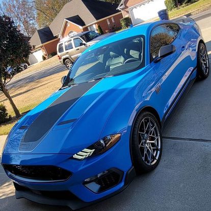

I removed the OEM MACh1 HP wheels that are a staggered 19x10.5 front and 19x11 rear and went with a 19x10 ET35 wheel on all four corners. The car came with 305/30/19 fronts and 315/30/19 rear Cup 2 tires. I'm now 305/30/19 squared!
