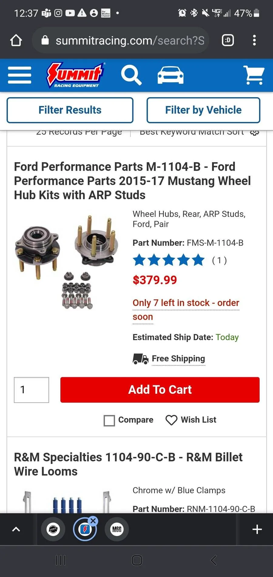

You really don't need/want extended studs on the rear hubs (unless you like the look of studs sticking out).
Did you confirm the hubs have play, or just throwing parts at the problem?
