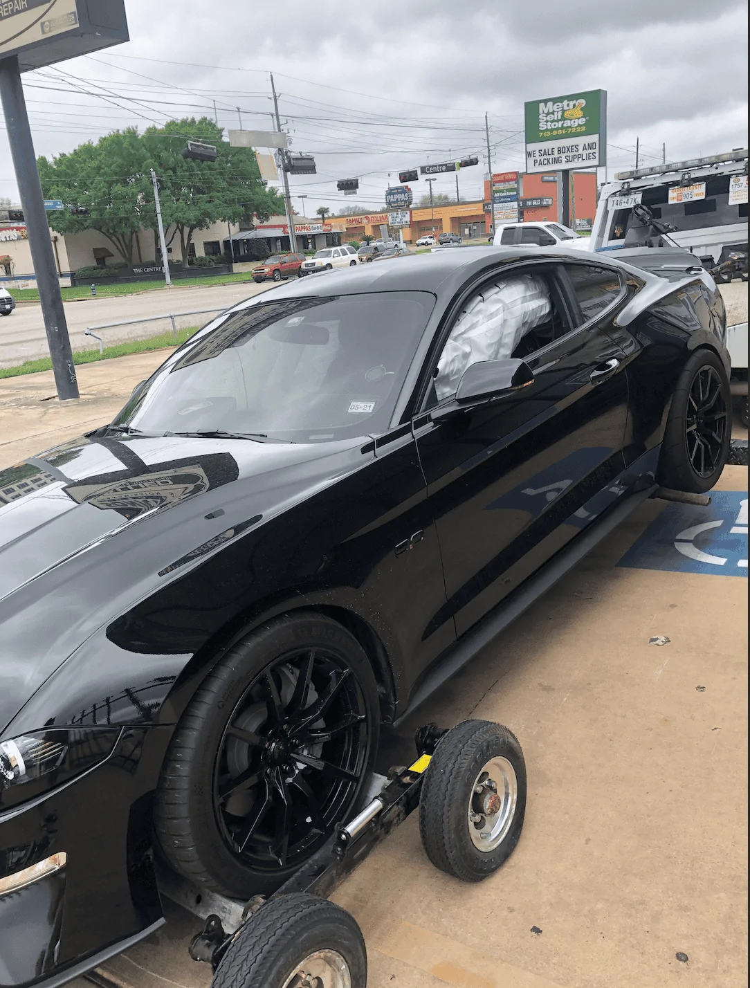

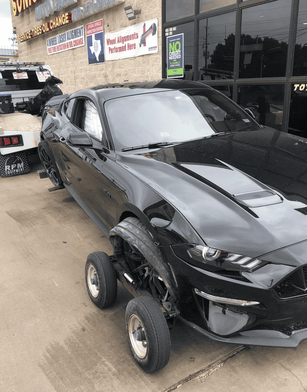

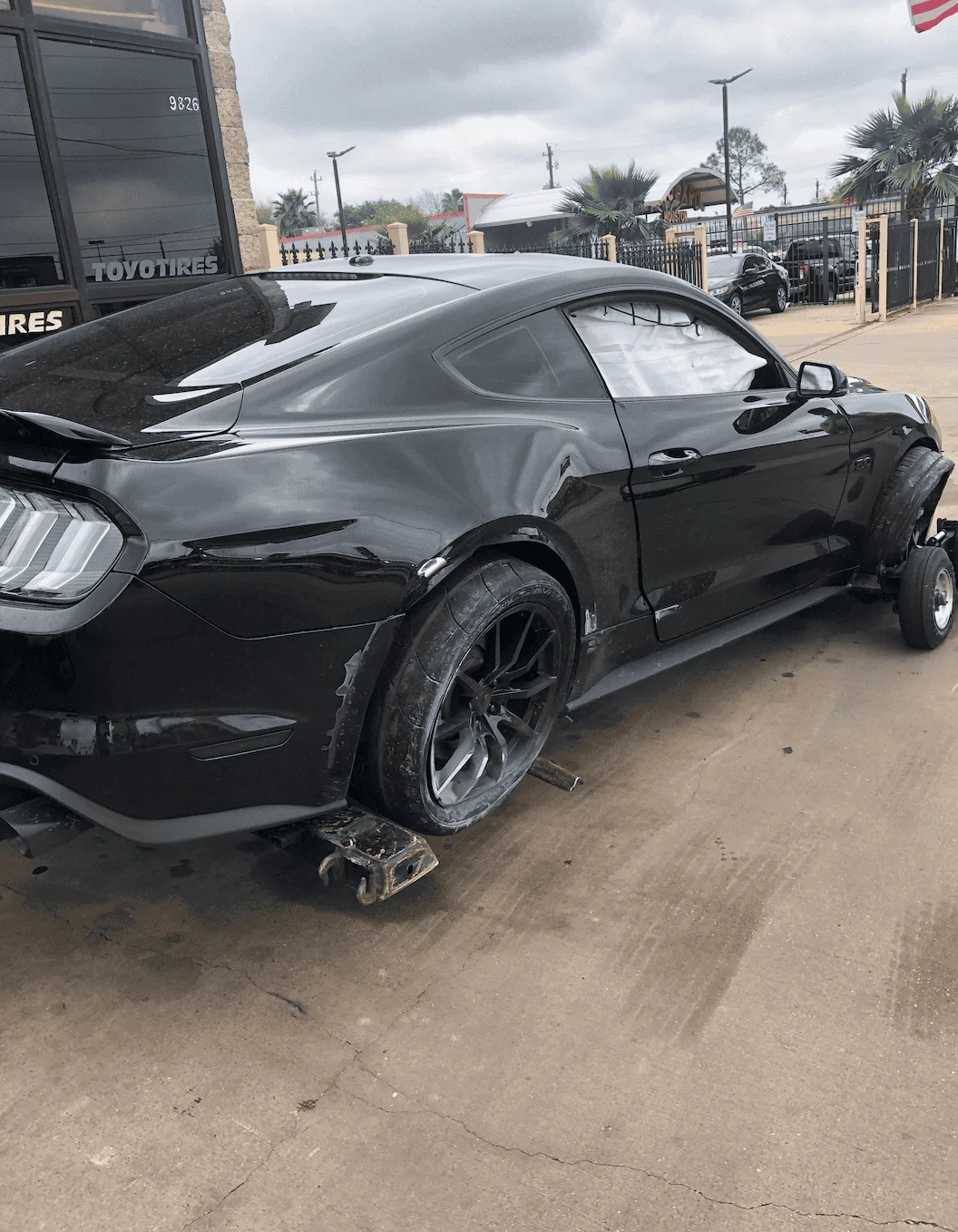

No problem. Are you referring to the control arms? The accident was only on one side but obviously the force of impact to damage other areas. I will post my accident. I basically lost control ( haha... i already owned up to it as a big dummy ) and slid into a concrete median. I was unfortunately caught in the rain on et street s/s.

Yes I was referring to the control arms in the front. After seeing the pic I’d be surprised if they weren’t bent on that side. I think the steering behavior you describe goes along with this as well though if one or both of the arms were bent with the double ball joint setup.
Have you already had some suspension items replaced other than the camber plates in the front? Idk if it’s just the picture, but the rear looks cambered out like crazy. Have only dealt with a handful of crashed cars, but I’ve normally seen something bent when there’s an impact big enough to move an adjustment that far.
