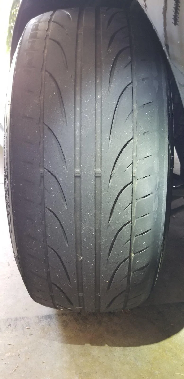

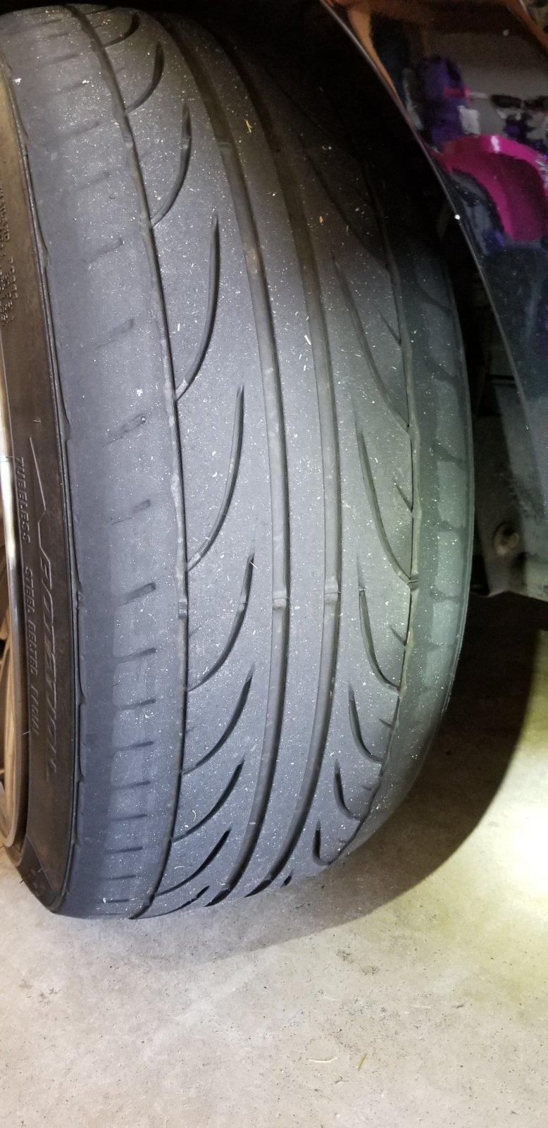

Hello guys and gals,
I really don't post on here but need some help or advice.

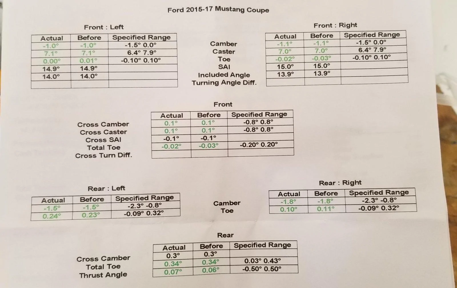

So my front tires are wearing really bad on the inside shoulder on both front tires. The suspension is stock and the alignment set to OEM specs. I noticed they wear about 4 months after I got the car when i was replacing my rims. I put new tires on the rear and they still look fine today and kept the front tires but just flipped them. So after 4 months of having them flipped the inside shoulder wear again. I went and had my alignment check today and it's all in the green. Does anybody have any ideals or had this problem.

Im running them at 35psi and the out side is like that because i had them flipped. Ok i looked and its been about 5 months so its around 8500-9000.

Best guess is, you corner hard, and they're just cheap tires. And you already know you're using the wrong size tire for the rim they're on.
For cheap UHP SO tires, 8K-9K miles is sort of normal. Get better tires, in the right sizes for the rims, and keep them at the proper PSI, you should be GTG.

What size tire? It looks like you are stretching it out a little, which could possibly put more focus on the outer part of the tires vs the inner part. I'd bet that has more to do with it vs tire pressure.

They should be able to get what ever alignment you need in the front without much trouble. Will probably need some camber bolts. I was seeing wear like that on mine since it had pretty much camber. Too much camber or/ and toe out can really do this with tires with very stiff sidewalls and a little low on pressure. I had the Falken version of those tires and I needed to have very high air pressure to not see that. Like 40PSI. So I now have my camber set at the minimum with just a 1/16 toe in and having great tire wear. If you have a level stand it up along the tire with the bottom against the tire or rim. Get the level perfectly vertical. Then measure how far the rim is from the level at the top portion of the rim. I like mine about 1/4-3/8. It still handles very good since I have low sidewalls on my 20 inch rims. The bigger the rims the less camber you need and can get away with.
Stretched tires doesn't help either. As you go thru a hard turn the inner sidewall sort of stands up under pressure and makes things worse on that very inner edge. I looked into this alot because I have seen the exact same condition especially on my older G35 which did not have camber adjustments. All I did on that was keep adding toe in until it got better.

Yeah the guy at the alignment rack wanted to oblong the holes up top so he could bring out the camber a little bit. I guess my best bet is to try a camber kit up front to bring it out a little bit and buy better tires. Thank you everyone for helping me throw out some ideals.

Those look far too narrow for the wheels. That's one reason you're getting inside shoulder wear. I'd reduce pressure to 30.
