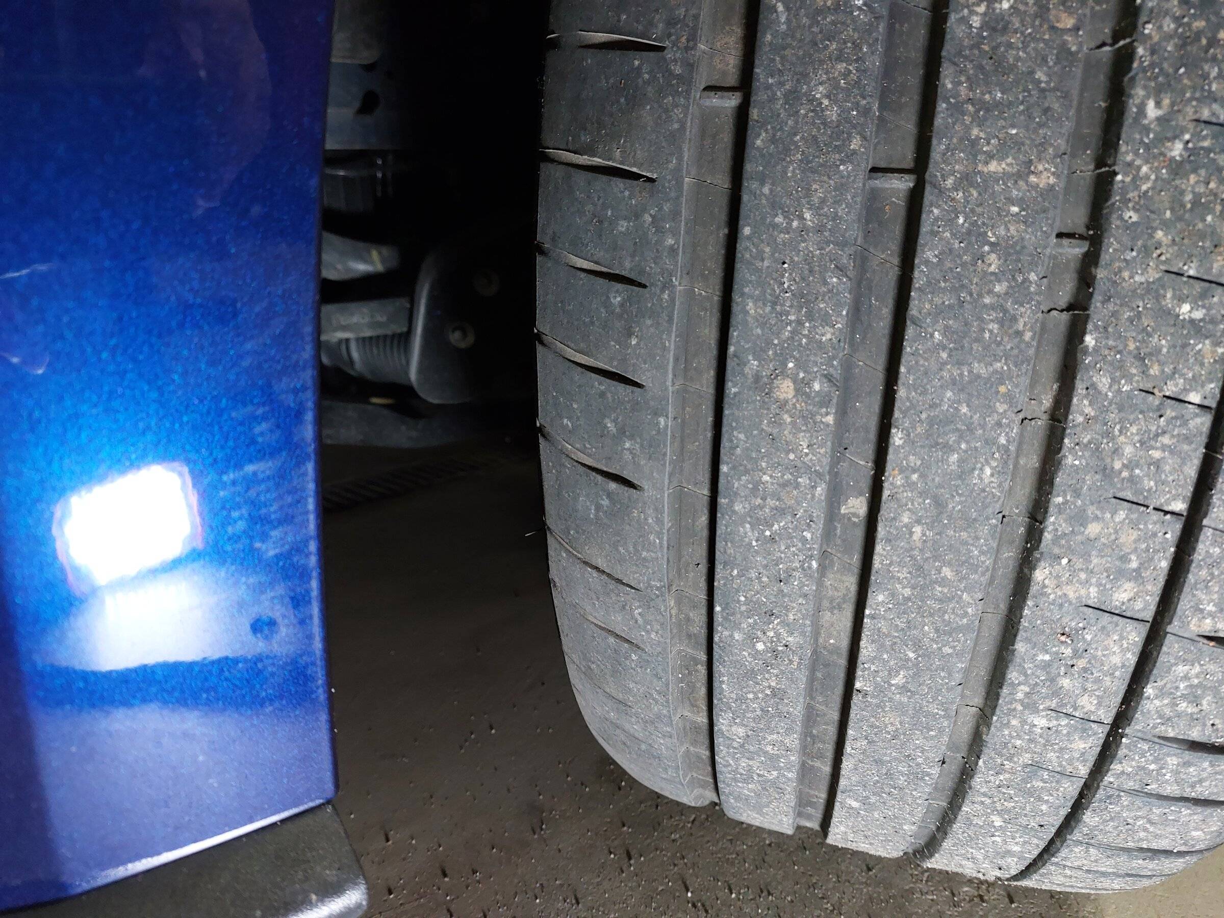

I've read a bunch and see the front end on these are hard on tires, I'm noticing cupping on the inner of both front almost more on shoulder than tread. The tread is wearing pretty even side to side. Front end is stock and it's more daily driver/toy than raced. I am taking it in next week for an alignment check to see where it stands, and it drives good. by hand with tape the toe looks dead on 0 or a tiny bit of toe in, hard to be precise with tape but didn't see any toe out. I have a few thousand miles life left and if there's something I should do I would want to address it before buying new. Any thoughts or ideas welcome. Thanks all. Jim

hard to get good pics. They have just under 13k on them. They are the original MP4S in 255/49/19. Royal Crimson called it scalloped and that is a good description.

Check the alignment when these wear through but thats a /very/ common wear pattern on MP4S, with stock alignment or aggressive camber, same results.
Seems to be an issue with the tire construction/design, because we only see this pattern on the pilot sport series michellins.
Lools like you have a few thousand miles left before these show cord there.

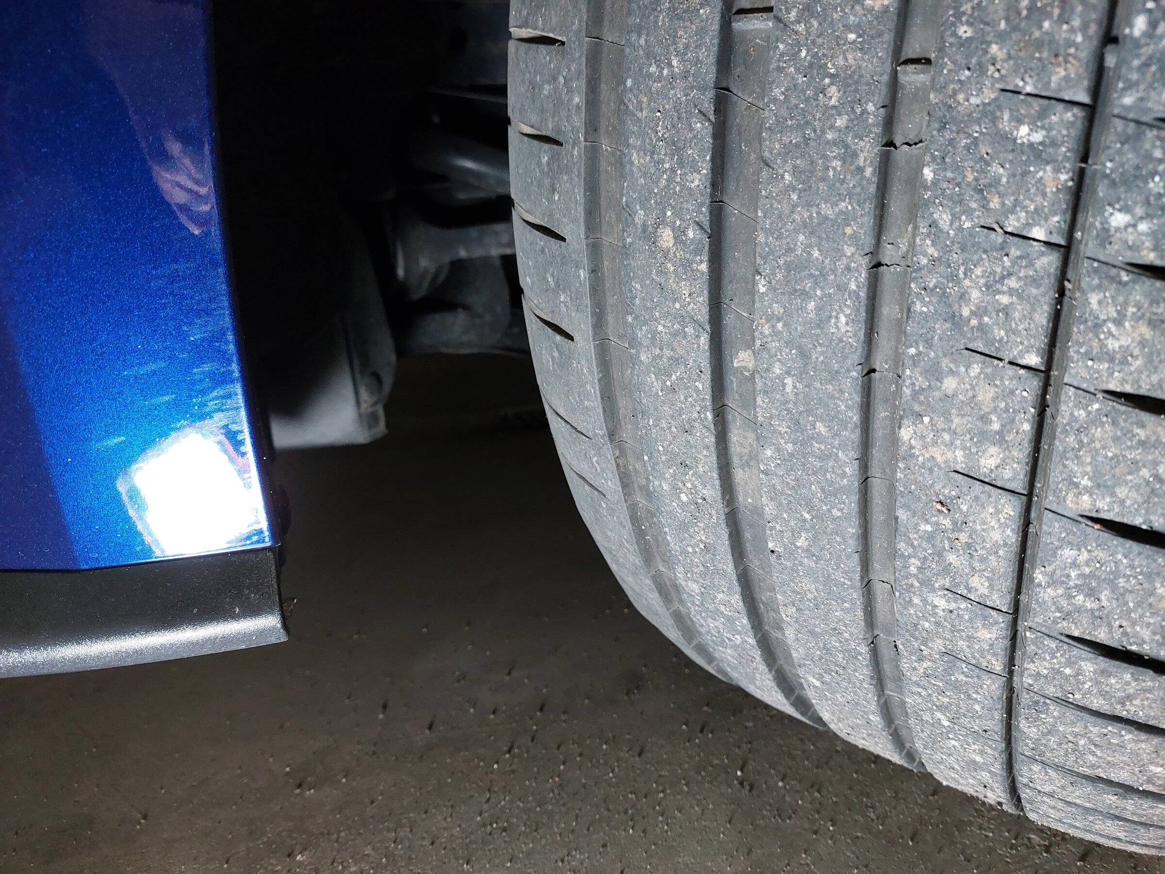

I have a similar question but I'd rather not start a new thread.
I'm about to swap to my summer set on my 19' pp1 when I noticed one of the fronts is wearing unevenly on the inside. The other is fine. What puzzles me is the winter tires (which are directional so I figured I'd narrow down which side) are not showing the same wear. Both inside and outside are wearing evenly for all four. I also had my alignment done last year and they said it was fine.
It's obvious just by looking but I used a tread depth gauge as well. The car has 24k on it and I'd guess around 15k of that is on the summer set. I wonder if this goes along with the design issue mentioned.
I'm no expert but I think this tire is shot. Unless someone thinks it could have some life left.
