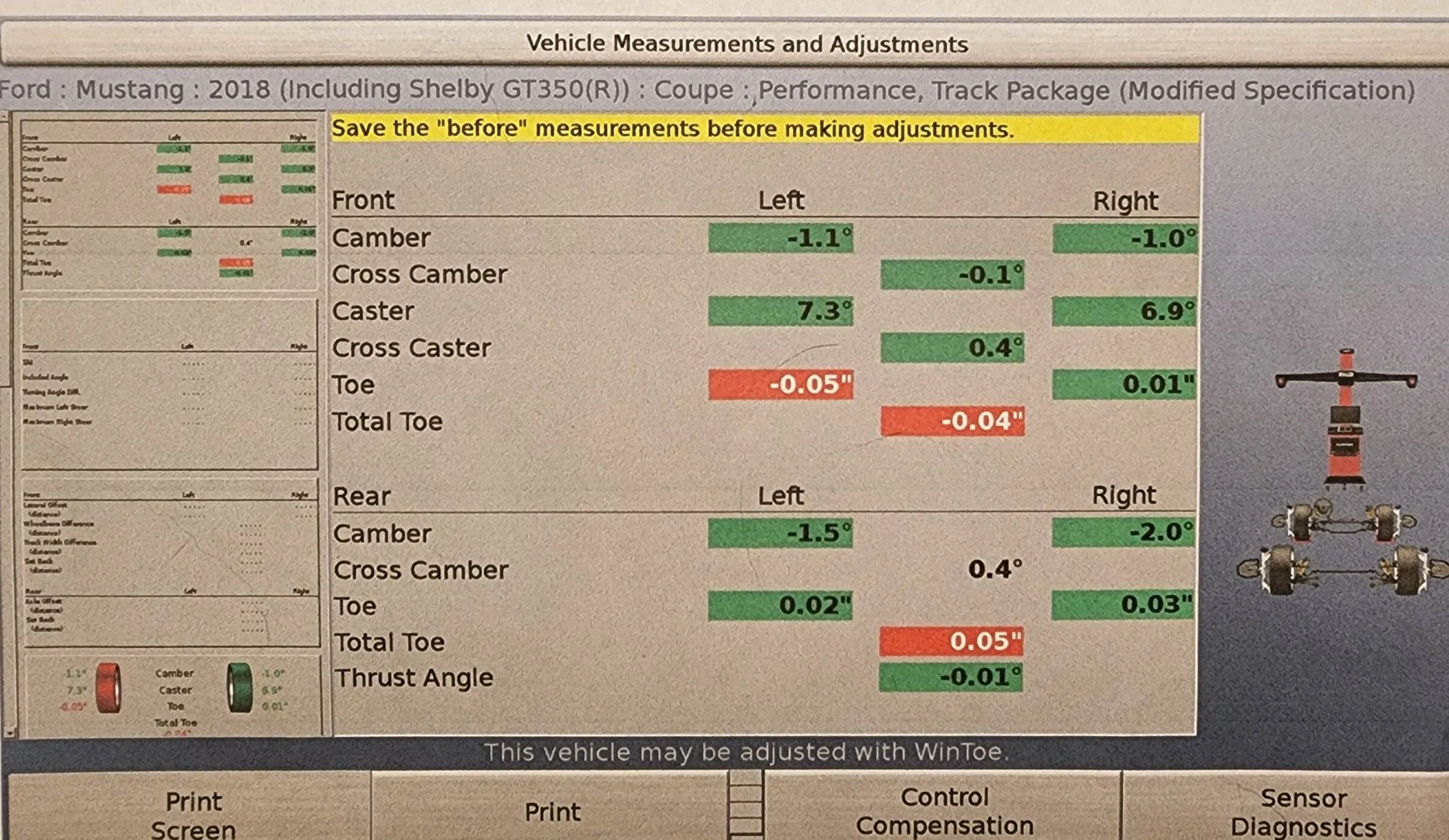

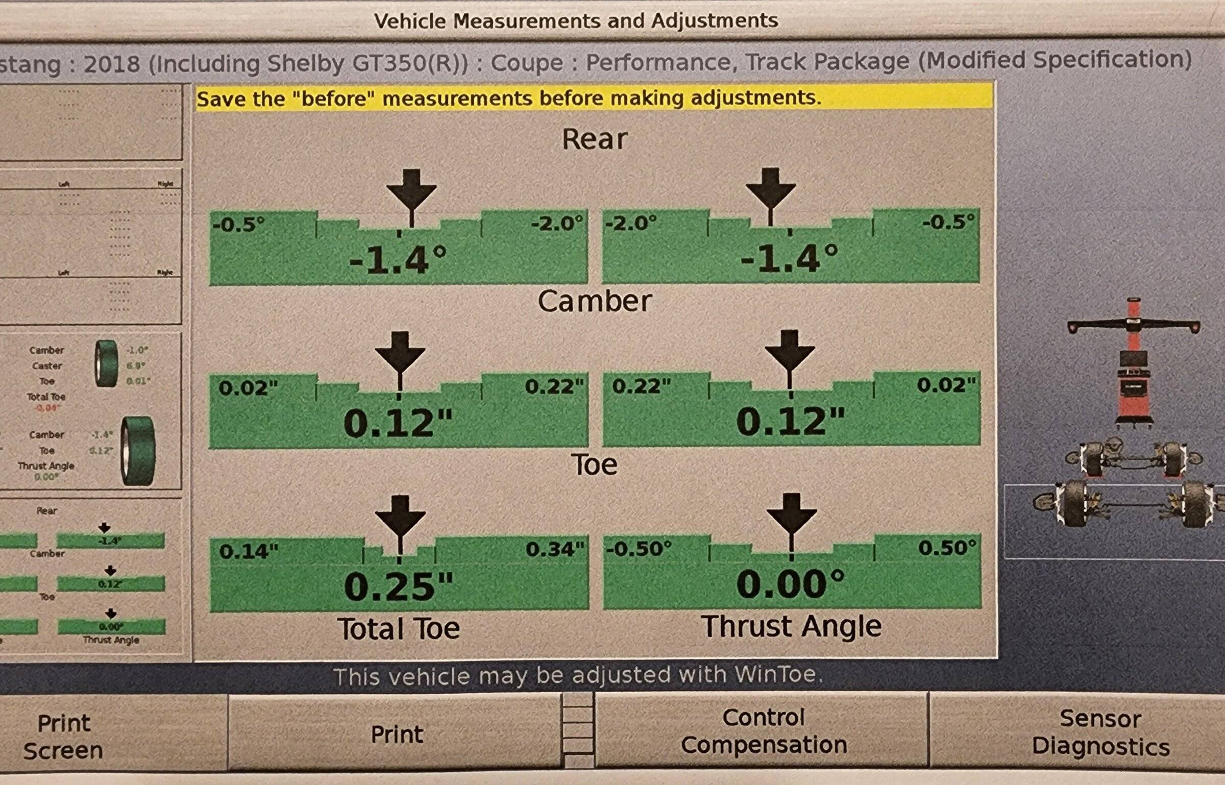

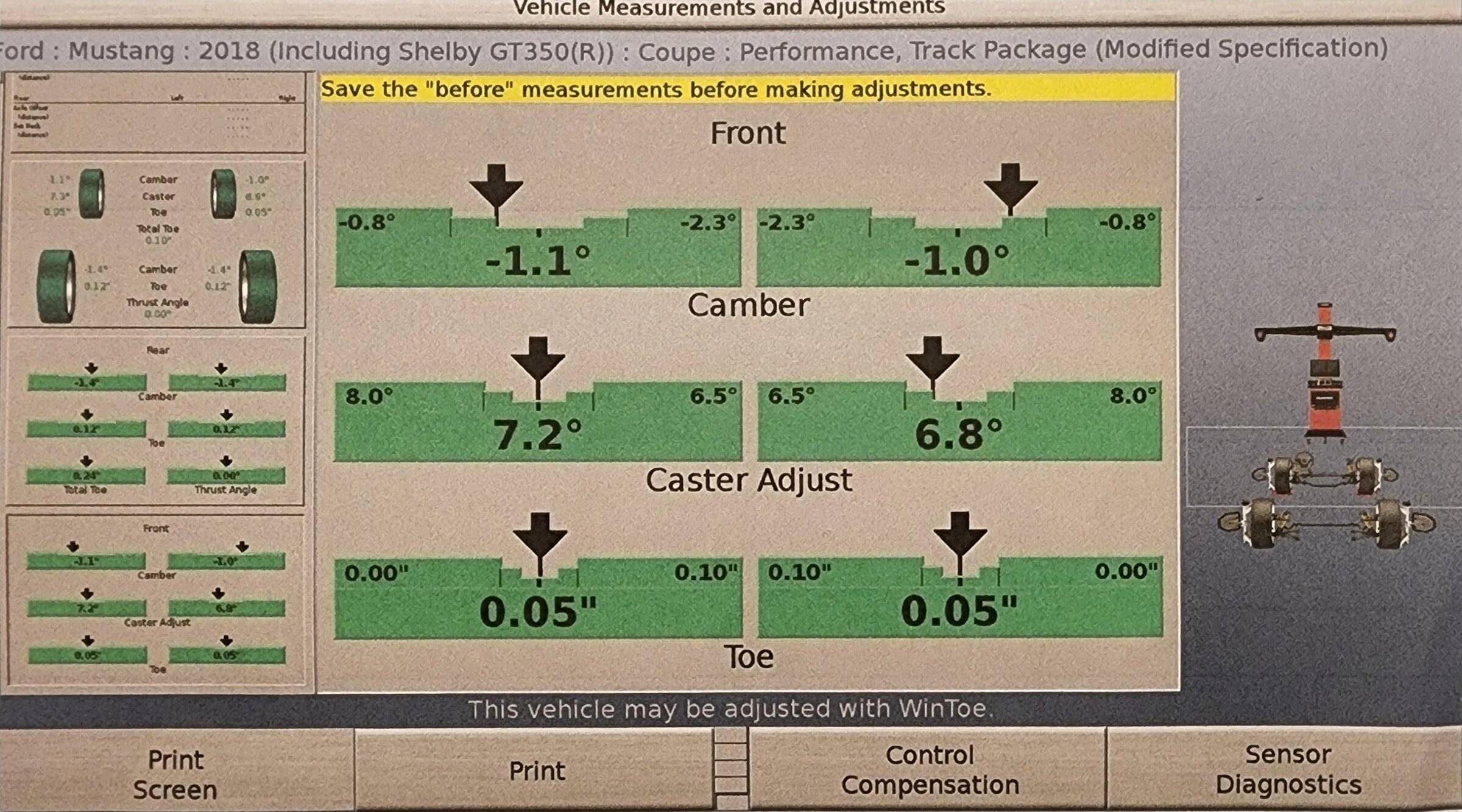

Alignment day, camber was ok. driver side -1.6 and pass. -1.3. Toe was about .7 out combined and I asked for and received half a degree toe in each wheel so I happy with outcome.

I got mine done a little bit ago. My tire was definitely negative toe on one wheel. I'm really happy with the alignment, considering I didn't have camber plates. The car feels noticeably better and more predictable.
