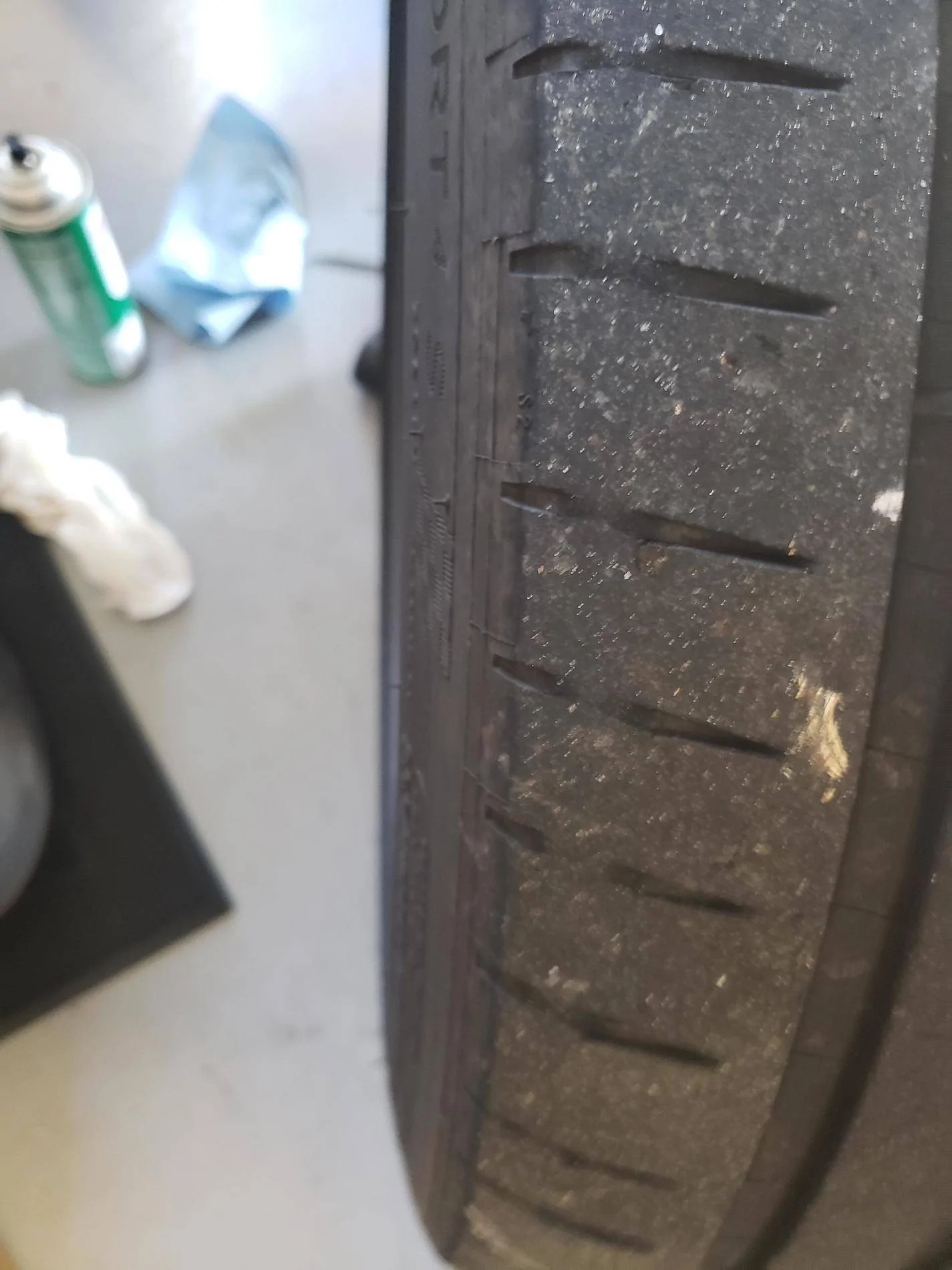

    I am getting more wear on the inside of my front tires, I am assuming this is because I live in Florida and we have mainly straight roads and the car comes with some camber on the front. I am wondering if I should inflate to a higher pressure to try to move the wear more evenly over the tire tread? They are currently at 32 or so for the front , stock pp1 wheels and tires and alignment.

    Just visual you can see a spot on the inside edge is flat where there used to be tread. I forgot to mention I did have 1 inch spacers on the front for a while, I took them off though.

    Appears you have too much front toe out. Camber wear would be further in to the tire. From picture, it also looks like you may have a slight belt separation. See how the tread block look smooth and others have a sipe?

    Yup thats what my last two sets of Michellin tires looked like at the tail end of their life.
    check the alignment at some point but start saving up for your next set. How many miles on this set of tires?
