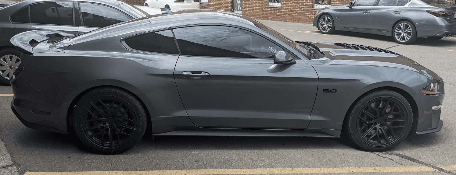

I'm running the minimum drop springs on my 2021 GT. I like it low but not too low that I can't drive over civilized roads and going to the mall etc.
Gear is in my sig.

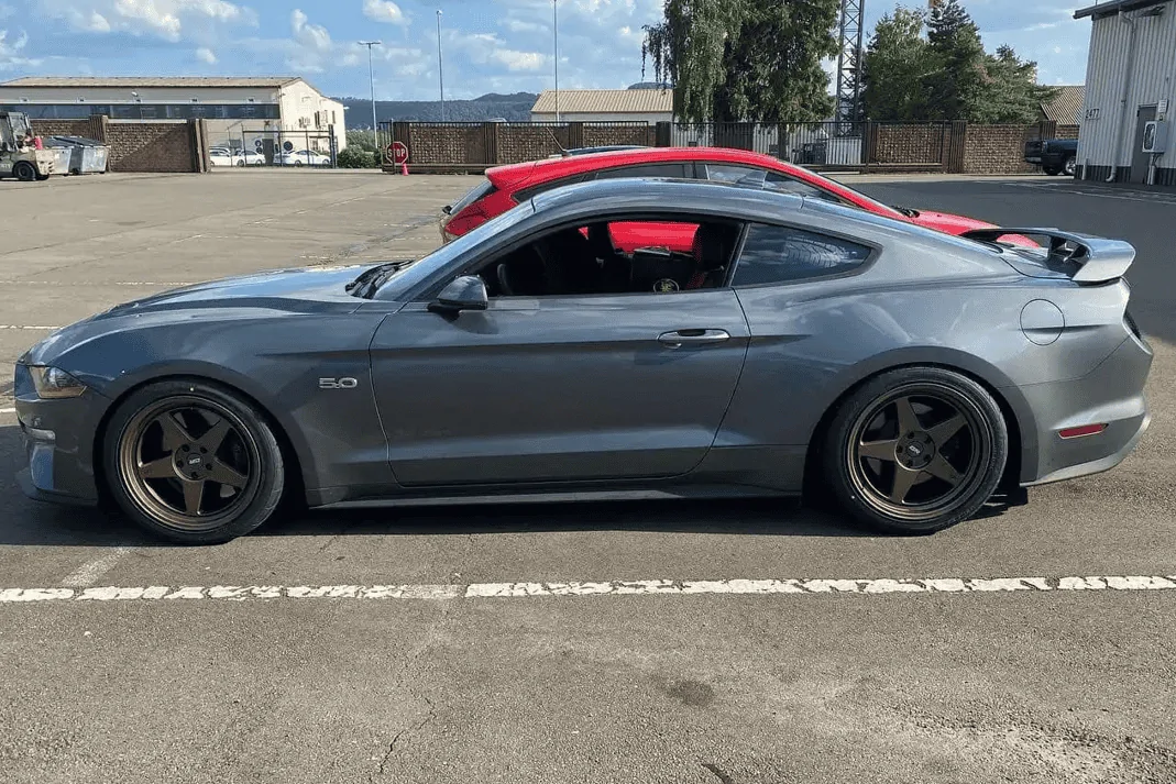

Lowered on Steeda Progressives, 19x10 285/35 square.
Side note: Check the Wheels and Tires forum, theres a stickied thread with like 500 pages of pictures. Just search the springs youre considering or the fitment specs youre considering within that post.
Side side note: I just ordered Ultralite Extremes, Caster Camber plates, and a bumpsteer kit. Figured I would run them on my pp1 dampers until they give out. Were your ultralites just extremely harsh or was something genuinely wrong with your car?
Gear is in my sig.
I personally wouldn’t go any lower than this, if you daily the car. I’m currently running stock on magneride and have already scraped my splitter a couple times.
How do you find the ride? Compared to stock? Did you change the mode you drive with after changing the springs?
Sooner or later I think I’ll go with a setup similar to yours, although it’s not the ultimate “looking” setup, I want to keep the car as my daily , and not scrape on everything.
When I'm in normal mode the ride is fine. I have new rims, tires and springs and those all contributed to changing the overall ride profile. Not bouncy at all.
If I want to change things up I flip to TRACK mode and when I send it she hunkers down and goes for it. That ride is a fair bit stiffer when rolling over crappy roads.
I rubbed once parking in my girlfriend's underground parking but that's it.

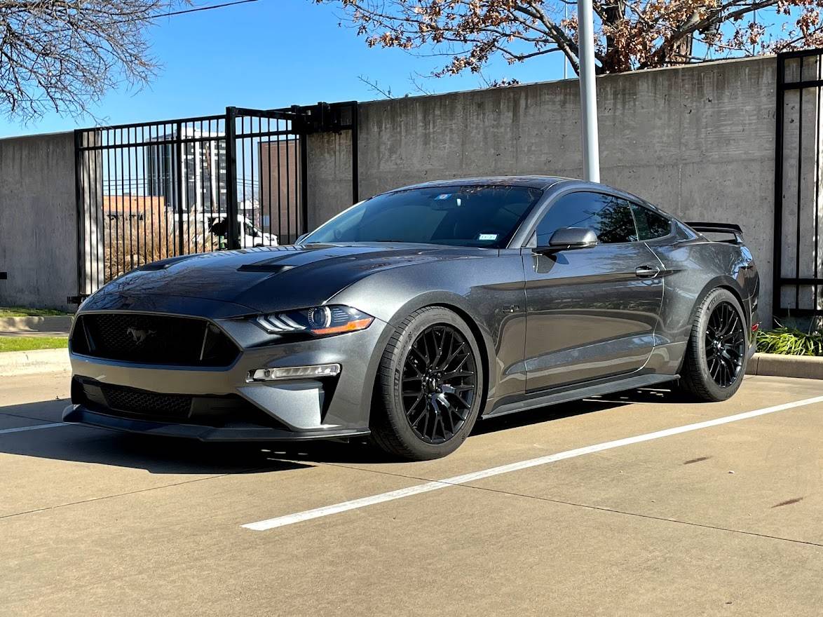

I'm running BMR drag rear springs and performance front springs on PP1 shocks/struts. The ride is stiff, but not unbearable. No rattles whatsoever, and only the occasional pop form what I believe is a swaybar endlink that needs replacing. I'm still on PP1 wheels/OE size Michelin AS3 and 1" spacers.

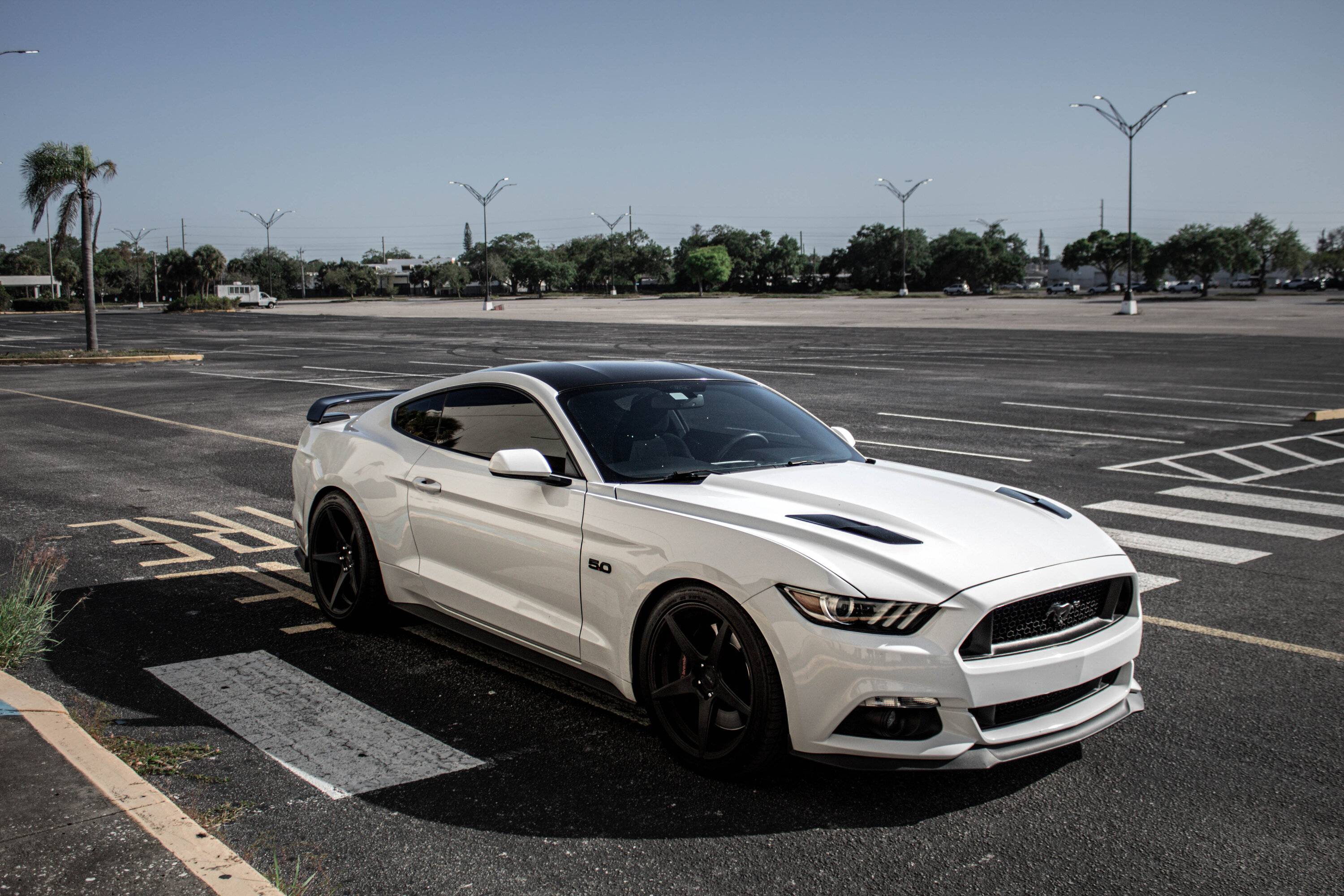

Sounds to me those shocks are blown. My stock shocks were replaced at 27k miles. I wouldn't bash on the steeda ultralite springs once they are paired with some nice shocks. I recently put on steeda ultralite springs with ford performance track shocks and the combo is amazing. For me these springs checked off all requirements (Linear spring, decent spring rate, and stance)
