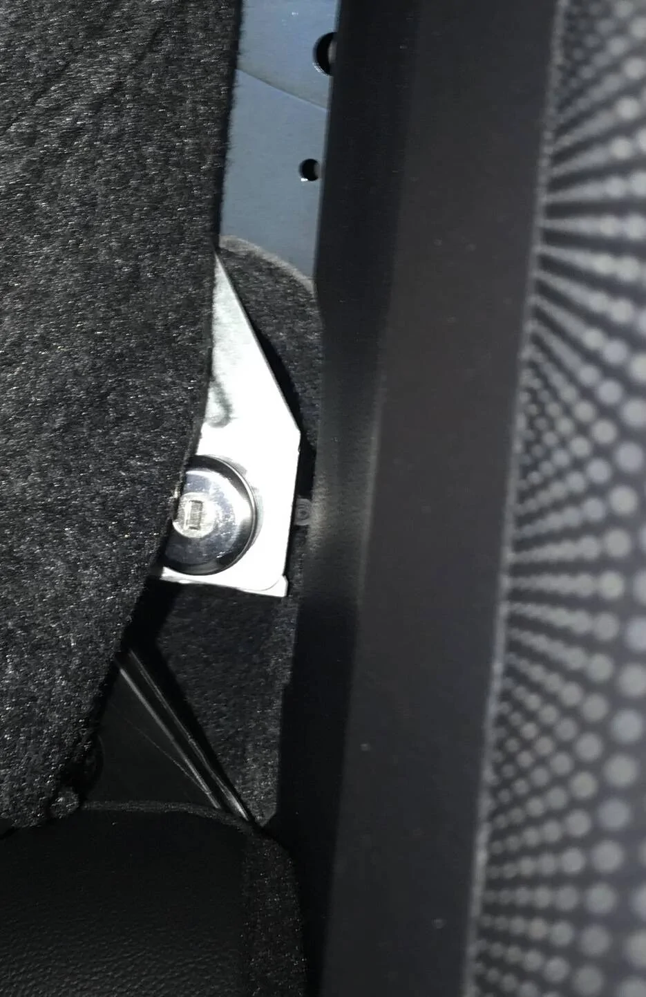

If you only had a the mechanical blade key you could use the trunk release switch next to the rear seat seat-back.

For a convertible - how to get in trunk when electronic popper won't release:
