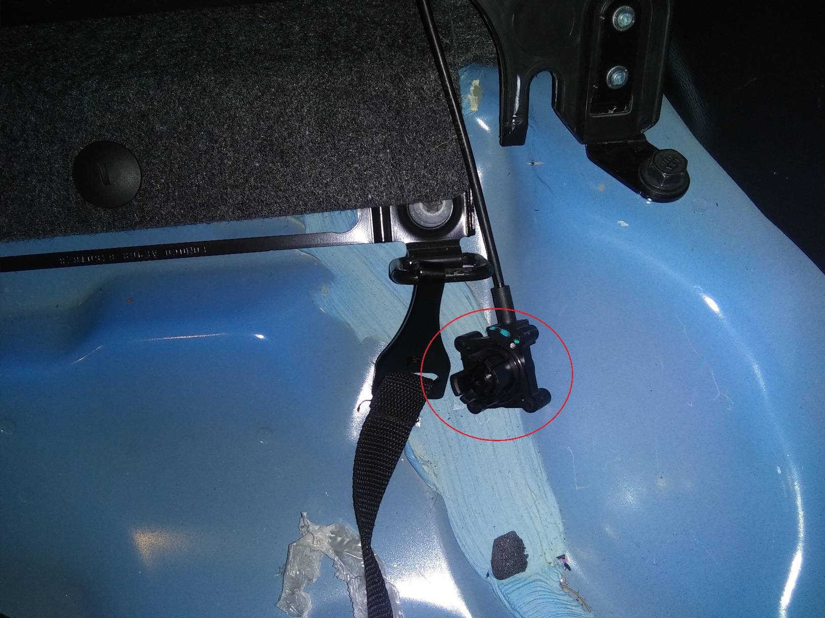

I recently had all the electrical to the trunk latch fail and the emergency key release would not turn.
I removed the seat back ( two 15mm bolts) and separated the plastic back from the emergency key release. Then I just stuck a screw driver in the slot of the back of the release and turned it to open the trunk.
FYI, the release cable is long enough that you can pull it under the seat and never worry about needing a key again.

If you only had a the mechanical blade key you could use the trunk release switch next to the rear seat seat-back.

Attached is the page from the owners manual.
