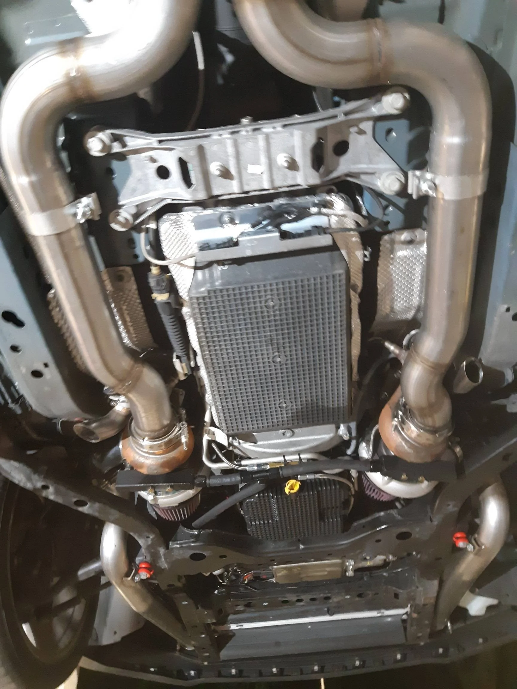

Really??? We couldnt get my trans out with out taking the turbos off the manifolds. And what it looked like to me was the turbo was completely in the way of the dip stick. I was planing on at least putting the turbo up on the manifold and double checking for room to get to the dip stick.
What version kit do you have? do you have two little oil drain backs on the turbos or one big one in the middle? We couldnt get to the bell housing bolts\ starter with the turbos still on it. im using the base ball bearing turbos (powder coated black).
I had to take off the pass side turbo and adapter to remove the trans, the drivers side stayed on.
This is the oil drain I have.
