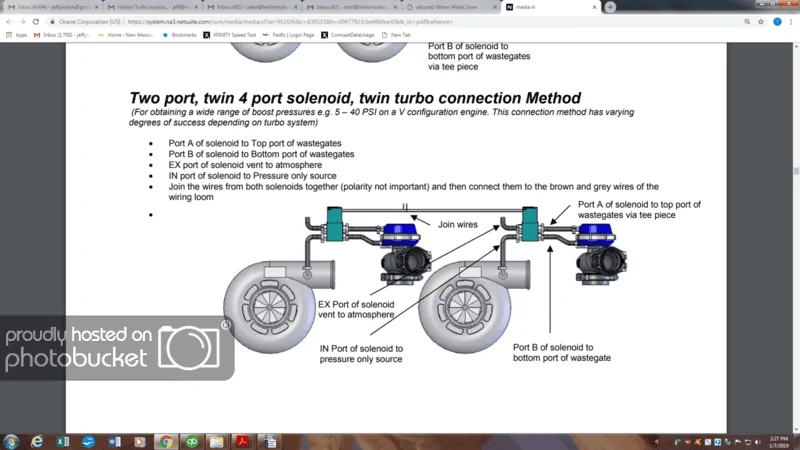

I found this diagram thought this was the right setup for what i got.

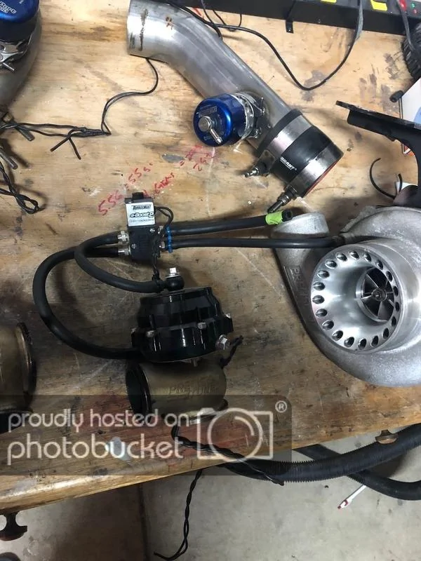

I laid it out on my work bench and i was wondering if the EX port goes into the other wastegate or to atmosphere, The green tape shows the EX port.
Where does the blue wastegate vacum line plug into? Does another vacum line go into it?
