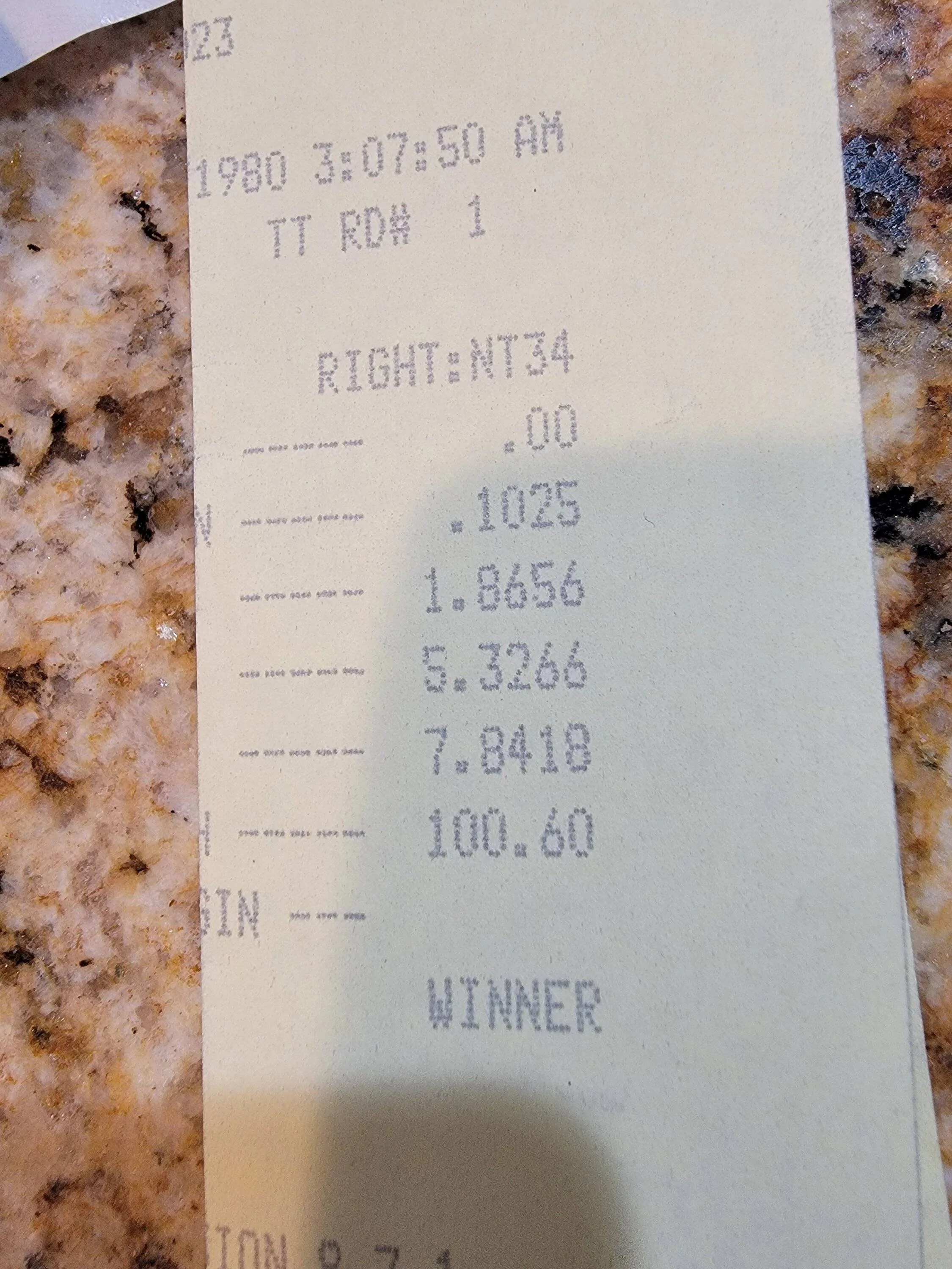

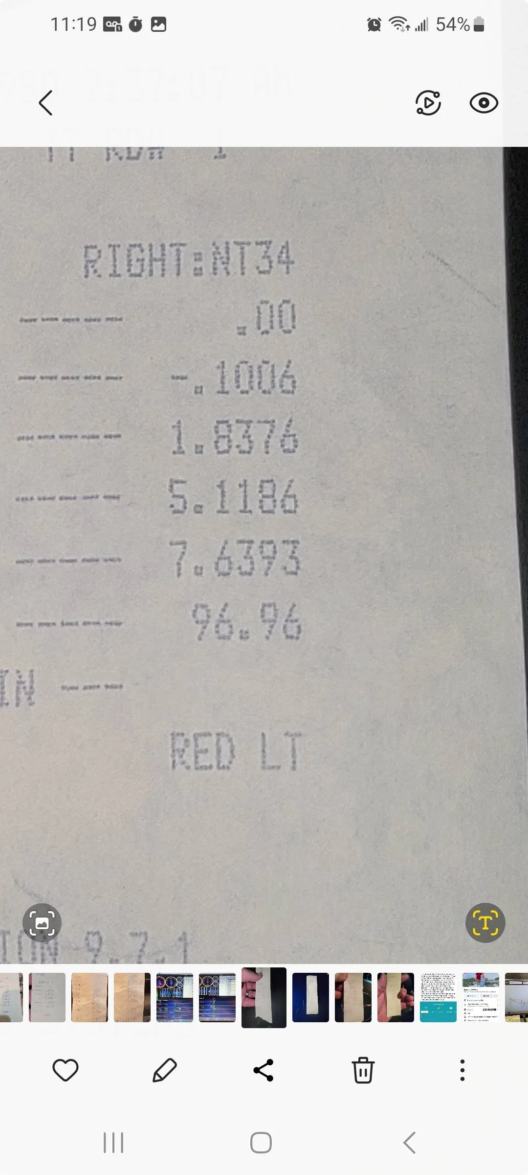

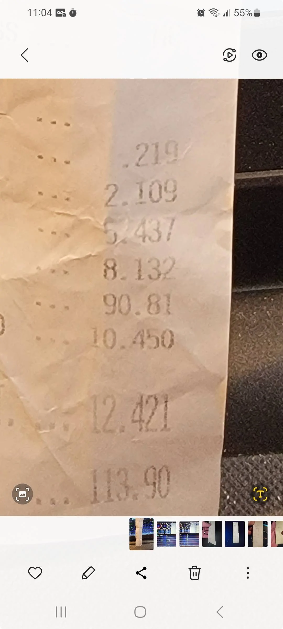

In typical Me fashion I expect good results when I am not done with the project. Then I get bummed when they don't happen. 1 day I will learn, probably not today though, LOL.
Right now it is on a 20inch Nitto DR. The car needs a better tire/suspension. My reasoning was my wife drives the car, and being in FL we get caught in the rain a lot. I did not want to go to a Mickey Thompson at first for that reason. So it seems 2 sets of wheels are in order.
Let me start by saying the car feels nuts on the street. The only WOT pulls are usually in 3rd gear and they end up in rolling burnouts.
One mistake I made is taking it to the track without the boost controller hooked up. I assume it makes 7-8 psi but that is just a guess. The other mistake is thinking my car would hook on the drag strip. It is a test and tune so prep wasn't the greatest. Plus the track has been owned by the government for awhile so putting money into the place stopped 10 years ago.
These are 2 slips from tonight and 1 from when it was stock with the NIttos. When stock it was on 93, tonight it was on E85.
Every pass tonight I had to lift when it shifted into 2nd gear. The car got out of way out of shape and I had to pedal it. Some passes I got back into it sooner than others - 5 passes total but pretty much the same result.
I know lifting and spinning effect ET a ton. However MPH is not really effected at all, sometimes it goes up as long as you don't roll through the traps.
Am I wrong thinking it should be picking up more than 10 MPH switching to E85 and boost?
Anyway that was my night.
On the 12th there is Runday Sunday at Bradenton Motorsports Park. This is right before Sick Week so the track should be on kill. My fried will be there with her GT500, it must get gapped!
I will get the boost controller done by Saturday, I am ordering VMS wheels and 17 inch MT DRs tomorrow as well, then get some more logs to PBD so they can see if any adjustments need to be made.
The quest for a single digit car my Wife can race is not over, it has just begun. Rant off!

At least you got it out there! I'd say it's hard to make much of a determination without a clean run. Do you know if you put the weaker or stiffer springs in the wastegates?
My car (2016 gen2) full weight on 8lbs of boost using the stiffer of the two wastegate springs trapped 111.79mph in the 1/8th for reference. Verify boost, get the MT et street r's, and make a clean pass. Then determine if you think the mph is low.

If your running the smaller spring your probably sitting around 6lbs and if you used the larger ones it should be 7.5/8lbs. At least that's what I saw on spring pressure. @wazslow mph are much more normal for an auto with twins from what I've seen so I'd say with better runs you should hit that ballpark. For reference I was trapping about the same as you on the larger springs and pump gas with an mt82 so I'm sure once you get it dialed in better you’ll get there. That damn A10 is no joke.
