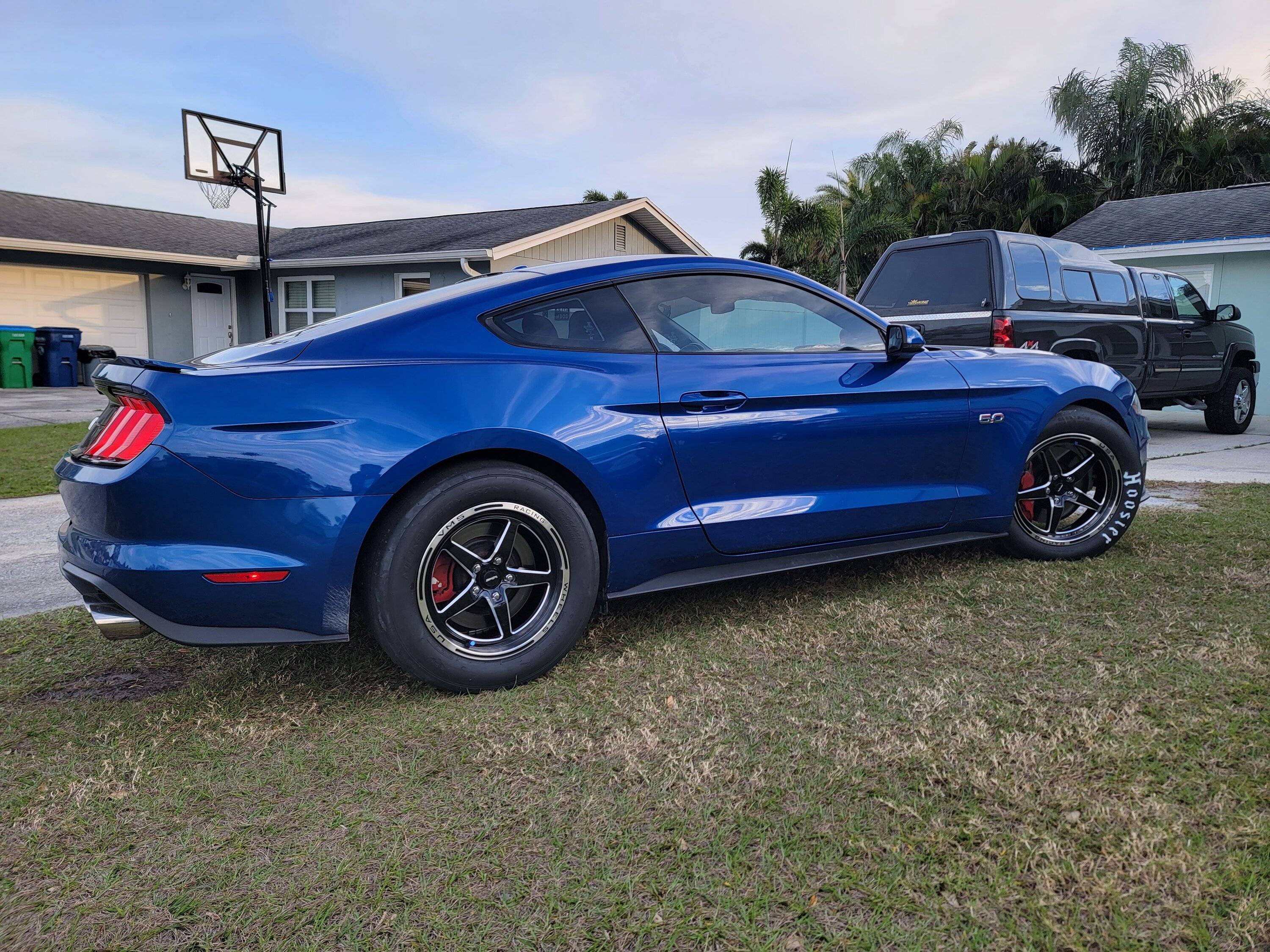

All cleaned up and ready to go! Thanks for everyone's help!
wazslow
Oct 10, 2014
633
548
PA
2016 Mustang GT/CS
Looks good. Get ready for a fun 145+mph ride!
