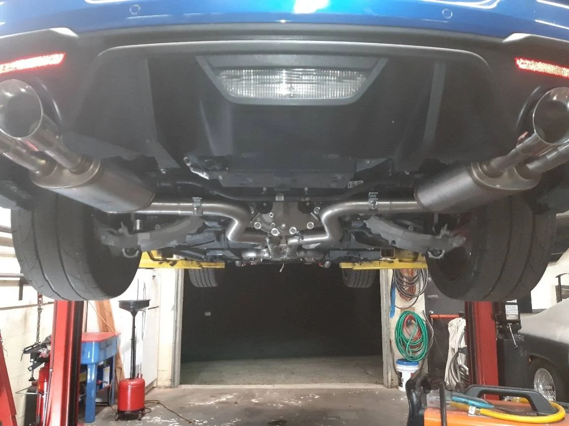

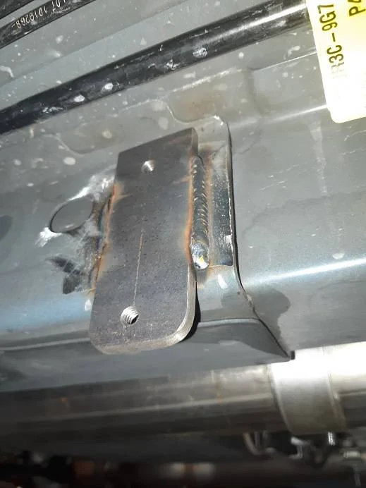

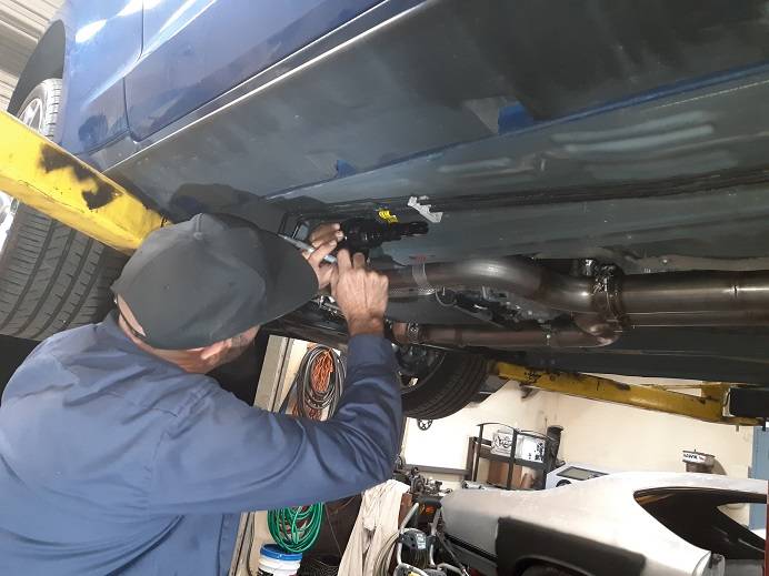

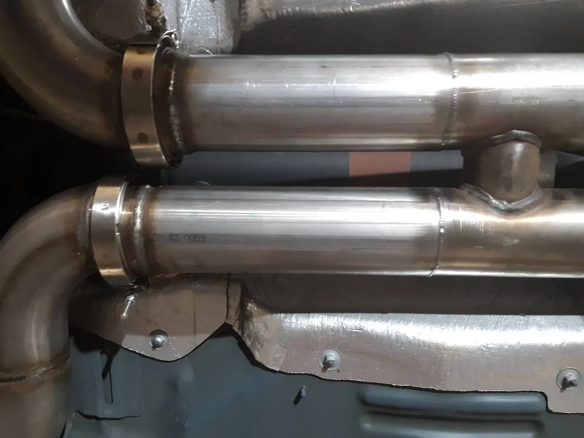

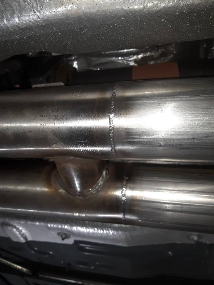

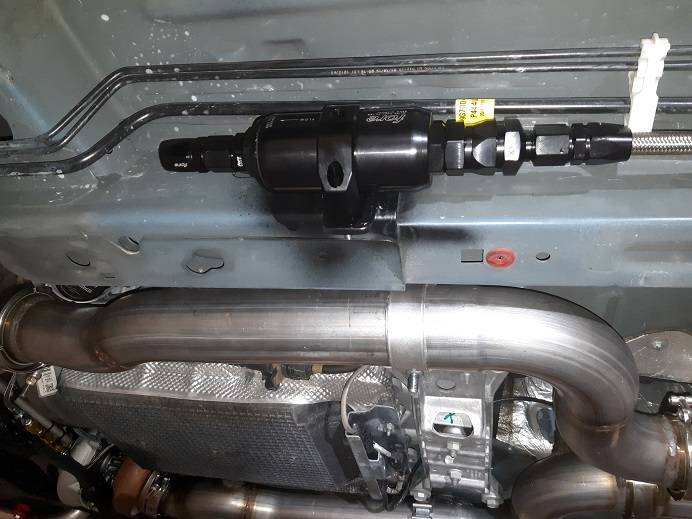

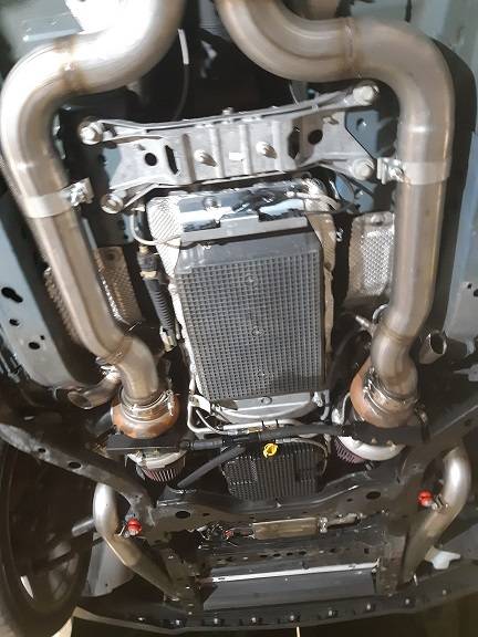

Photo dump time. I have the fuel system and exhaust all done. Special thanks to my buddy Tom @ Soul Doubt customs for the welding and letting me use his shop while he is away on vacation.
I made the mistake of being cute (hard to imagine I know) for Christmas. I wrapped up the HP Tuner device so my wife could open it for a gift. I didn't think that Palm Beach Dyno would be closed from Xmas to New Years. OOPS. Car will hopefully be able to start in a few days.

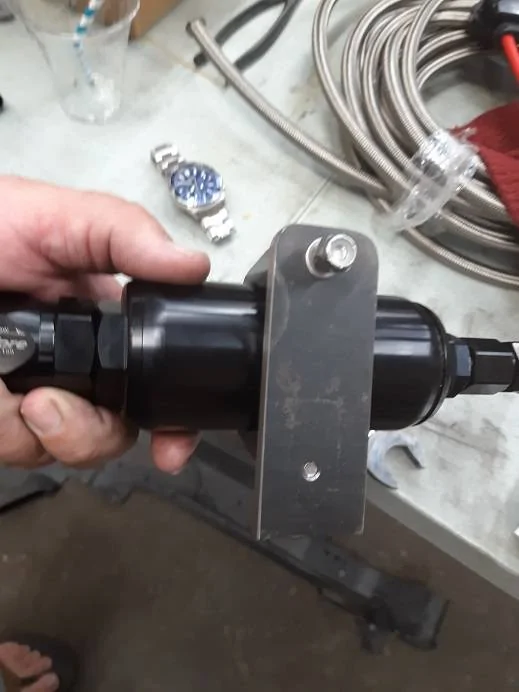

Hopefully all I have left is to figure out my boost reference source for the Eboost 2 and FPR. Then install the Eboost 2.
It is taking a lot longer than I thought but my time working on it is sporadic at best.

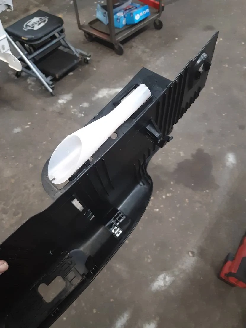

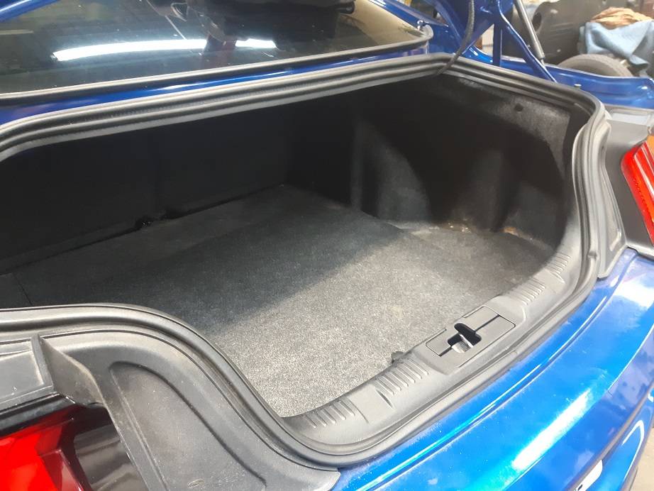

I found there is a funnel under the trunk liners. Dumb.
Rear shot of the 3 inch MRBP exhaust. Can't wait to hear it under full song

You'll need that funnel if you ever want/need to add fuel from a fuel jug. I use it at home when adding E85 to my car.

Well don’t I feel dumb I never knew that funnel was there either even after owning the car for a year and a half. Had to make my own to use when I occasionally have to use e85 from a gas can.

Under full throttle your going to be listening to the wastegates under your feet, not the exhaust. Like a mini open header. Lol.
I have been looking for the exhaust note for whenever the WG's are closed. I find the car being loud AF at wide open is such a "pro" for the low mount turbo kits that vent to atmosphere. I like tame around town and screaming at WOT.

I will see how it sounds. My only other turbo charged mustang was my Cartech Fox back in the late 90s. That waste gate went back into the down pipe.
It does seem like a difficult task routing them back in with a flex joint.
Exactly. My setup is perfect for me. I have the xforce varex 3" all the way through with mid-muffler. It's slightly rumbly with the muffler valves open and how I run it 99% of the time. But if you want stealth, close the valves and it's factory quiet. Good for early or late night in the neighborhood.
