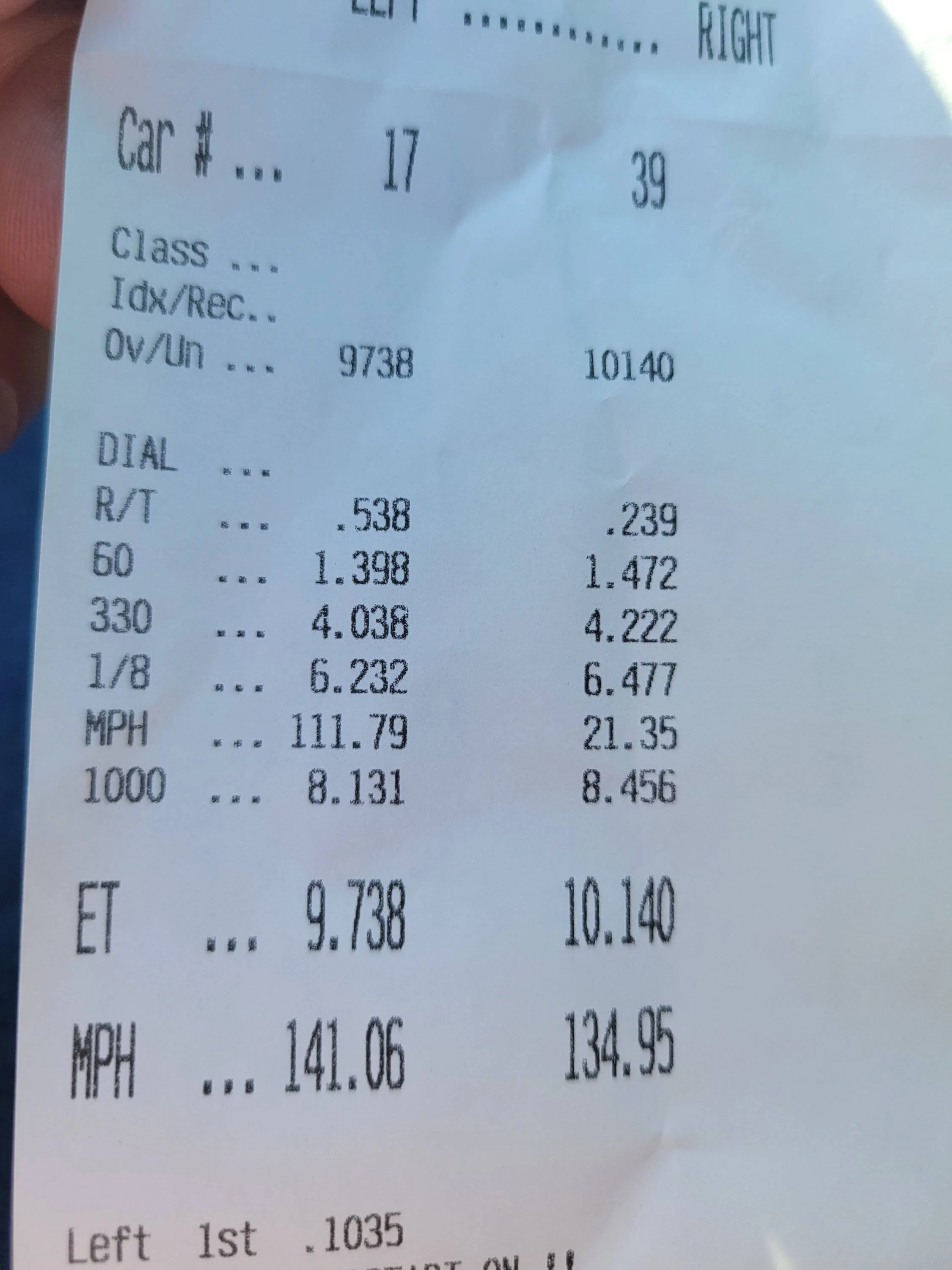

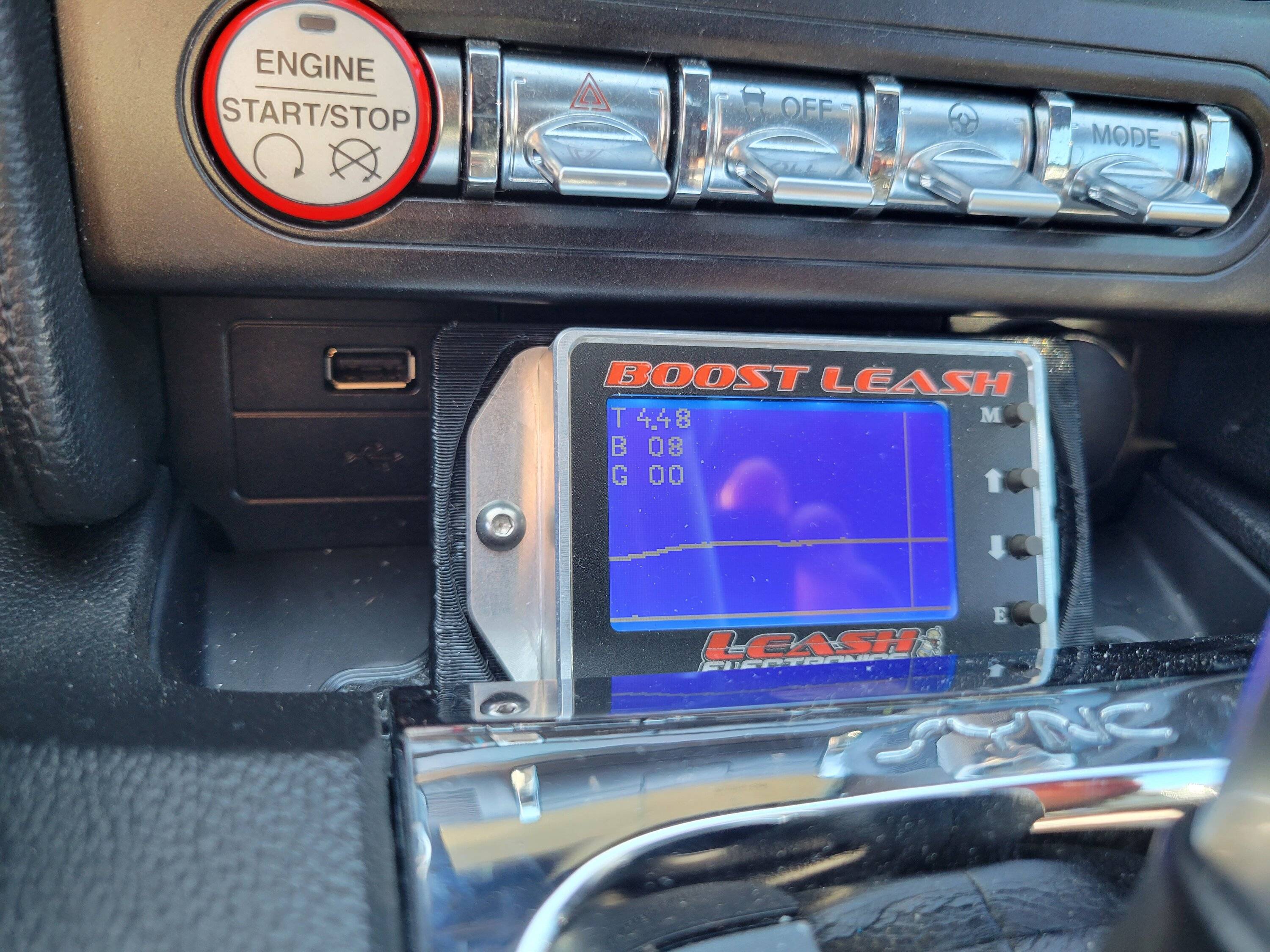

My car went 1.39 60' and 9.73 @ 141 on the wastegate springs(8 psi). Boostleash screen below showing 0 on the gate and 8 psi, 4.48 into the run. You can knock off a lot more than 2 tenths from that 60'.

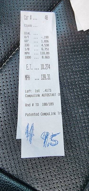

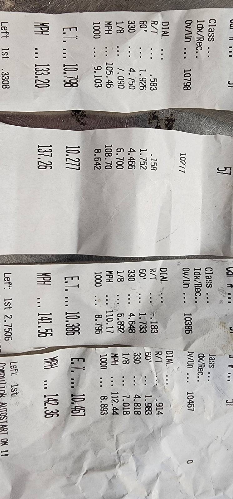

Looking for some input from people to try and get my wife into the 9s. The MPH is there but it seems the car falls on it face shifting into second as you can see from the video from the stands.
Would tuning the trans for 2nd gear starts help this? Transbrake tune and 2 step?The transmission is still under warrantsofrom Ford so trying not to change the converter at this time. Boost was between 9.5-11.7 for the time slips shown.
I am dumb and did not bring my laptop cord to catalog the passes. Big mistake.
It was a fun day and the first time I raced against my wife. I had her at the 1/8 but she has 20MPH more than I did on that pass.

Time slips. The one with the 2 second 60 foot was her learning to power brake at the launch. She broke the beam and didn't know it
