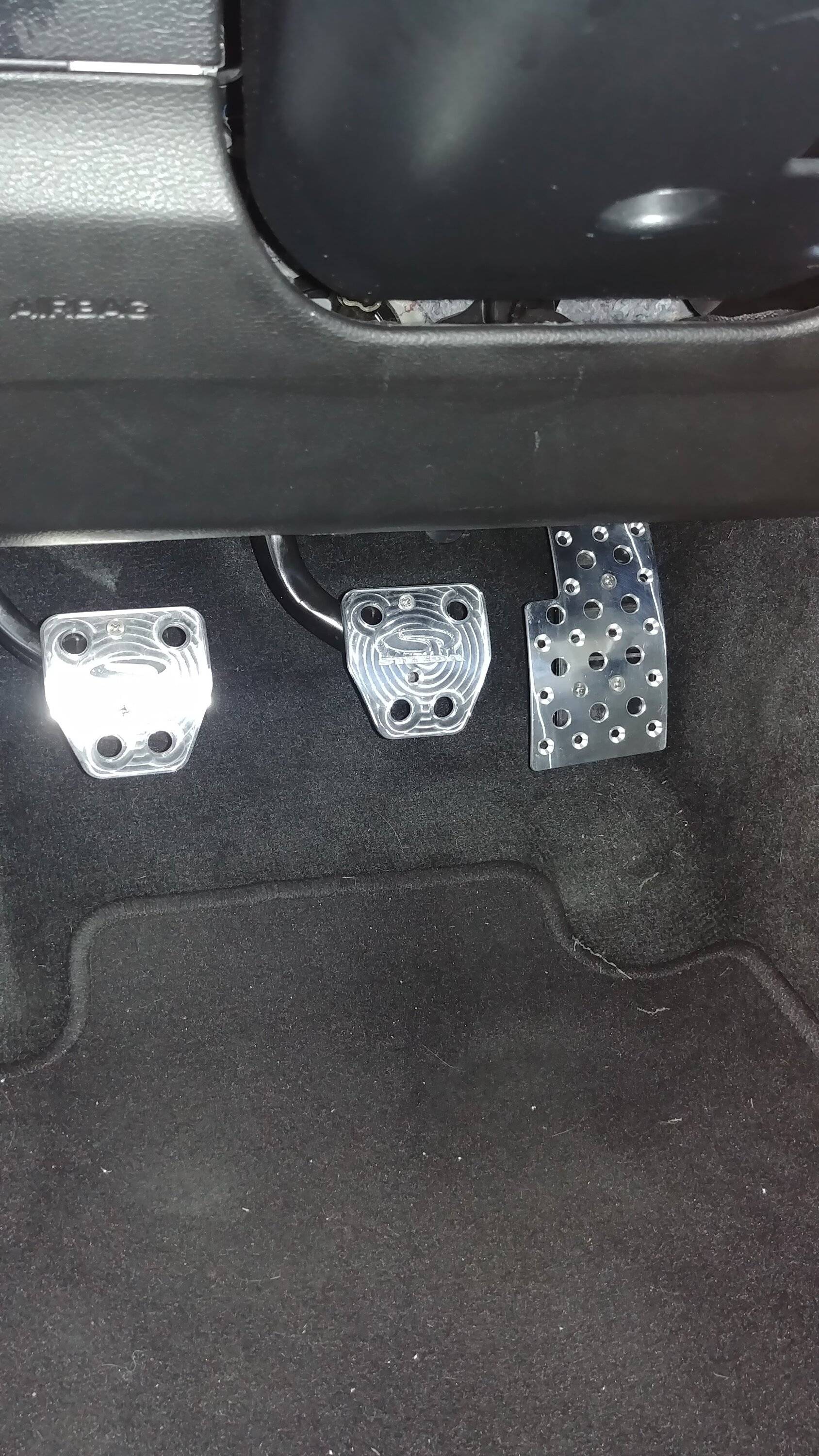

I have the Steeda ones, didn't notice a change in height and it took a little bit to not hit the gas when braking, overall review is a thumbs up from me.
I'm in Florida so that means I live in sandals / slides when not in professional attire. No issue while wearing and often I will slip them off and drive barefoot too.
FYI, those are not scratches on the gas pedal, they came with a clear protective film over them and I took the pic before removing.
