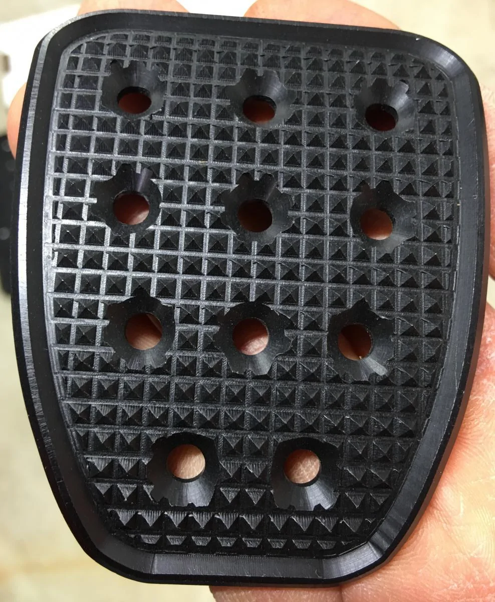

SRP pedals
Hey Voodoo,
Did you use just 1 screw to hold on these pedals???
I have the same set and the radius is off a bit. Not a problem with an upper and lower bolt to secure. I'm using 4 screws per pedal for brake and clutch.

Hey Voodoo,
Yes I used one 10-32 screw to hold the SRP pedals on. I drilled and tapped the Ford pedals arms to hold the SRP brake and clutch covers on. I re-arched the clutch and brake pedal covers because as you said the SRP radius was off. I used two pieces of 3/8" thick rubber and used them to sandwiched the SRP clutch and brake pedals then put them into my hydraulic press into a steel "U" that was slightly more radius then the ford clutch and brake pedals. Using the one single screw "flattens" the SRP cover tight to the ford pedal arm and locks them into place and they do not move at all.

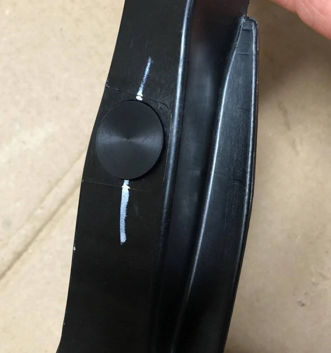

On the gas pedal I made a button from delrin that I drilled and tapped that fits into the gas pedal recess then also drilled and tapped A second hole to hold the SRP pedal cover in place.
You can see the button above.
