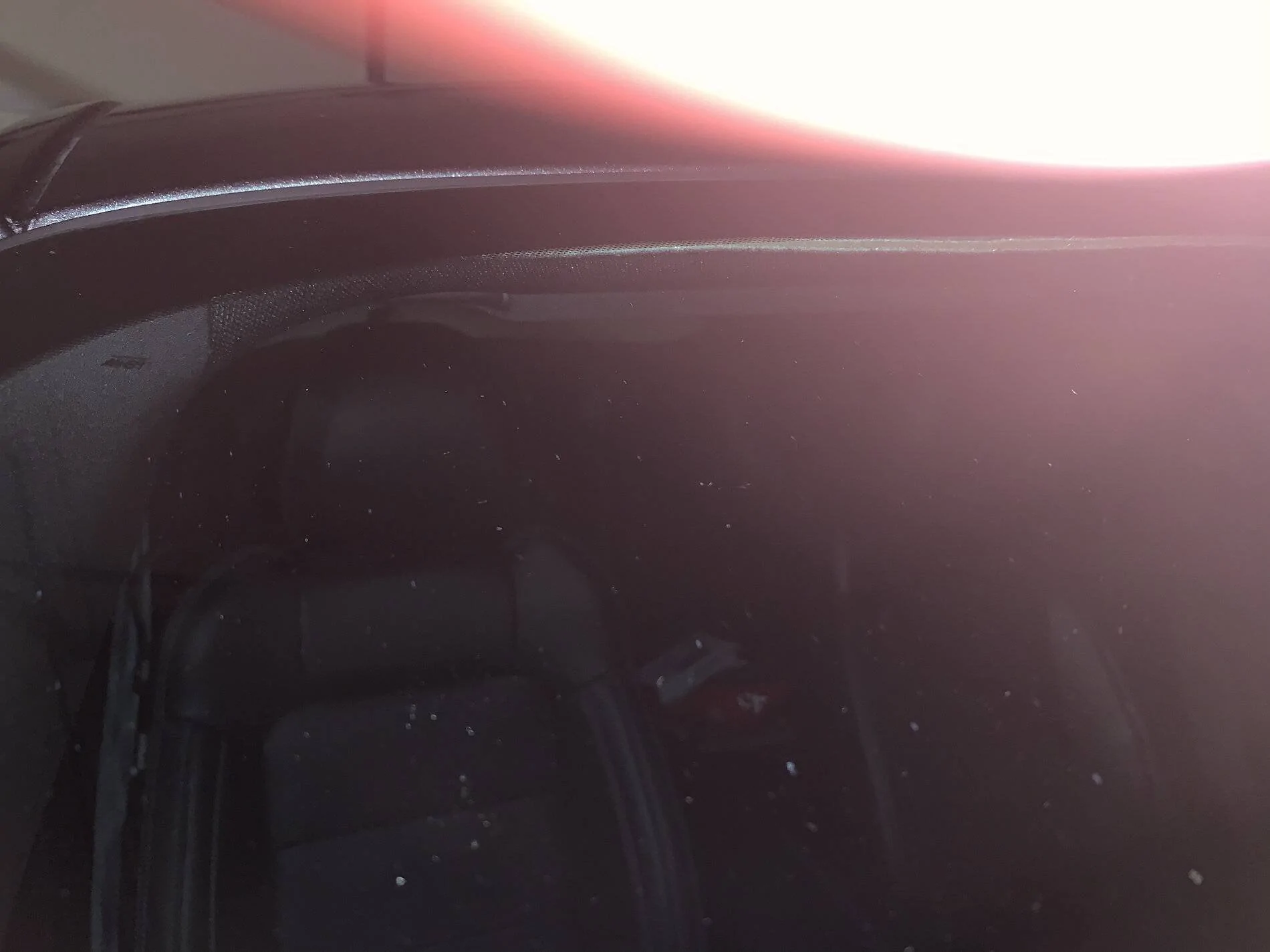

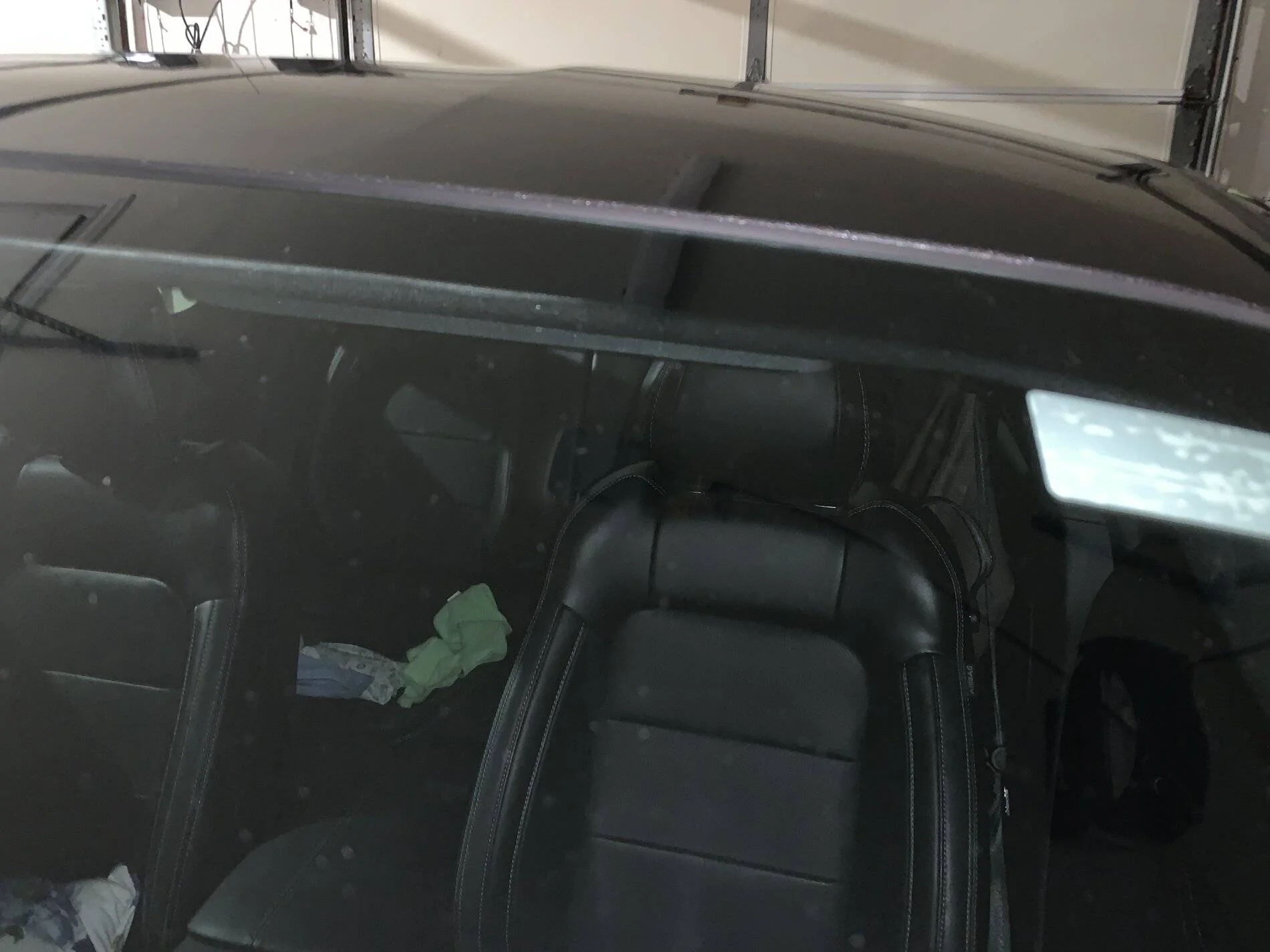

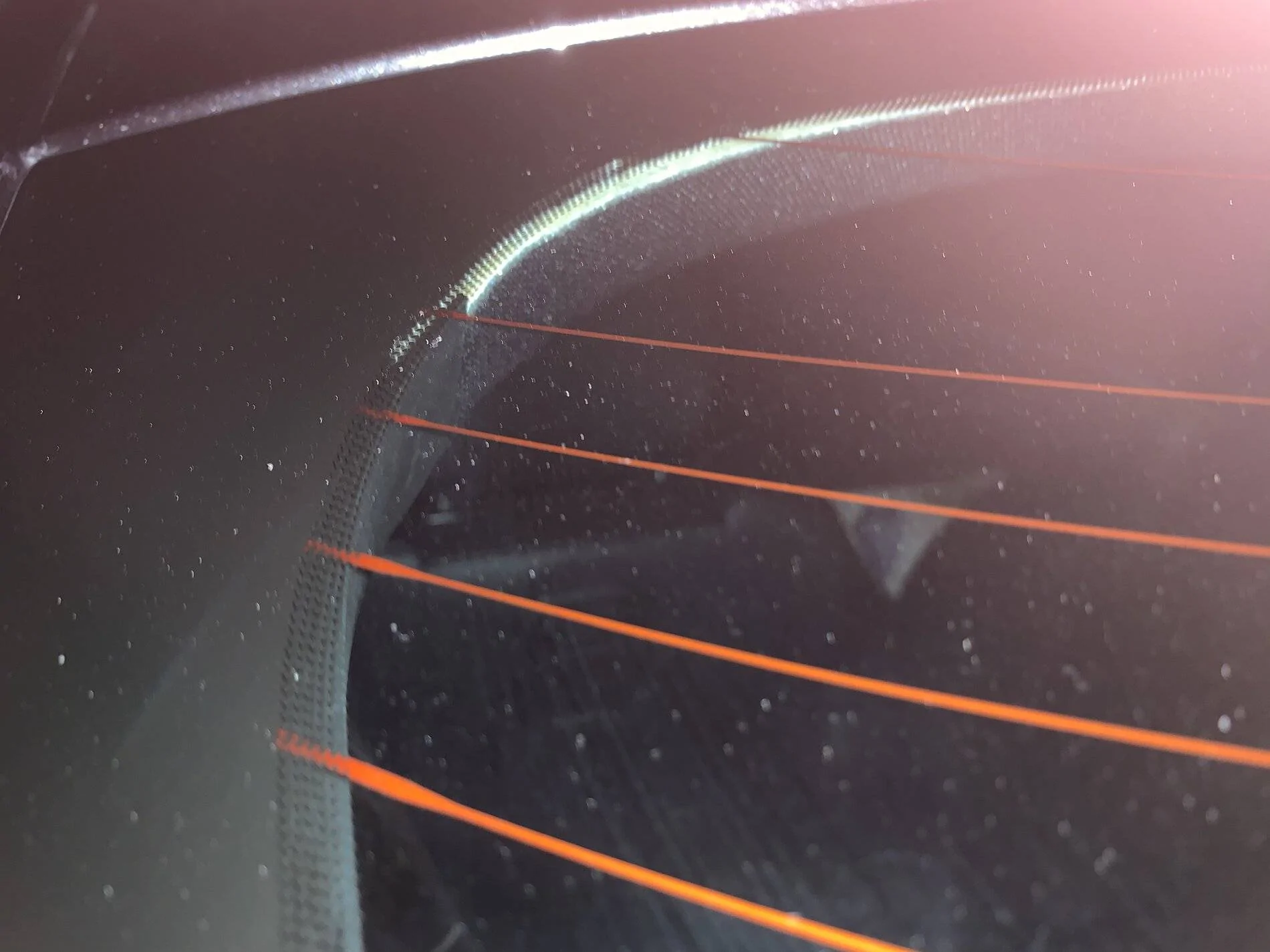

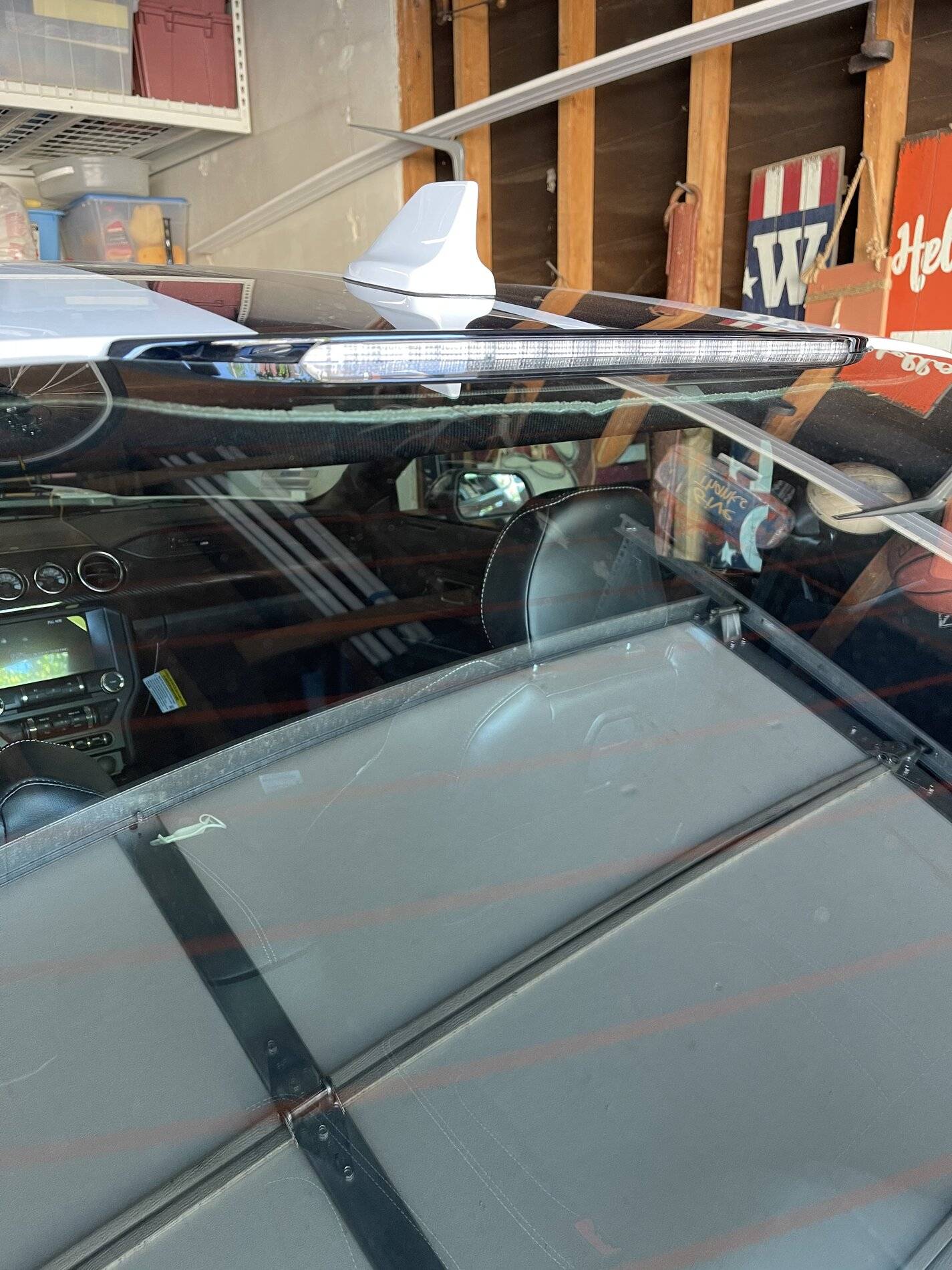

I added a couple of pictures
very hard to see in photos because glass angle
but you can see edge of liner in front hangs down about 1/2” to 3/4”+
the rear is typ both upper corners- you can see edge of liner

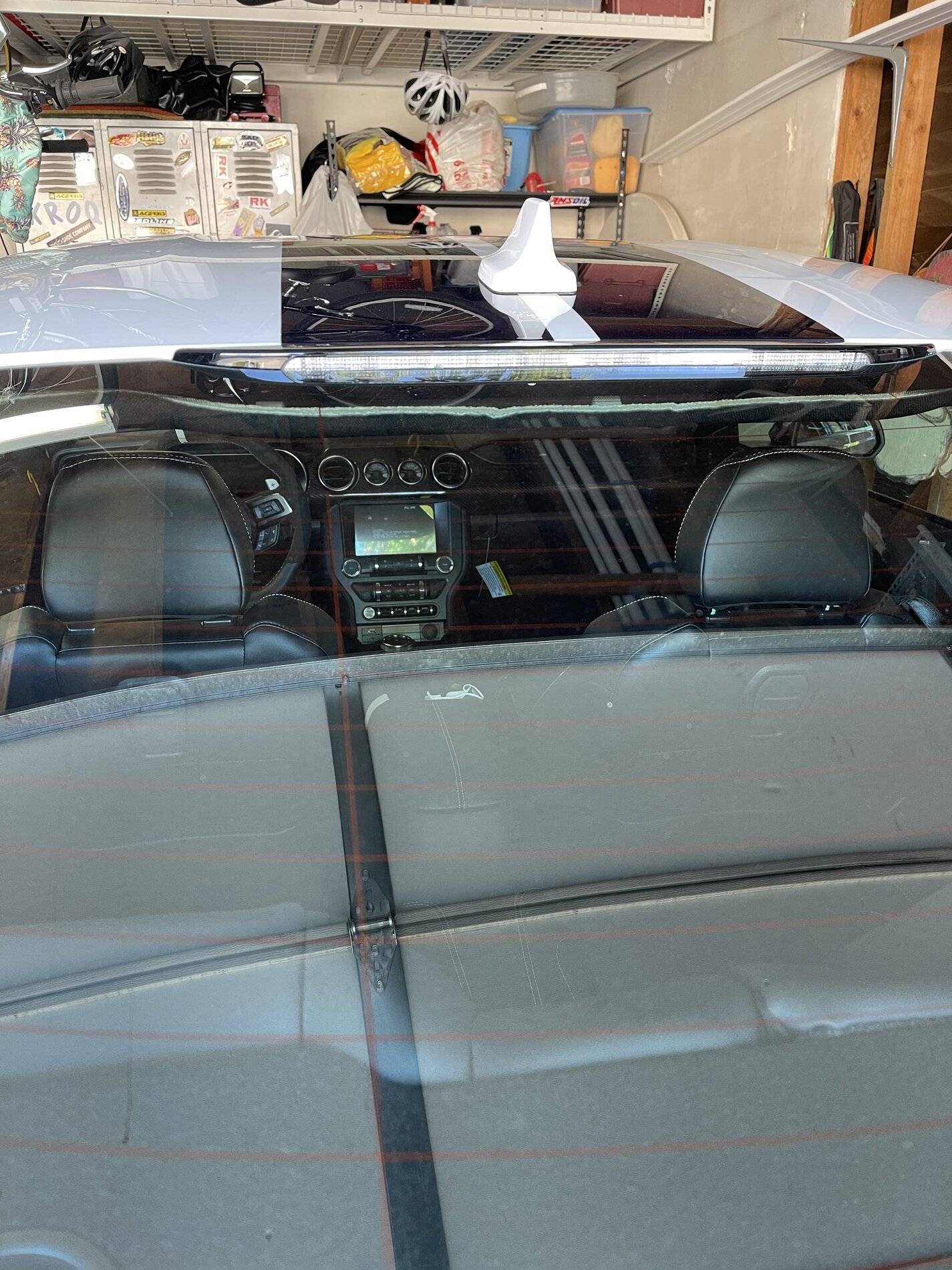

2020 GT350R and I just noticed this issue at the back end of the headliner where it meets the rear window. It's dropping down on both sides. Will call dealership tomorrow.
