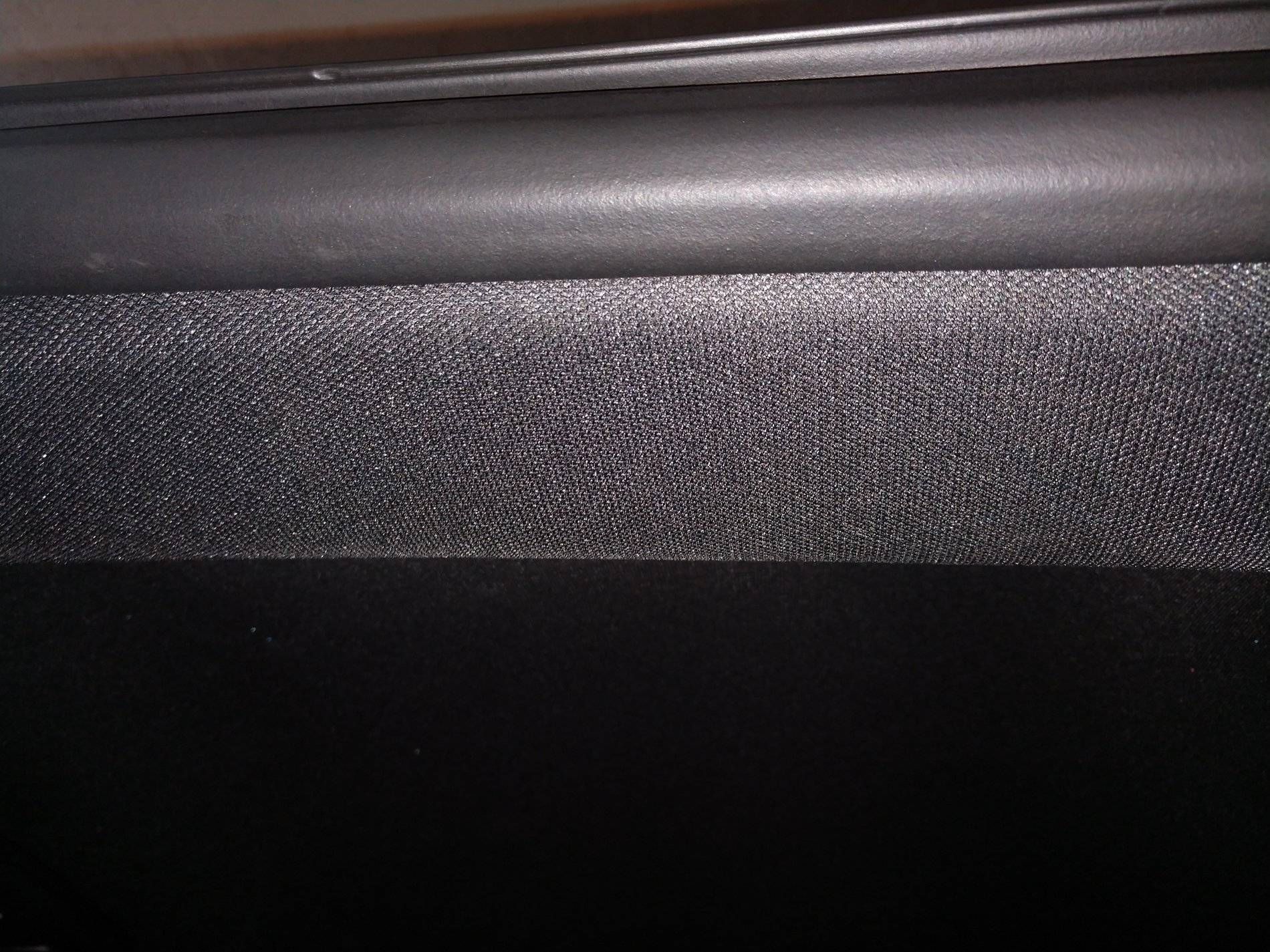

Anyone else notice the edge of the headliner being visible when driver/passenger doors are open? I’ve tucked both sides behind the door gasket and they just keep pooping out.

No, the head liner should tuck into the weather strip inside the cabin. Get a panel tool and run in the weather strip gap and shoe horn it into place.

I’ve tucked it in. Just keeps popping back out. Anyone have positive results from a dealer replacing a headliner? Like a lot of people on here... kinda scared to take it in :frown:.

Proper headliner fix procedure:
From exterior use your hand or a small rubber mallet and you want to press (or lightly tap) the entire seal from the bottom of the A-pillar encompassing the entire perimeter of the seal all the way to the B-pillar. As you are pressing the seal, you should feel it move about 1/8” and grab or snap onto the metal edge of the body.
Then after pressing the seal from the exterior, on the interior side use the edge of a credit card and starting at very bottom of A-pillar (at dashboard), slide the credit card between the seal and the headliner. As you are sliding the card, simultaneously grip and press the weather seal towards you from the outside so the headliner is being tucked under it, do this all the way to the B-pillar. This will ensure that the seal is completely pressed against the body, is firmly over the edge of the headliner and headliner is tucked properly. Do that on both sides of the vehicle and it should eliminate the problem.
If that does not work, then take it to your local Dealership - it may be that the seals are defective by being malformed from the manufacturing mold and you or the Dealership won’t be able correct the issue regardless of what is tried.
My prior 2016 S550 had to have the complete driver side weather seal replaced because it was defective. It was doing what you’re experiencing but not as bad, meaning the edge of the headliner was not visible. The problematic area was the top corner where the back top edge of the window would seal against it at the roof line. That corner kept folding into itself. My Dealership took pics to send to Ford and the warranty claim was approved and entire seal was replaced.

Thanks for the tip. I’ll give it a go.

No go. Looks like I’ll have to leave to the dealer to figure out.
