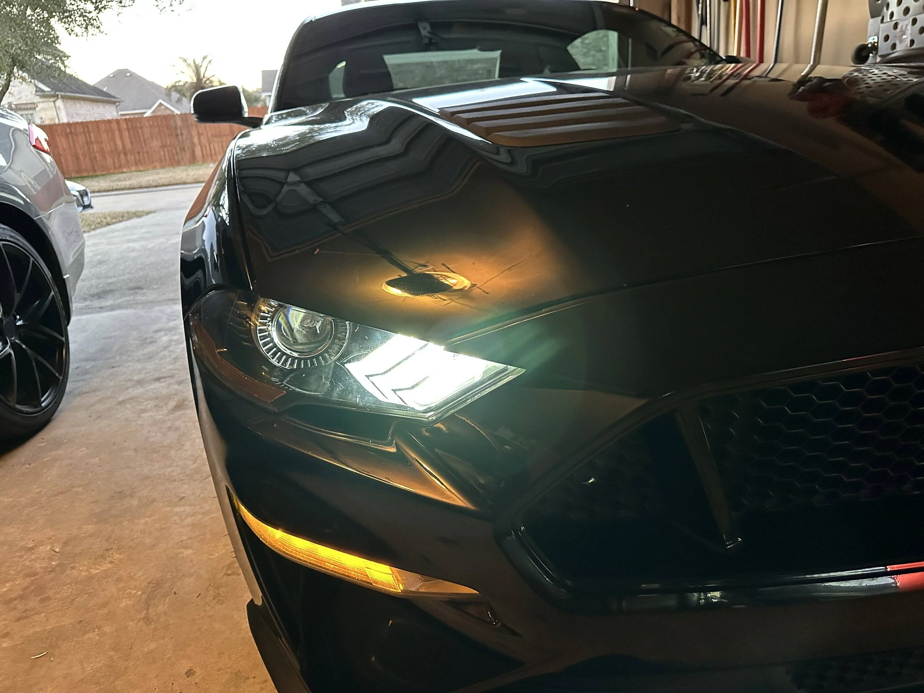

Can I change the bulb or does the whole light assembly need to be changed. The car is a 2019 Mustang GT Premium.

Maybe a little more information? Are the headlights on?

Yes, they are on. Part of the light comes on but the circular light does not come on, just on the passenger side. Hi beam will not come on either. Dealer said I need the whole light assembly which they quoted $2,000.

Bad news, it is a whole assembly. But, check the fuse and check power at the harness first. Usually, each headlight has it's own fuse. And, it would suck to buy a $2K headlight just to find a corroded ground.

Before you buy a headlight I would make sure the car does not have any stored codes…. and along with that:
- check the wiring from the headlight assembly to any intermediate harness (this doesn’t just mean visual, if the harness has black conduit, peel back to expose the wiring). Rodents are known to chew through modern day vehicle wiring harnesses in engine bays and under the vehicle. Along with wiring issues, check to make sure the harness to the assembly is not lose or there is not any water logged connectors. Make sure all ground points are secure.
- make sure it’s not a bad BCM that may be integrated with the headlight circuit. Because if you throw out $300+/- for a headlight assembly and there’s a bad BCM or there is an issue with wiring, you just spent $$$ on a headlight assembly for nothing.

this makes a lot of sense. Thanks. When I took it to the dealer, they swapped out the light assembly and the new one did not work. They referred me to their electrical guys but they were backed up 5 days. It’s weird to me how only one side of the passenger light comes on.

Look at the wiring diagram, you'd be surprised how different things look when you're looking at a schematic thinking about faults. They likely have separate supply sources and grounds.
