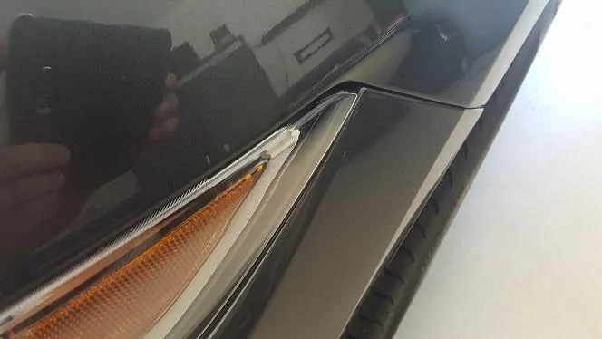

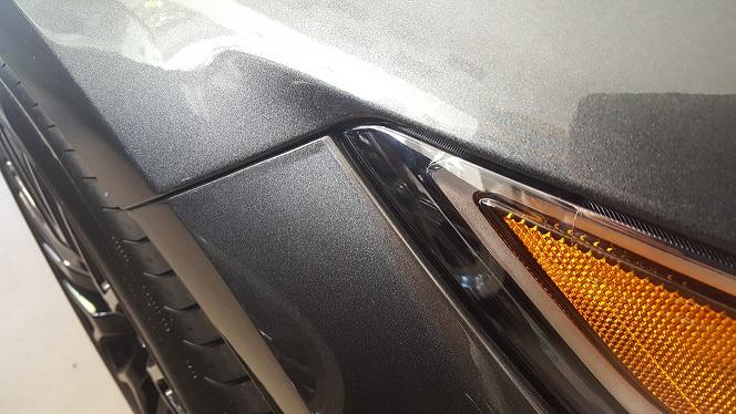

So I was completing my first full detail this morning and noticed a headlight fitment issue on the left headlight. The light does not fit flush inside the front bumper and hood. The right side appears to be fine. Is there a way to adjust this or is this a body panel fitment issue? This is really bothering me and should not be present on a brand new vehicle.. Here take a look.
Bad Fit

Good Fit

Show that issue to your dealership. They might be able to refit it flush. The bumper will have to be removed, though to get to it for adjustment.

Mine had that to. There is one single bolt on top of each light. Loosen this up, position headlight slightly in or out as much as possible then re tighten bolt.
Will not be perfect but better than before.

I know this is an old thread but I figured I should pass this along...
After finding this same problem with my driver side light, and reading this thread, I loosened that bolt, which didn't give me enough wiggle room to adjust the position further toward the center of the car. So, I completely removed the bolt and used my utility knife with a fresh razor blade to open up the bolt hole on the RIGHT side of the hole (if facing the car). I also opened up the right side of the hole surrounding a small tab to the left of that bolt. And then I took some material off of the left side of the entire headlight bracket where the bolt mounts, as well as some material to the left of that to split the difference. Then I cleaned it up a little with my dremel. All of that gave me much more slack to move the headlight further into the center to reduce the poke I had coming out near the bumper and fender. It's not perfect, but it's much much better than it was before. I'd say I got it to sit maybe a 1/4 inch further in than before. I'll get some pictures up tomorrow if that helps. Just move slow and gentle with that bracket. I'm pretty sure if you break that, it means a new headlight.
