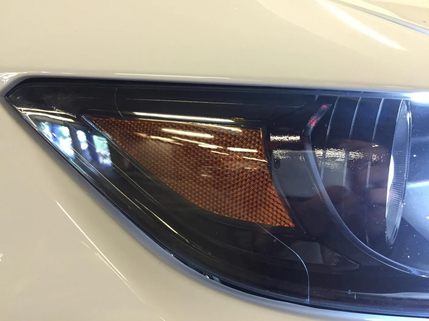

I opted to keep the Amber Sidemarkers to stay legal and it doesn't look too bad.
Can I see these installed? Considering keeping the amber. Or switching it out for red reflectors on my magnetic .

I'm going to try this out on my F-150 this weekend first. At $80 a piece for new headlights it's slightly less intimidating for a first timer.
OP did you use anything to help the paint adhere to the plastic or just spray paint?

I did basically the same thing, but opted to have the projectors and HID system upgraded at the same time. I can see for days!
