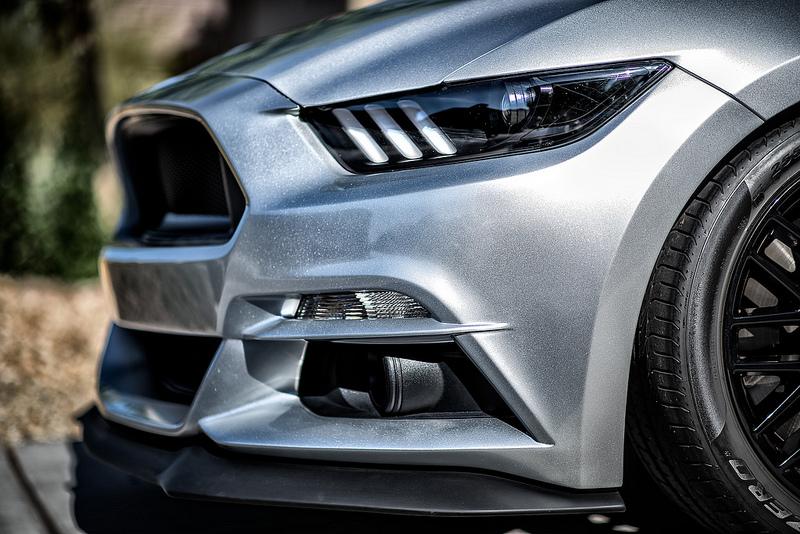

I did something similar. My gills are now my dedicated turnsignals, as I wired my signal to those, and installed 3156 (single function) amber LED bulbs in the OE signal housings. IMO having two turn signals does not look good. So, when I signal, my OE signal and fogs turn off, while the gills signal.Well since finding the code to stop the fog lights from shutting off when signaling, my goal here is:
Make the gills/fins the signal lights, make the original signal lights the DRLs, this would entail swapping the pigtails of each, so when driving the original signal lights will be the DRLs, the gills/fins would only be the signal lights and nothing else. So theoretically the gills/fins would be off all other times and wouldnt work in tandem with the signal lights now converted to DRLs.
Make any sense?
