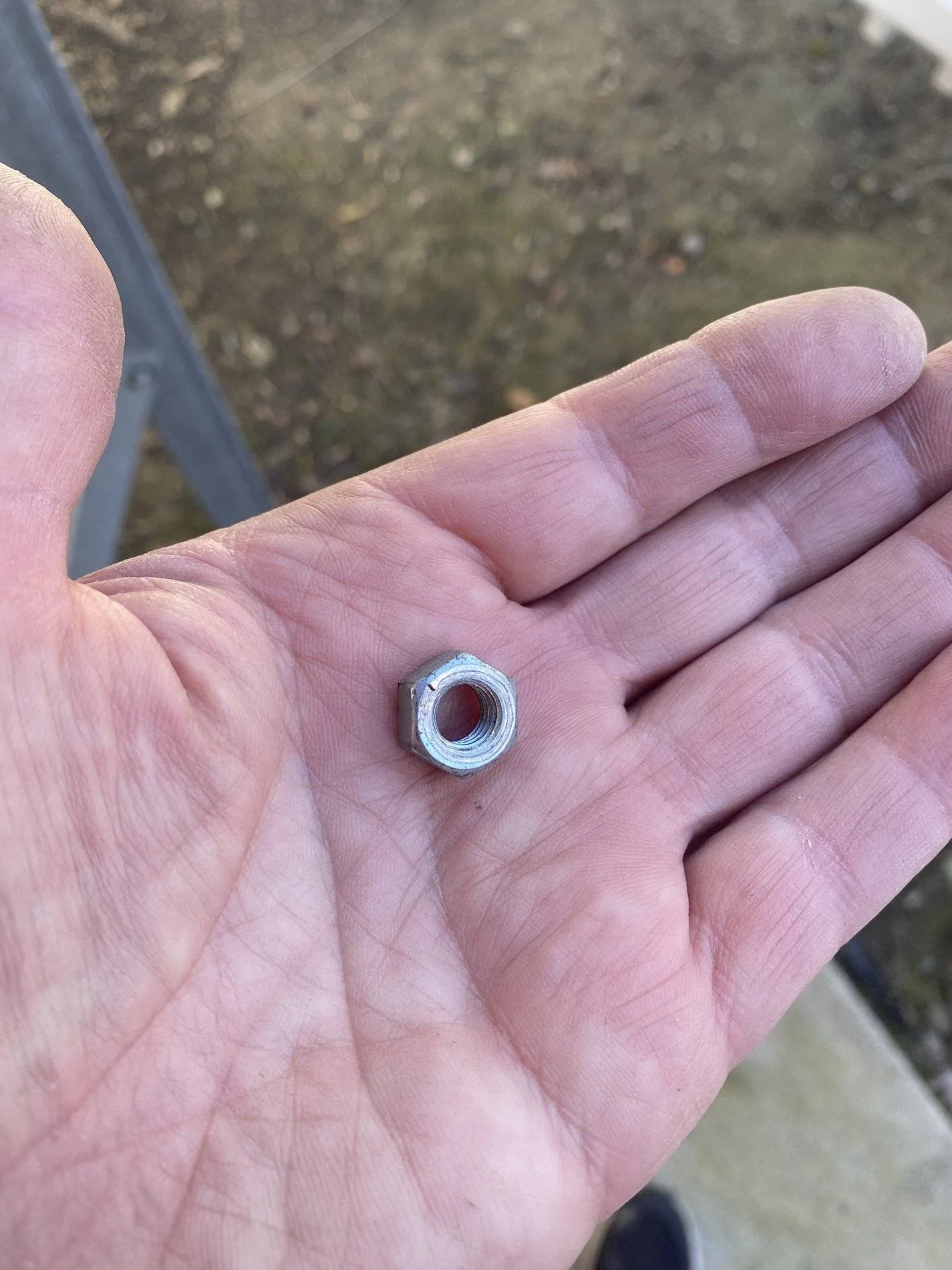

Had a friend dealing with false knock for a long time with his Roush setup that he nor I installed. He upgraded to a Whipple gen5 that I did install and during disassembly, this was in the engine valley. Needless to say, we didn’t leave it there and he’s had no false knock since the new install. No way I’d say this is a problem someone has and it was a first for me to see. A metal ping pong ball right where the knock sensors are.

Might as well hold the knock sensors in your hand while driving and shake them on a WOT pull. That’s crazy. Glad you discovered and fixed the issue!

Do you park your car over the winter? When I removed my stock intake manifold to install the 18 on it, there were nuts that some critter decided to stash in there over winter. May be something to consider especially if you park it outside.
I drive it from time to time in the winter. It's stored in the garage when not being driven. Definitely something to consider!
