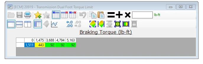

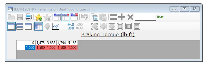

Tq management has been increased over the years. There are TONS of tq management tables in the stock tune that need to be maxed out to get the full power potential of the coyote. There is a new table from 2022 on that is called "dual foot". It limits the car's tq output to very low levels when you are trying to do a brake tq burnout. My car wouldnt barely do a brake tq burnout when it was stationary with both gas and brake on. Once we raised that table to the max, the car would blow off the tires in 1st or 2nd sitting still with the brake and gas on.
Its all in the tuning of these cars.
Stock
Maxed out
