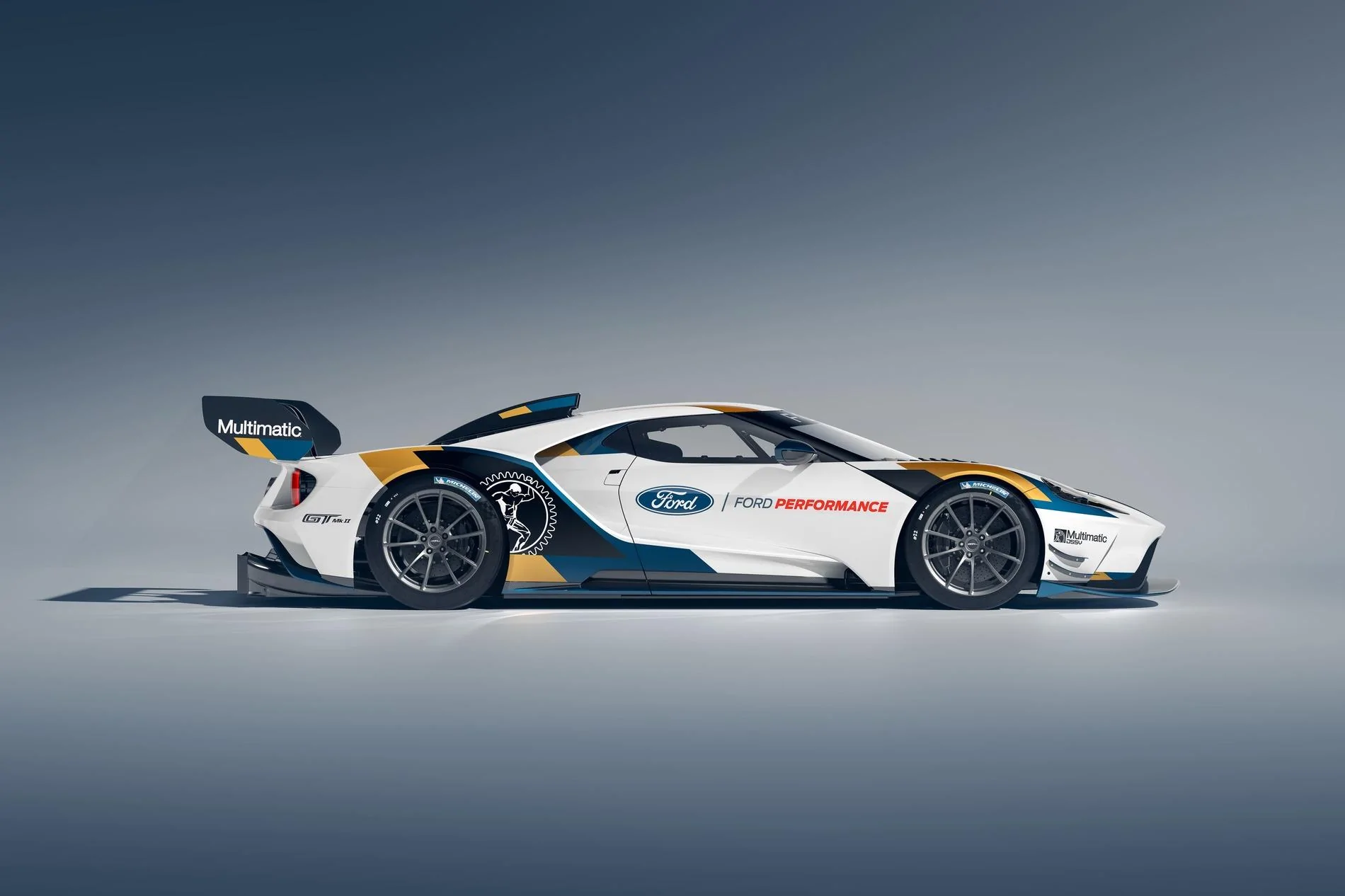

On Billy Johnson's IG someone asked why it (GT mk II) didn't have carbon wheels. He answered that the "car has slicks and Michelin does not make 20" slicks to fit on the carbon wheels"
Yet the GT350 uses the same tire on both the Carbon and Aluminum wheels.
And even it was true its just another reason you DON'T want carbon wheels for REAL track use, since they would require a bespoke tire and only that tire.
The reason the GT mk II is not on Carbon wheels is because Michelin (nor any other manufacturer that I'm aware of) makes a 20" slick. Most are 18's, and a few 19" sizes. It has nothing to do with needing a 'unique tire' for the CF rim vs. Alum wheel.

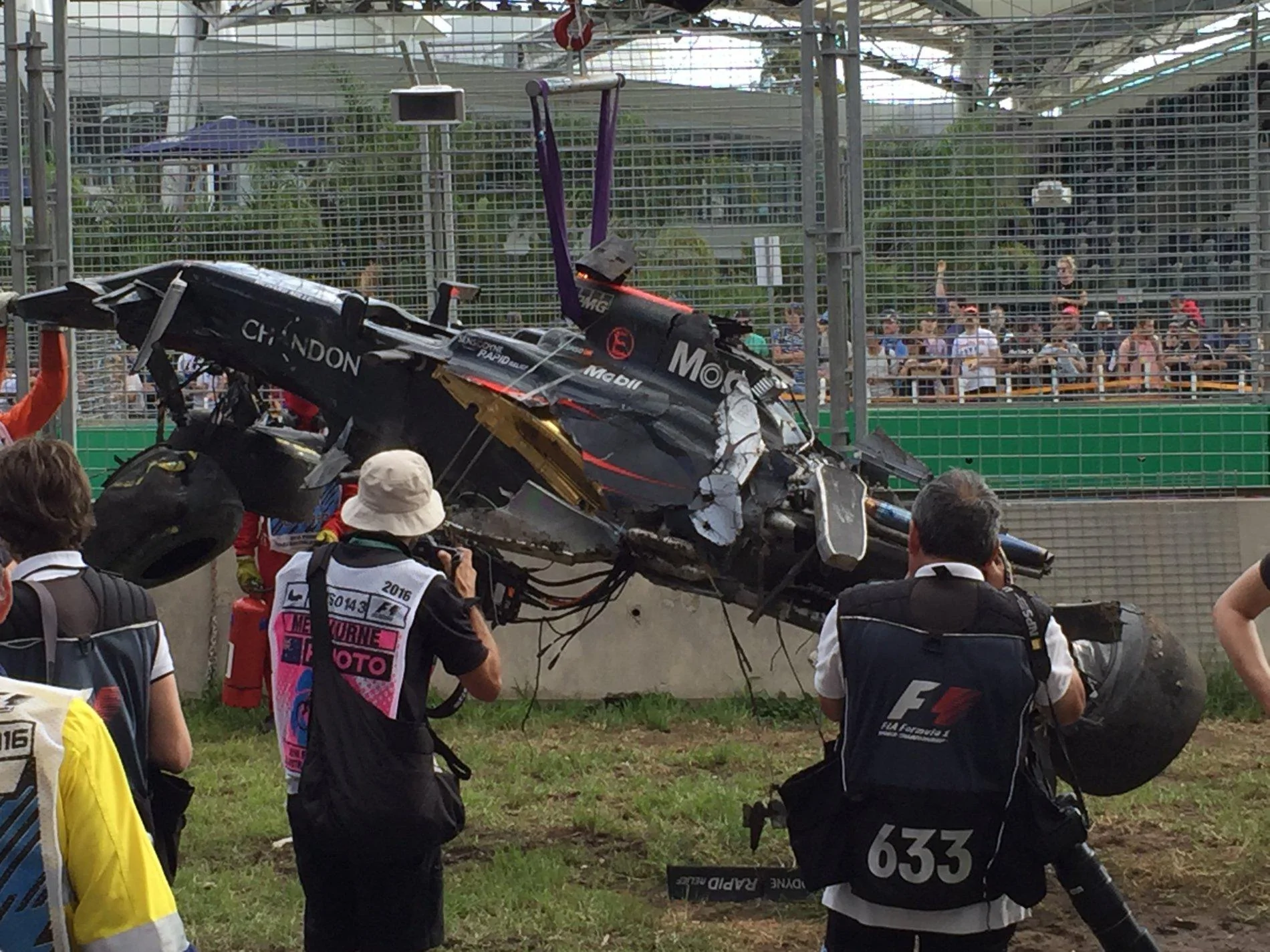

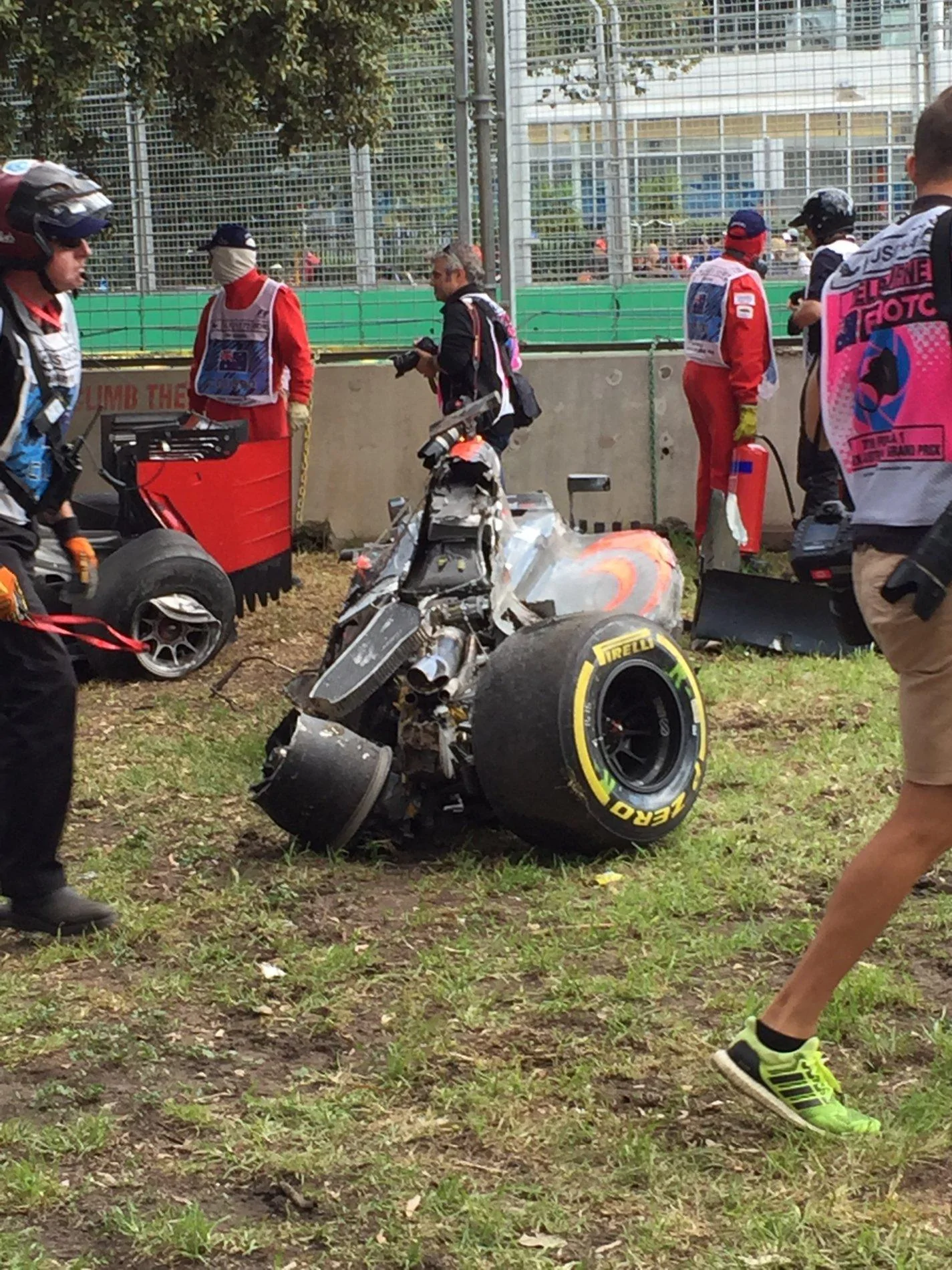

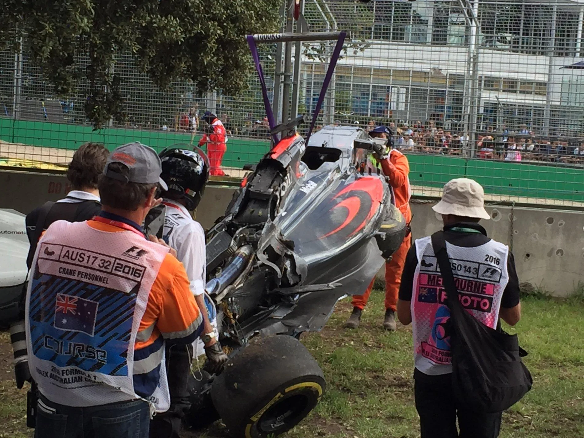

Carbon fibre is not as delicate as you make it. The structure of multiple layers with resin means that the failure is more gradual than one would suspect.
There is a reason that all drivers in serious racing trust there life to monocoque carbon fibre tubs. I have seen fernando alonso barrel role into wall and get out and walk away. The tub was all intact
A carbon fiber wheel used in service in a racing environment is indeed delicate and needs some very special attention. And CF failure isn't gradual it is imminent and rather spectacular. Cracks, etc, may be easy to see in other materials but not so much in a fiber weave and even more so when painted such as on the GT350R. You are likely not to see fissures beneath the surface of CF. It is widely understood that CF has a high strength to weight ratio - hence the performance advantage over that of a heavier wheel. But once the matrix is compromised (inadvertent high impact from curbing at a poor angle at speed, large pothole, etc) the wheel needs to be repaired if possible or replaced - at fairly high cost. That said, CR makes the wheels to Ford specification and I hold that in high regard. The wheels have no doubt passed every durability test Ford deemed necessary. From a theoretical standpoint they make sense and they absolutely have the potential to increase suspension module performance. Sorry (Hack), the issue that trumps the tech here, and its a big one, is cost and it cannot be avoided.
And we are talking about wheels here, not monocoque carbon fiber tubs. They are designed for certain aspects and in that regard the material performs very well. And in that environment we are talking uber expensive.

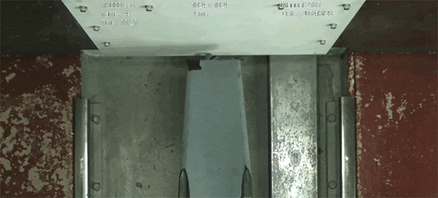

https://jalopnik.com/heres-how-carbon-fiber-absorbs-crash-energy-in-slow-mot-1578920092
CF is very strong when designed for a specific purpose and takes certain loads very well with respect to deformity or failure.
https://i.kinja-img.com/gawker-medi...ogressive,q_80,w_800/qumrdno5nqlspmwvuats.mp4
Step outside the intended window and CF doesn't perform so well.
https://i.kinja-img.com/gawker-medi...ogressive,q_80,w_800/o1oxmtbzkxdrr7f4giqc.mp4
Best Regards,
Correct me if Im wrong here.
But it looks like in the Photos the car comes with Michelin Slicks on the wheels, Why not Make those wheels out of carbon and Mount the slicks to those?
