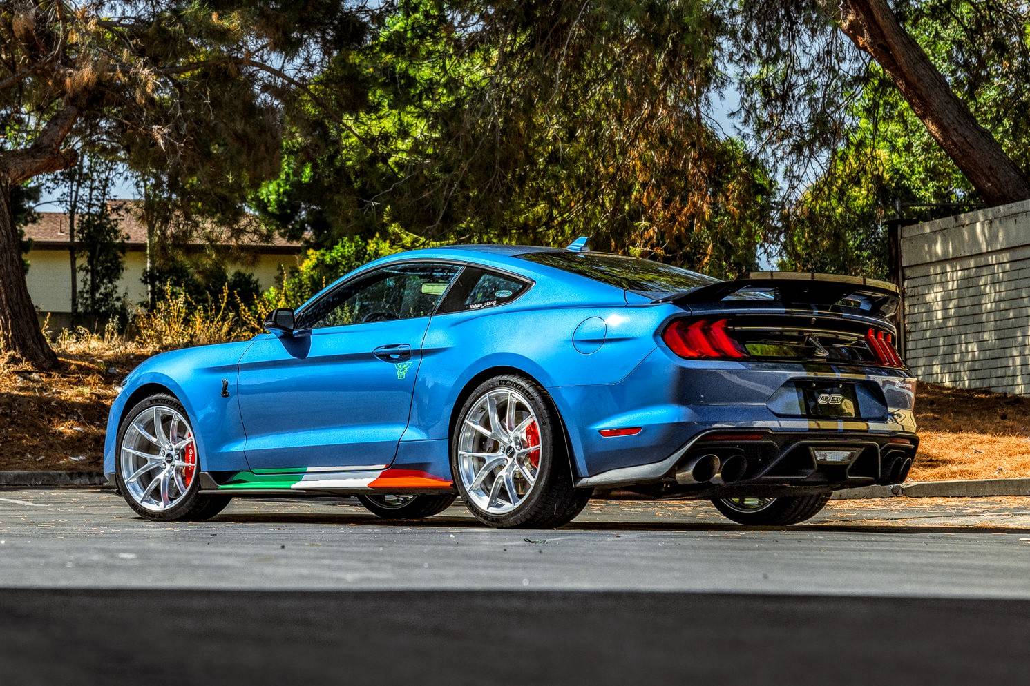

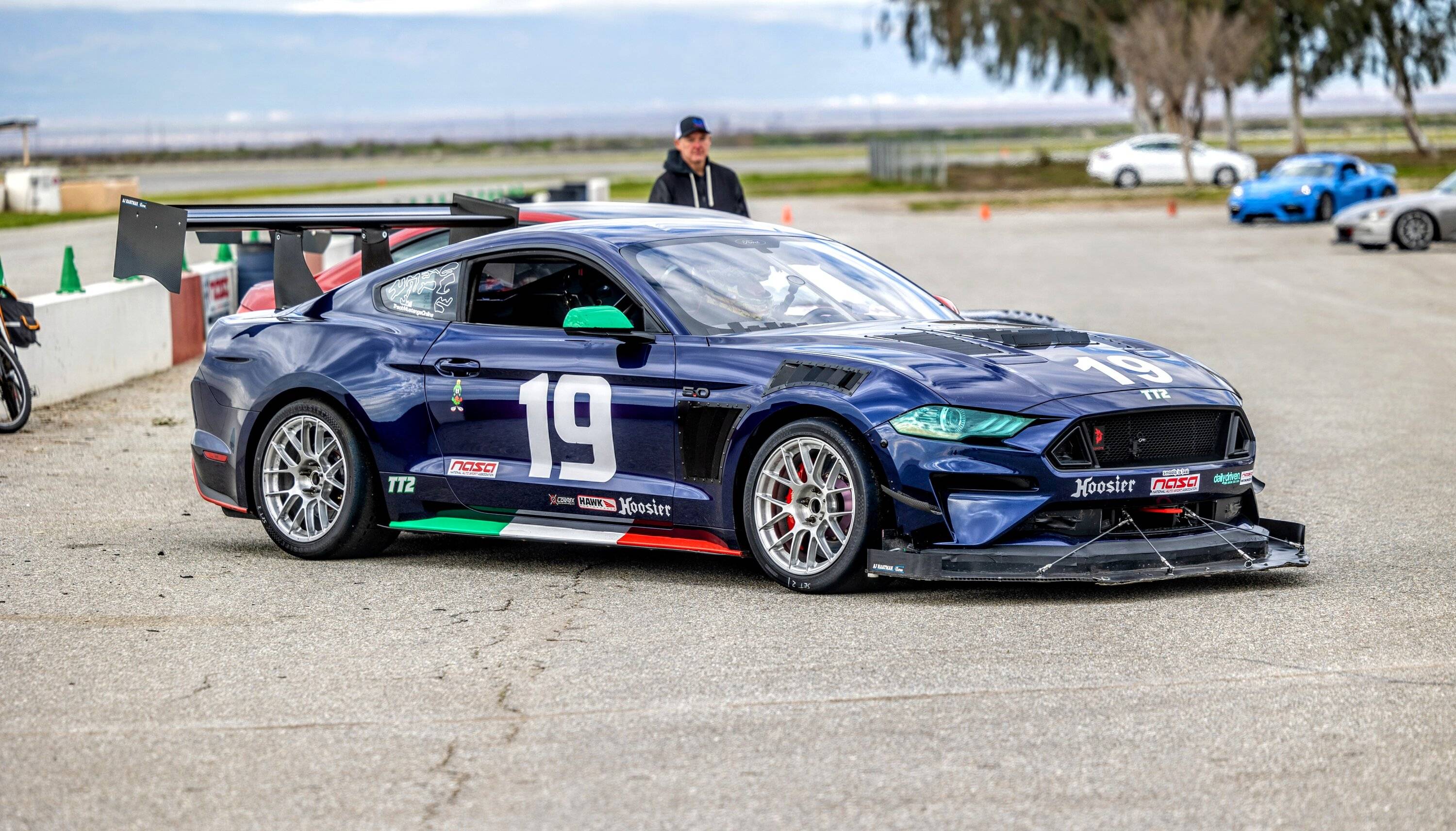

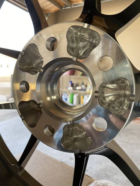

Interestingly, the only shop around who offered to work on the CF wheels, said I should get Apex, I have no experience with them...are they robust enough for track use?
They are . There are different model. Some stiffer than others.
I race them with my racecar 🙂
DM me if u need more feedback 🙂

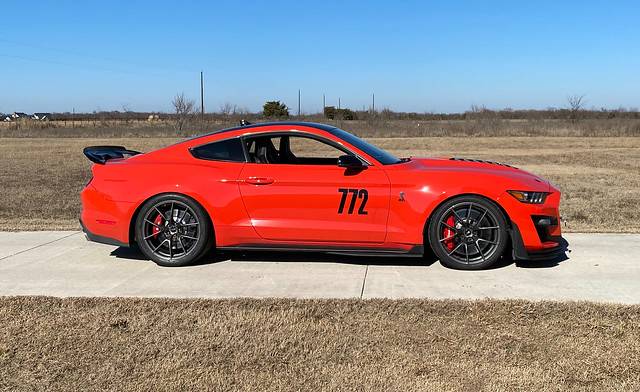

2022 GT500 Code Orange

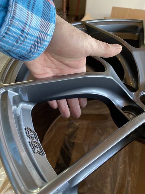

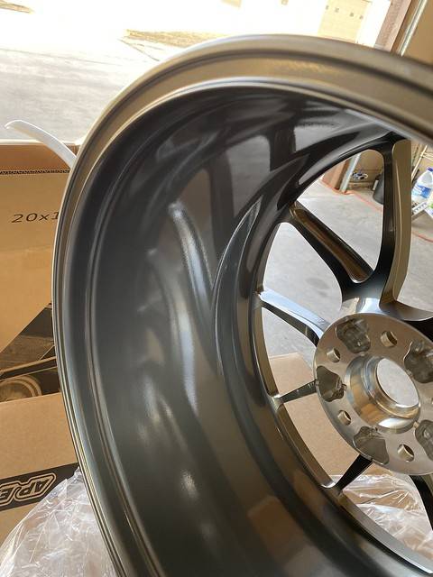

2nd for Apex. Beautiful and functional for track wheels (big lug areas, reinforcement where it counts). I was blown away when I got mine, for their price. Have had CCWs and been around lots of forgelines, and these are much closer to forgeline detail.
