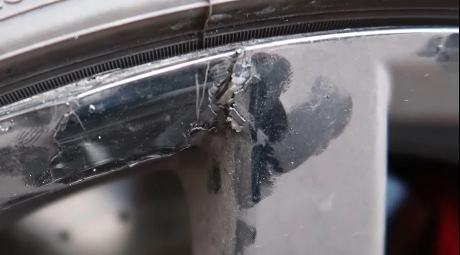

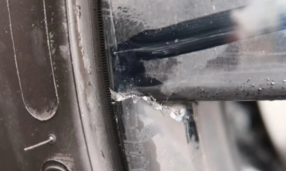

Large pothole, meet GT350R CF wheel...
(Two different time points from the same video below)

Those wheels appear to be damaged beyond cosmetics. The weave looks to be torn where the Von Mises stresses can be the highest - not good and I have a sense that Ford corporate lawyers would agree. The wheels damaged in that video are likely to not perform as well as a new CR CF wheel in both destructive and durability testing.

4) Repairable in what context? Cosmetic or structural? Those wheels were clearly damaged in a way that the underlying weave was torn at or near the fillet for a given spoke. It couldn't be in a worse spot. And based on the costs some have forwarded for rather light cosmetic damage of CR's CF wheels, I'll stick to a quality forging given the monies we are talking about with respect to repair.
Out of curiosity, and a very general question, but what do you think it would cost to repair (to a standard that both Ford and CR would approve of) even one of the wheels in that video? I sense that your number is far less than what most anyone would be quoted.
Some are superficial cosmetics, others have damaged the fibers deeper into the rim lip that have yielded - but in areas that are not crucial to the load paths a wheel sees and has to resist. All of which are likely repairable.
Both. The 'structural' damage is not in crucial areas of the wheel. Based off of how the wheel is designed and where the crack is at the spoke, its still probably not a concern until Spyder looks at it. Cost wise, you can email the pics to Spyder Composites for a quote.
