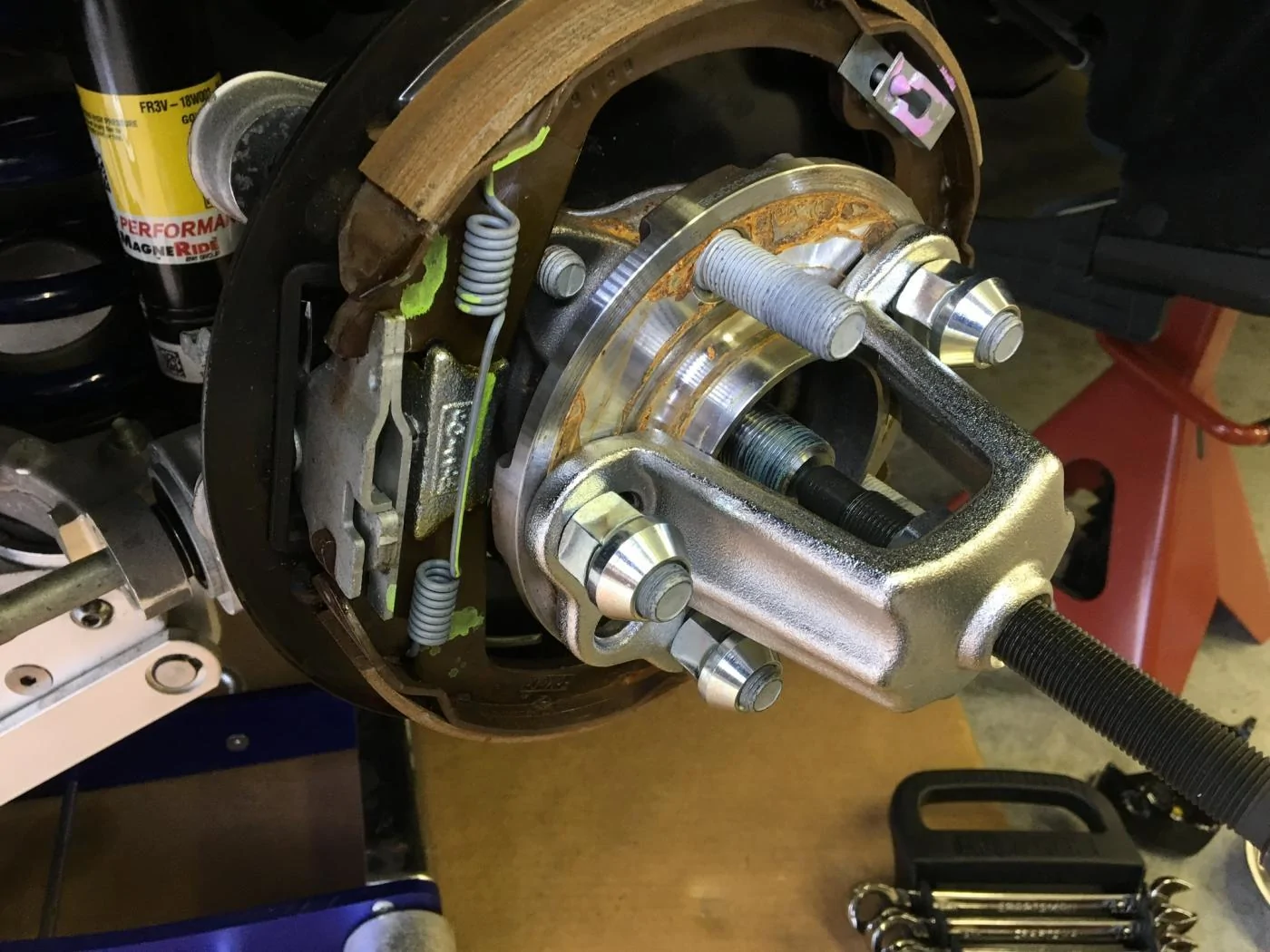

Have couple questions VoodooStang... fixing to swap the rear brakes on my 17 Base GT to the gt350r brakes.
What tool is this in the first picture?

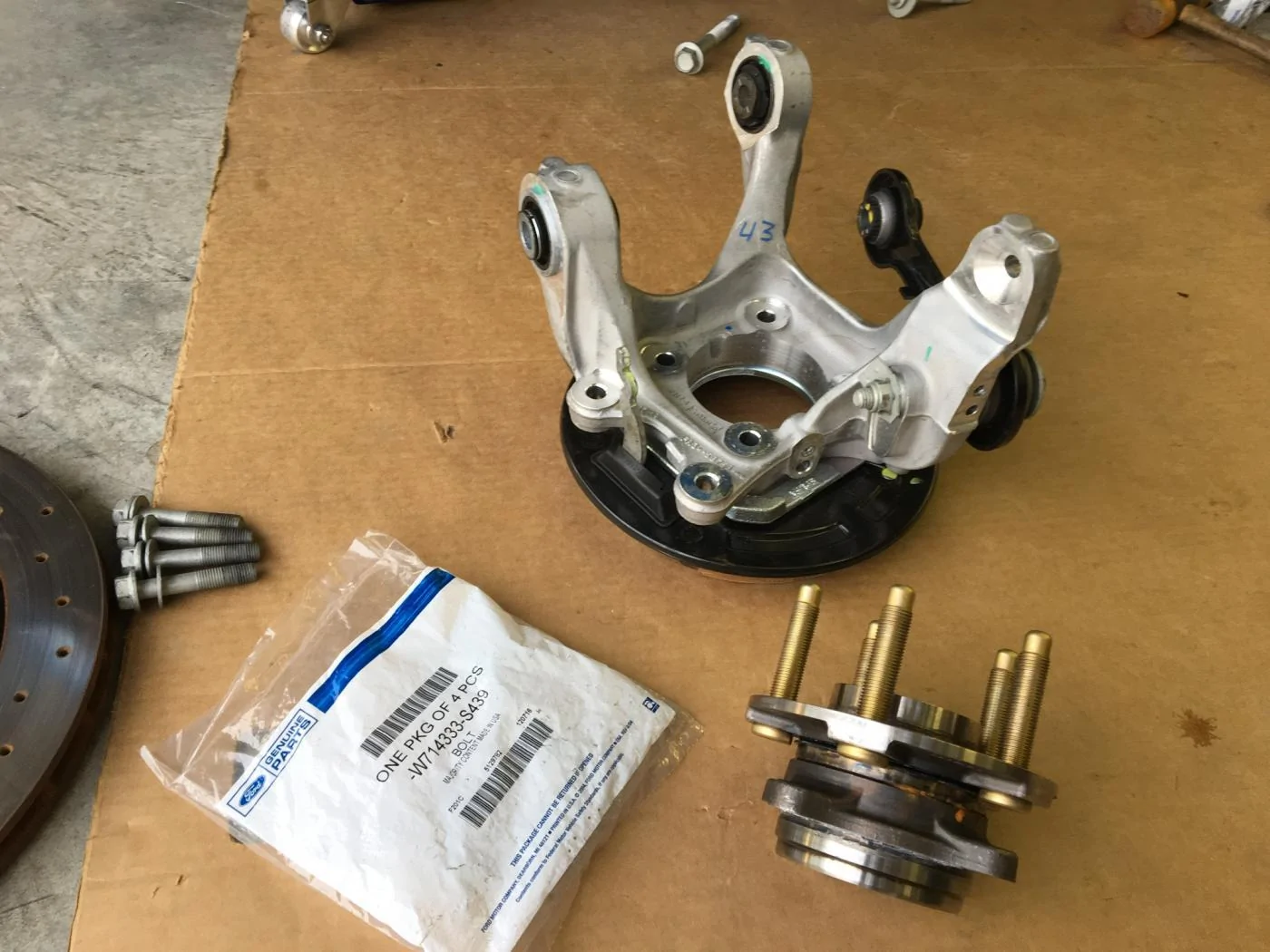

The four (4) pack of bolts (part# W714333S439) can you clarify where they go and what they are used for. Tring to understand all the parts and what I will need for the swap.
