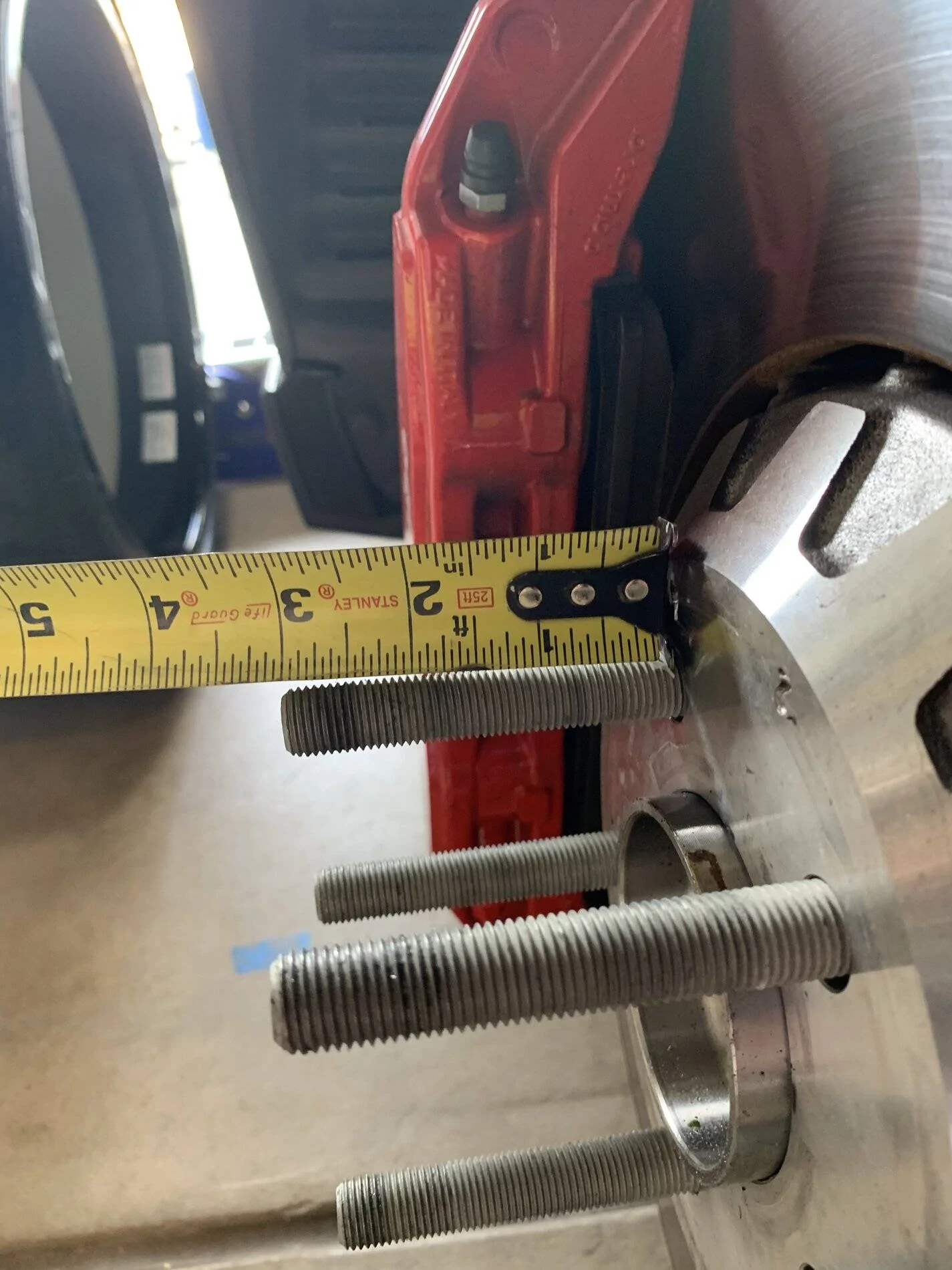

Front wheel studs on a ‘19 R. I don’t have a picture of the rears, but if I recall correctly they are 3” studs as well. The lug nuts are not open like they normally would be with 3” wheel studs because the wheel hub is VERY thick. I haven’t see the wheel studs on a non-R so I have no idea if the carbon wheels would fit on a non-R.

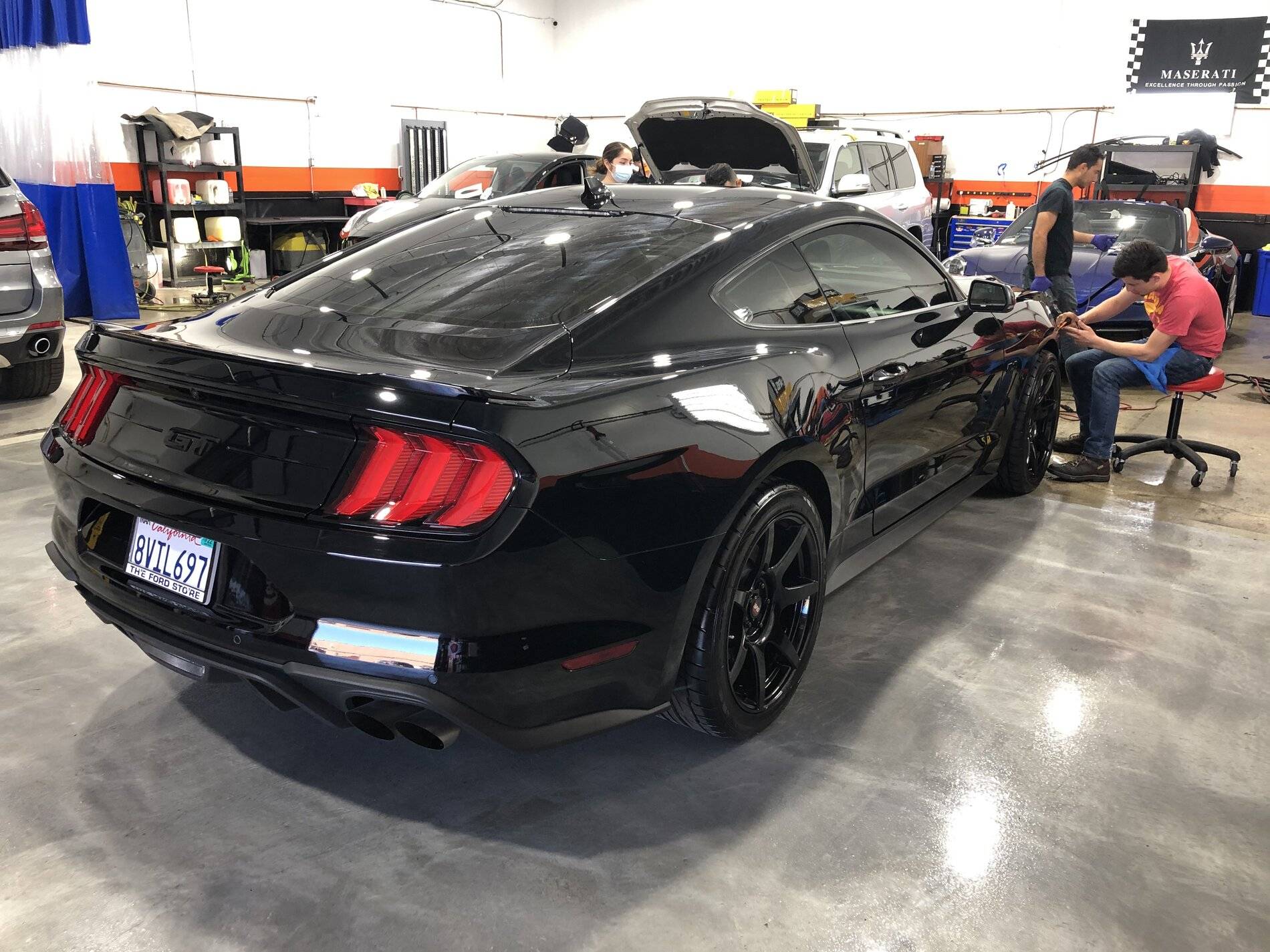

We ran replica 350R wheels on a 2020 GT no issues, other than a slight poke out from the fender on all rims.
Most 350R replica wheels need a spacer to work on 350s. I would assume they’d work great on a GT without a spacer.
