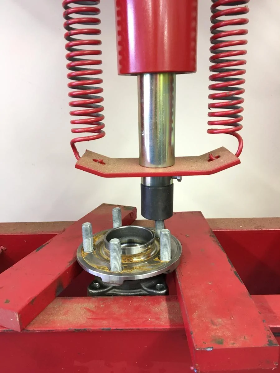

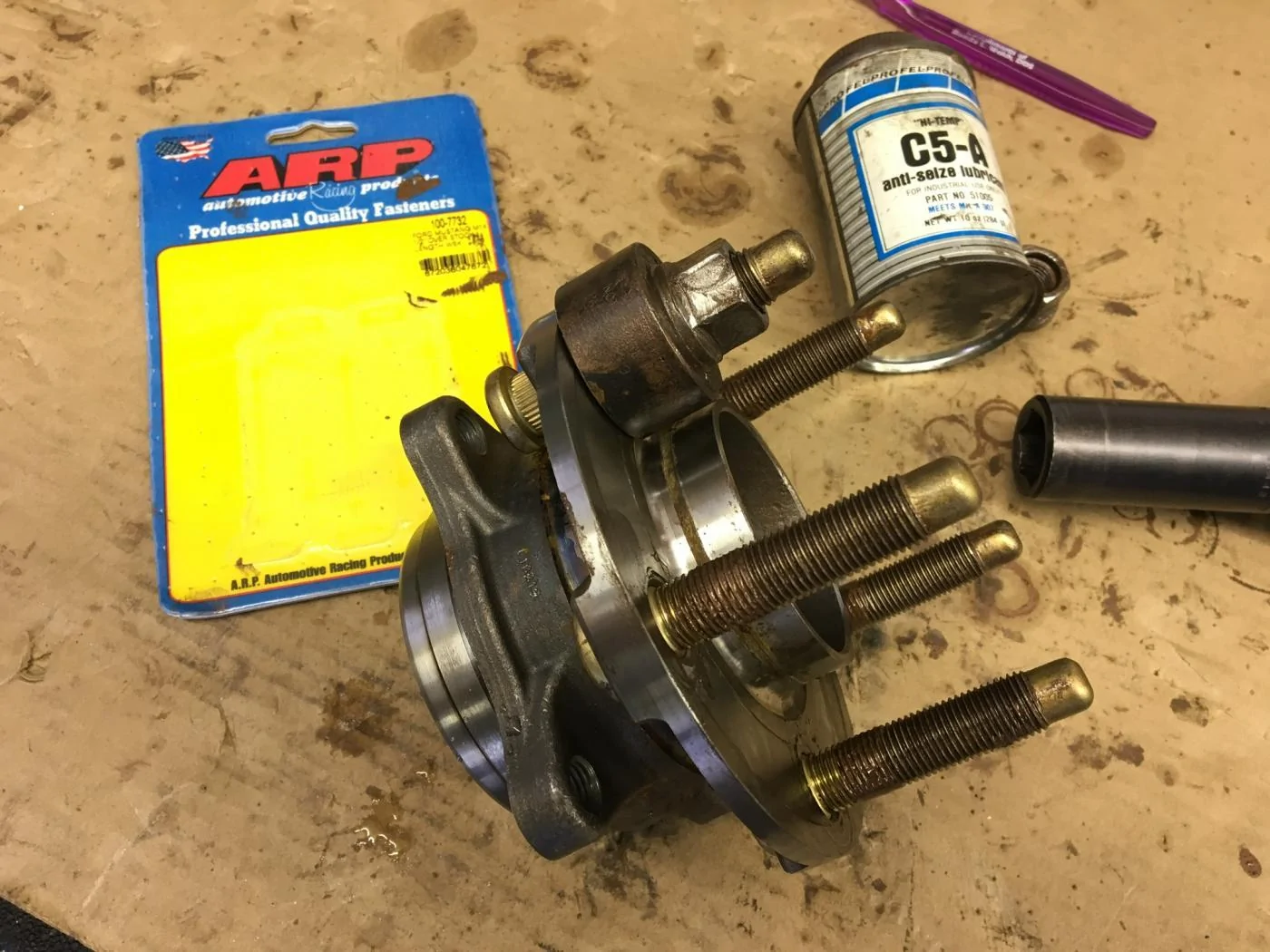

I love the ARP studs. I wish they made them for the R.
mattlqx
Driver
Aug 21, 2015
2,478
1,635
Mesa, AZ
'22 Mach 1, '16 F-150, '14 Fiesta ST, '14 Audi A7

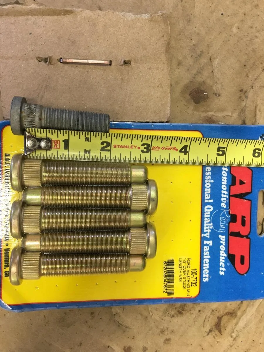

They'll work just fine in an R. 3.5" front 100-7733, 3.0" rear 100-7732.
Went through a lot of threads on this - I thought the consensus was they won't work. That comes from Optimum as well.
I would love to be misinformed and wrong though bro.
mattlqx
Driver
Aug 21, 2015
2,478
1,635
Mesa, AZ
I guess they do need a little 4" for the stock CF wheel in the front. I didn't realize those wheels were so thick.

Contact Curtis at MSI Racing in Mooresville, NC. His studs are on the majority of the cars in NASCAR, the GT350's at the Ford Performance Racing School, the GT4 cars that Multimatic built, etc. He can supply you with the length you are looking for.
http://www.msiracingproducts.com/wheel-studs-1#ford
In addition to the standard Magnesium Phosphate coating you can also add Teflon for even easier wrenching due to a friction reduction (thus Teflon necessitates a lower final torque figure).

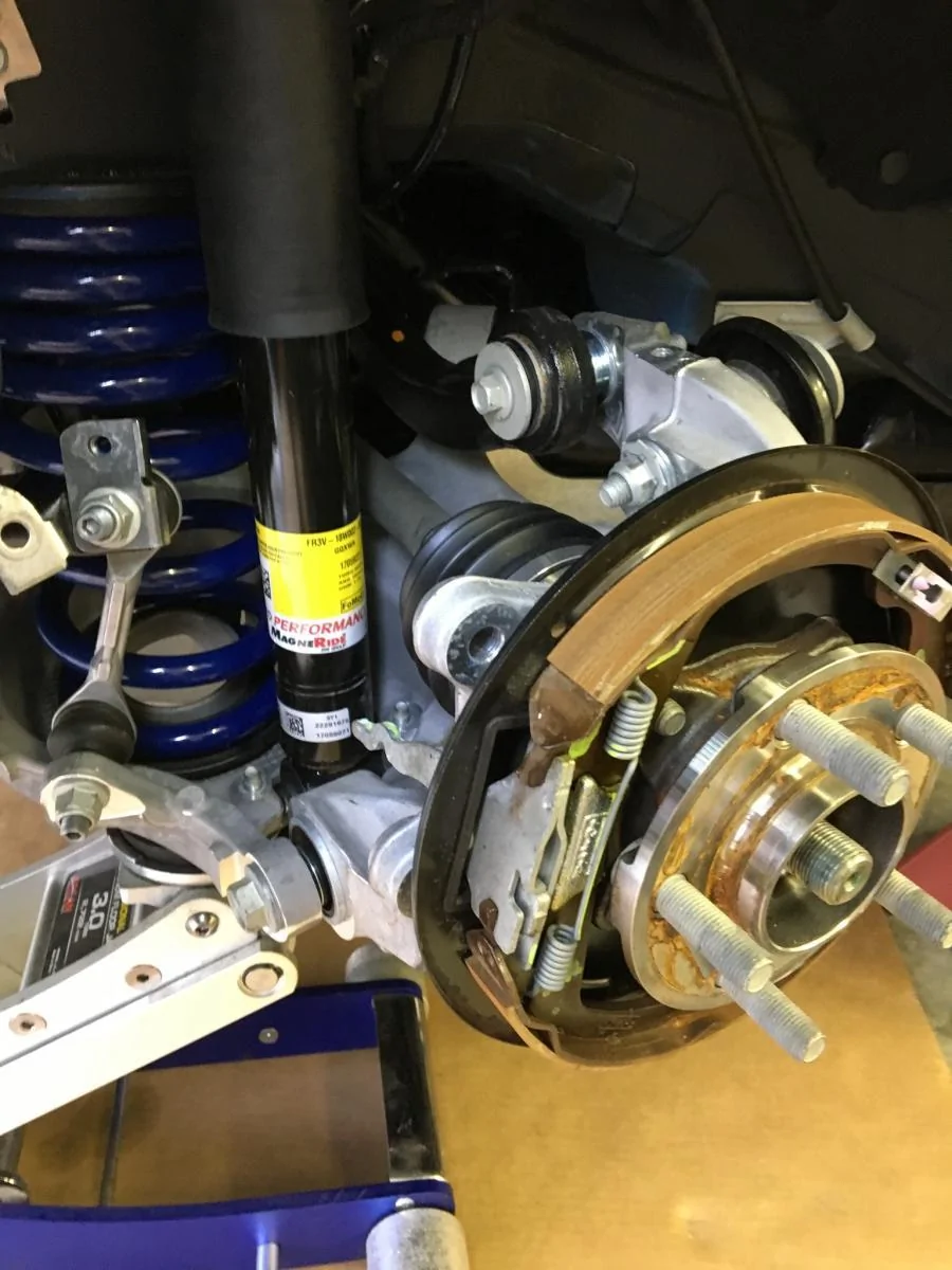

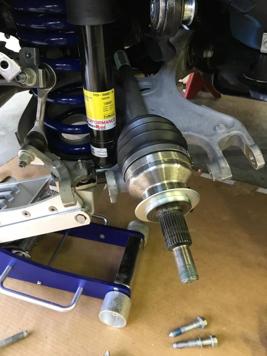

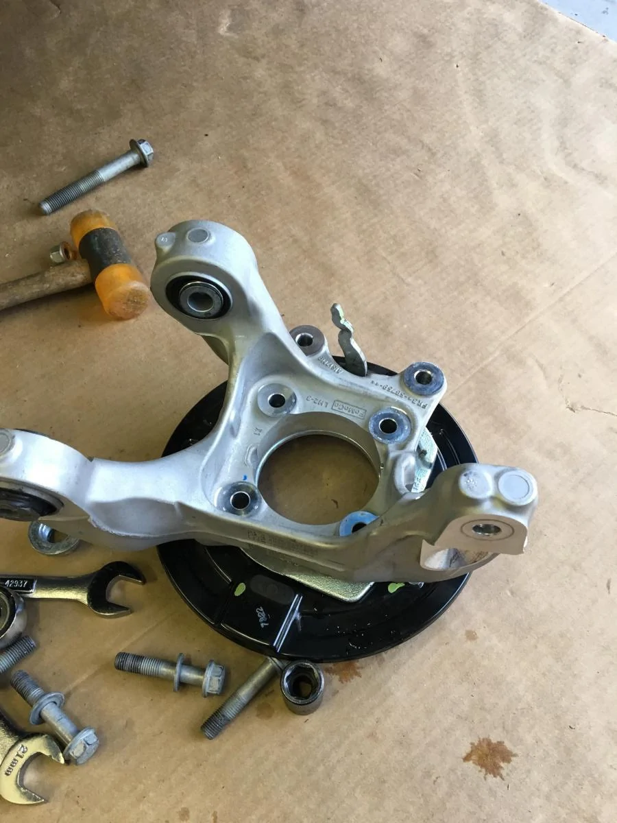

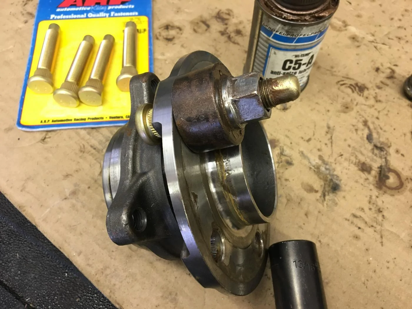

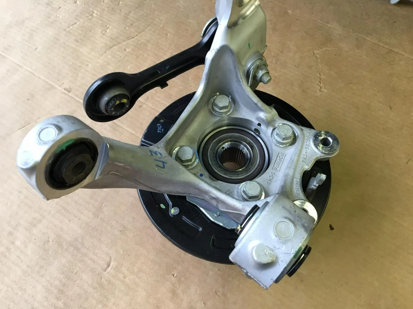

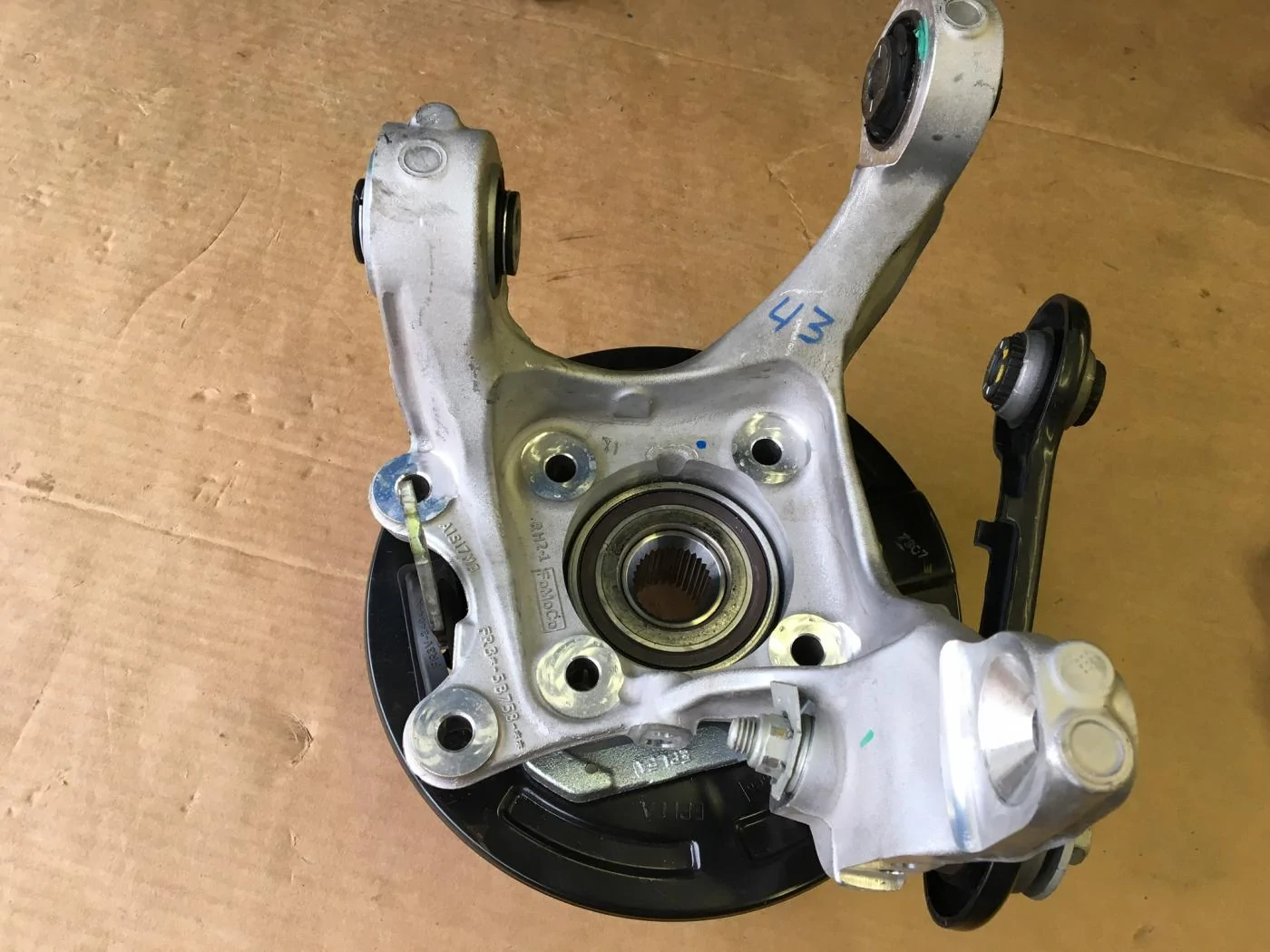

GT350 rear wheel ARP wheel studs
VoodooStang
May 30, 2017
101
107

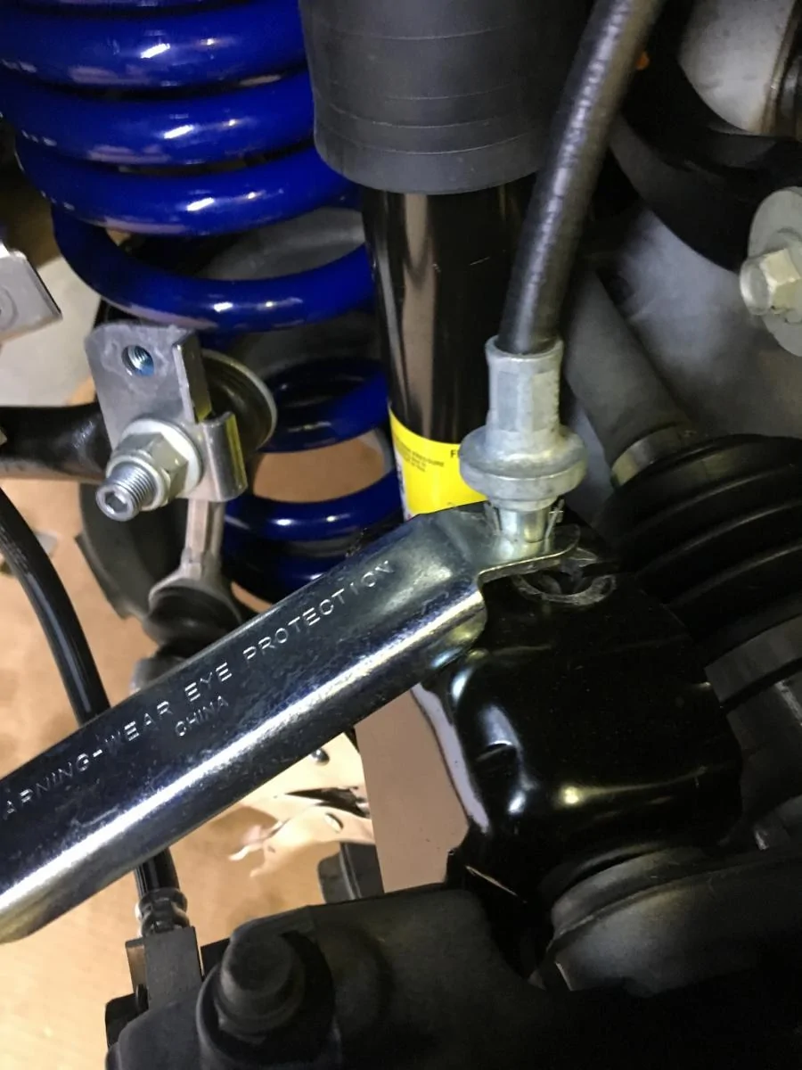

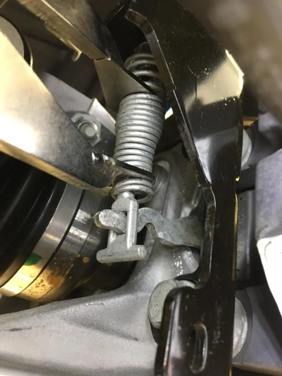

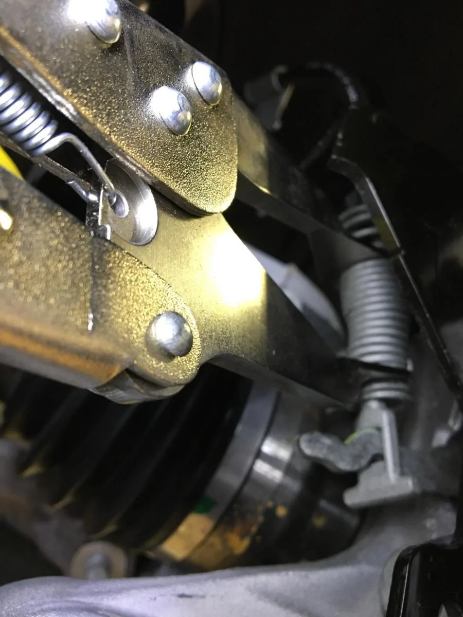

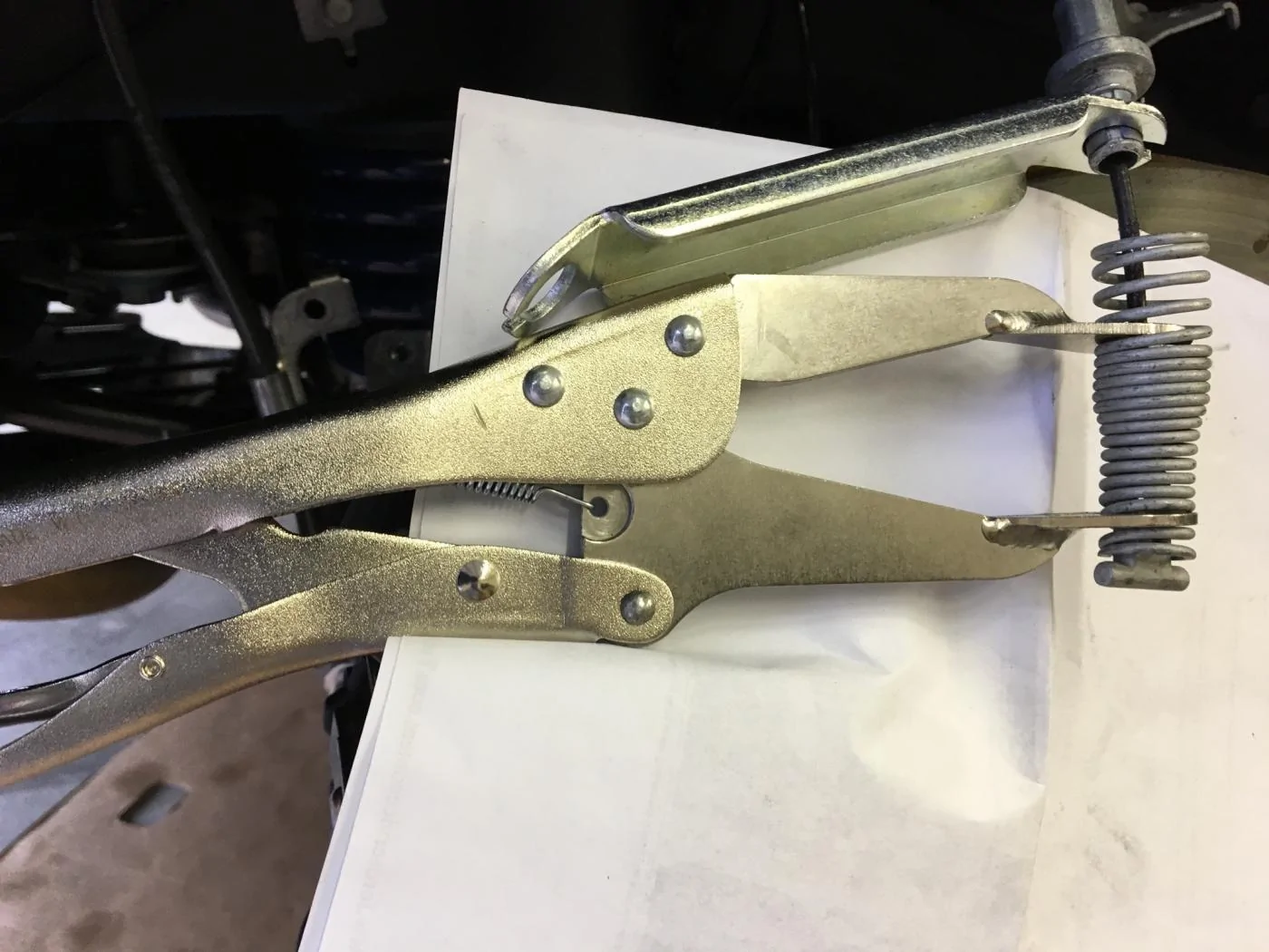

GT350 rear caliper removal, E-brake cable pics

The two tools shown in the last shot...where did you get them?

FRONT = 98 ft. Lbs.
REAR = 203 ft. lbs.
My service manual says that the correct torque for the four hub mounting bolts at the front and the rear are both 98 ft-lbs.
203 ft-lbs is for the lower control arm bolt.
