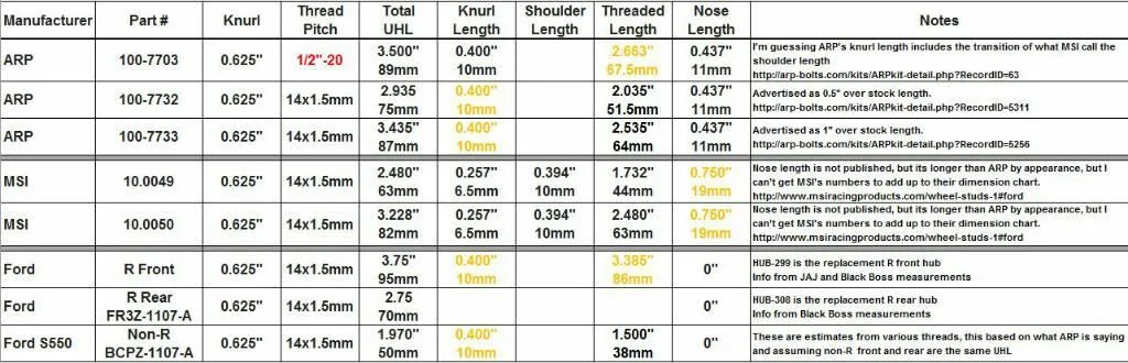

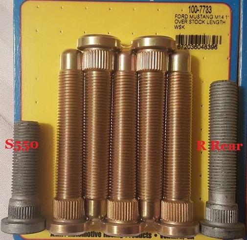

Fronts - bolts are separate, don't come with hubs. New thread locker is why you replace them, so you could locktite the originals instead. Your call. Also, the notion that you could just use ARP studs works for the rears but not the fronts - the longest ARP studs are too short by 1/2".
