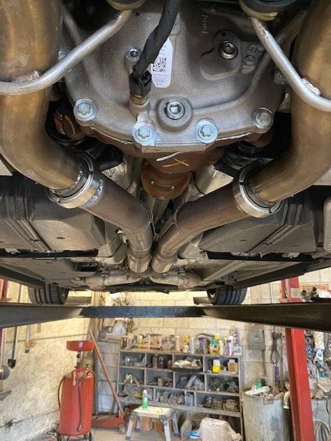

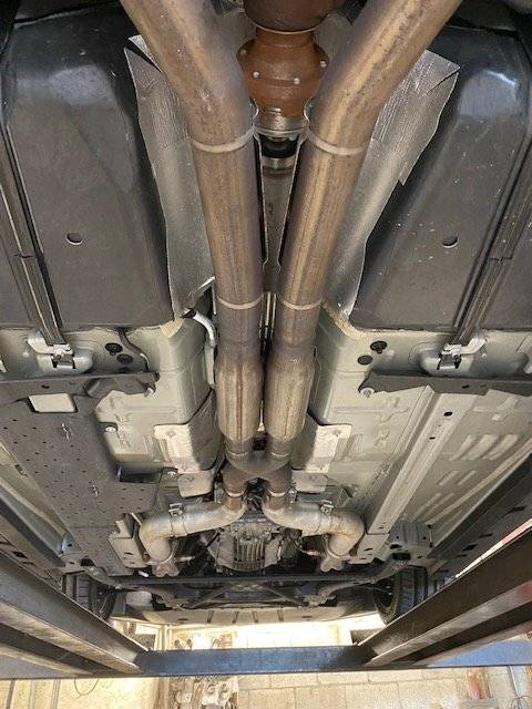

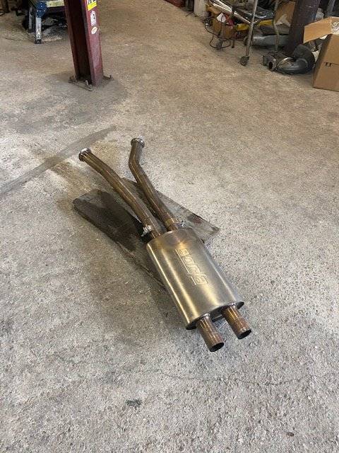

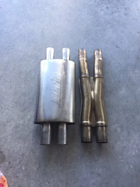

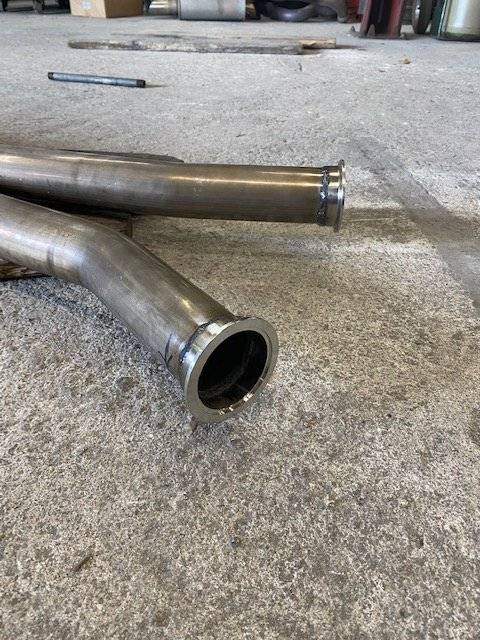

I recently replaced my Borla resonator with the GT350 X and resonator (OEM) to get a little more volume. I currently have the GT350 Sport exhaust from Ford Racing with longtube headers (off road). Unfortunately the x-pipe it came with was way too load and raspy after adding the headers. I will say though that the Borla resonator was a great solution for eliminating the rasp but a little too tame for what I ultimately wanted. The volume from the GT350 X and resonator (OEM) did increase but without the annoying rasp. I was able to find a performance muffler shop that custom fit the GT350 X set-up and the Borla so I could swap them if I needed to. We utilized the factory clamps up front and added some V band clamps in the rear. The challenge will be to find the X-pipe and resonator not chopped up and in one full piece. I got lucky and found one in the “want to buy & trade” section. Good luck

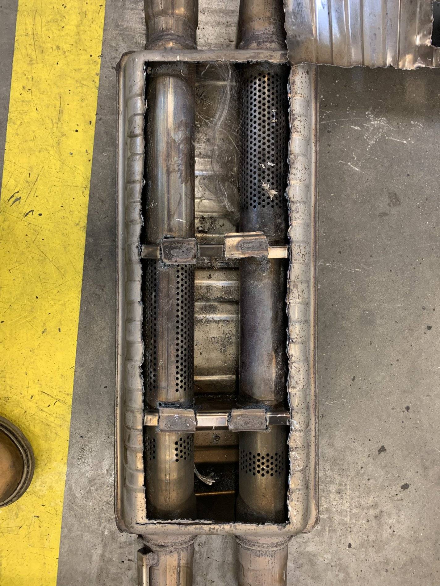

Does anybody have a cutout of the GT350 resonator? Want to see the difference inside from ours.
