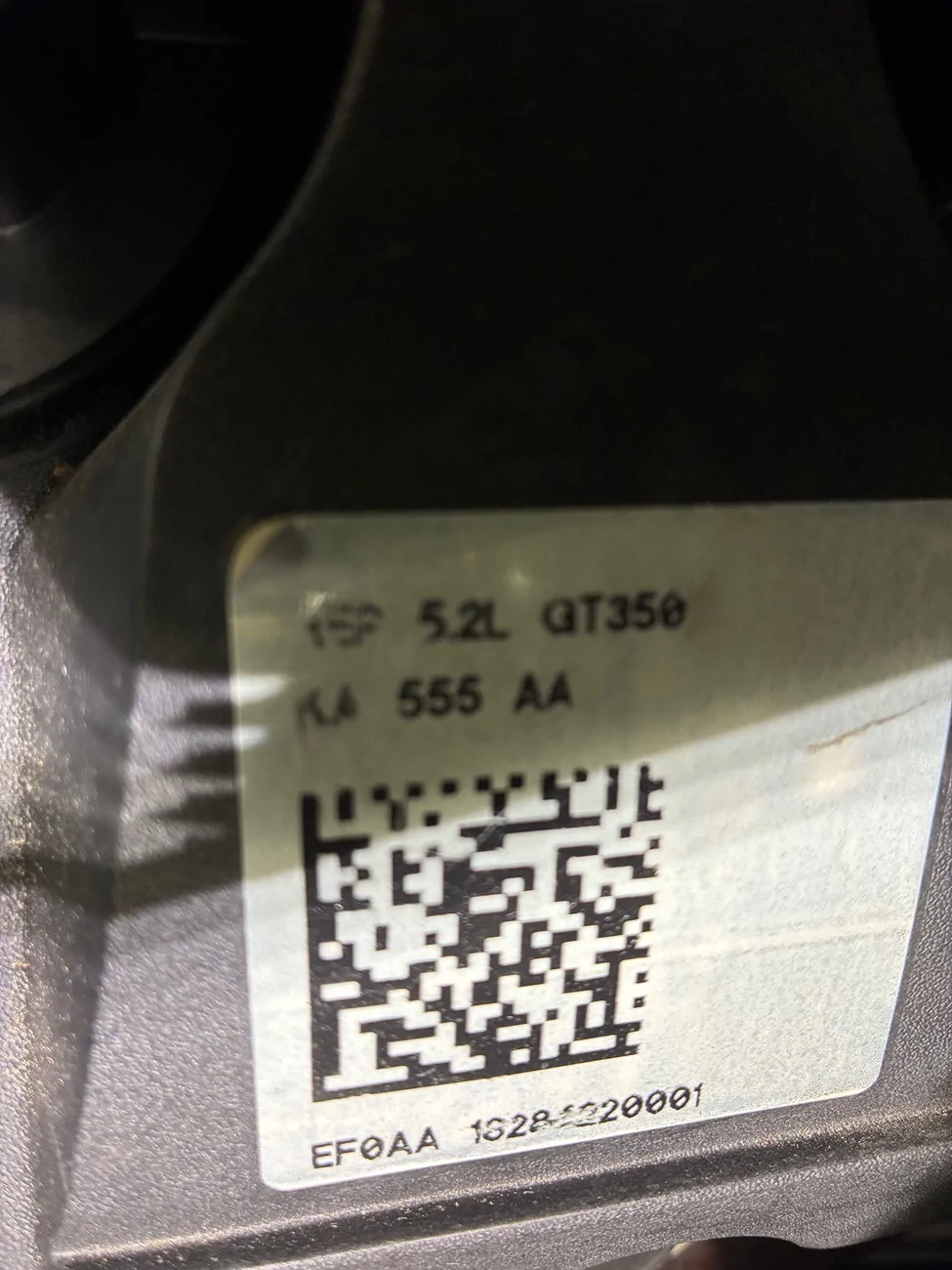

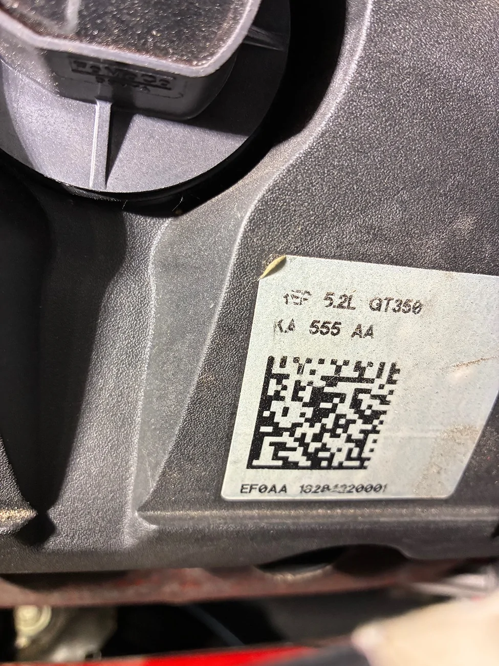

Changing plugs today and took the opportunity to check engine build sticker.
Looks like gen 2 from late 2018, 286th day maybe, hard to tell from picture.
Car is 2017 GT350 and was purchased in Jan 2020 with ~7k kilometres. Dealer did not disclose that the engine had been replaced. Car now has 27k kilometres and I’ve had zero issues. A little disappointed that this might affect resale value if I ever decide to sell, but there are some positives with having gen 2 engine also.

I would personally consider a Gen 2 engine a "value add" and I suspect a lot of GT350 owners would agree. I doubt there is a "Gen 1 Voodoo Engine" fan club.

I am. Gave me an excuse to go CPC. Glass half full type of deal lol

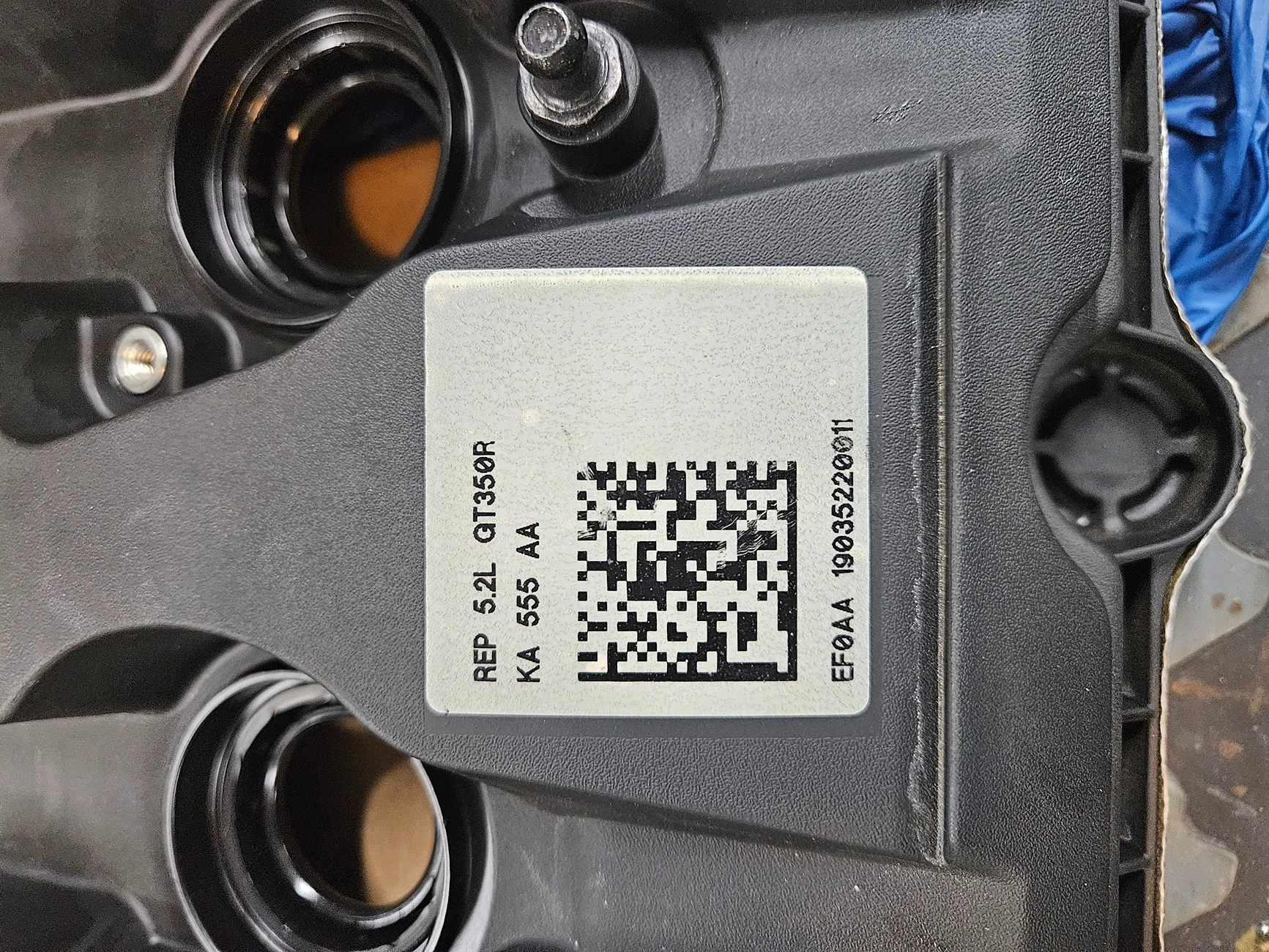

Be careful with those QR stickers. Don’t use any water or cleaner on them. They come right off. In fact it’s a good idea to cover them with left over xpel or similar coating, for longevity. In my 2018 that had a new engine, I wiped the QR code sticker and wiped it clean!!

Thanks, I like the PPF idea. Sticker was lifted on the corner when I took the cover off, just wiped with a damp microfibre. It would be nice if the QR code was active for owners.

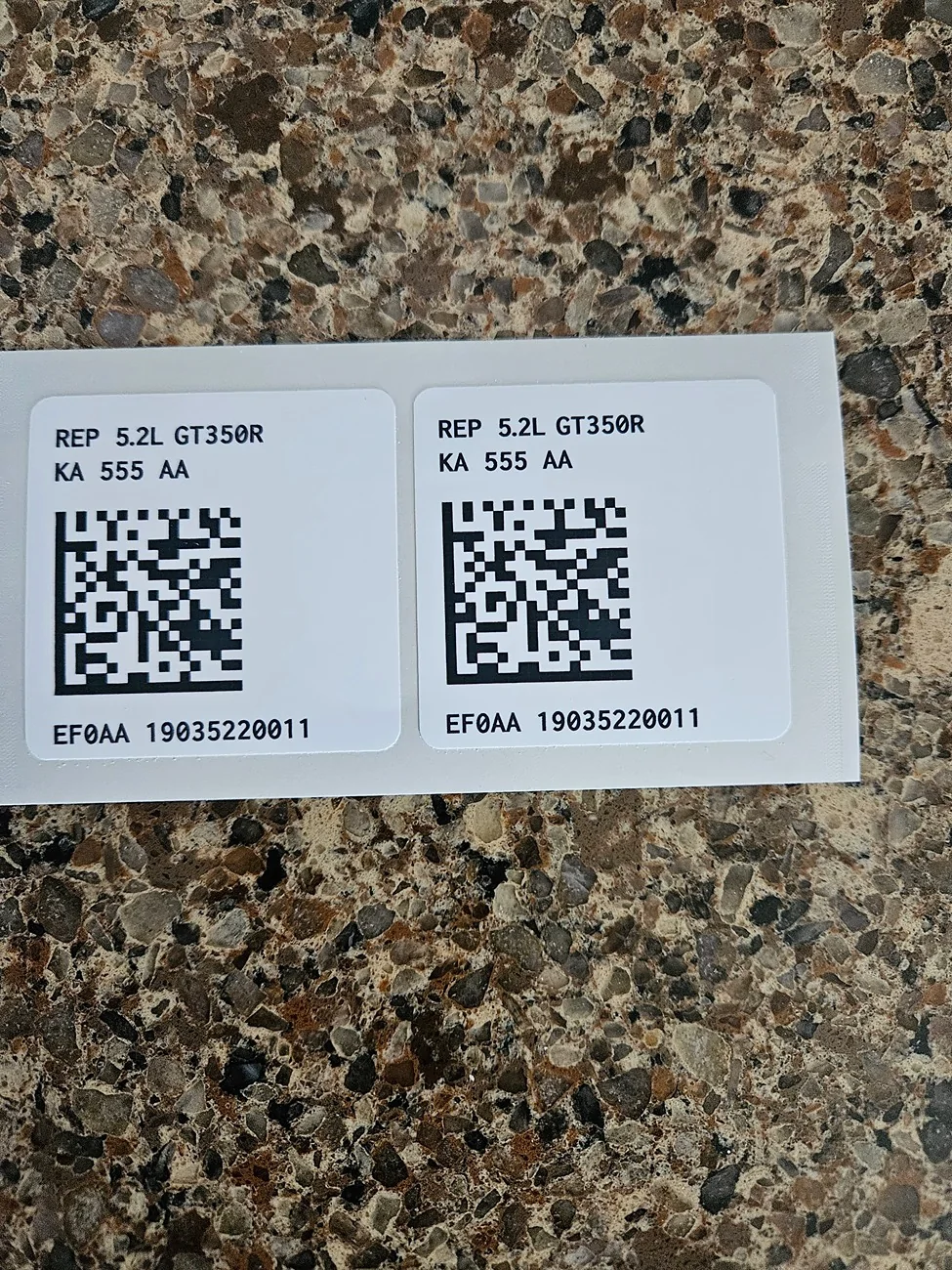

When i replaced my cam covers with the aluminum Ford Performance ones i had new stickers made to put on it.

I am not 100% sure, but I believe Gen 2 motors are all labeled as 350R motors. If true, this would make your engine a Gen 1 engine.

I agree that all 2019 and up are GT350R engines. What is odd is that shows "KA" which designates a 2019 but does not have the R on it after the 350.

Could have been built before the switch over.

Could be, I’ll check to see how many knock sensor bosses the block has since gen 2 has 6 versus 2 on the gen 1. Both only use 2 sensors however.

It has 6 knock sensor bosses, gotta be gen 2.
