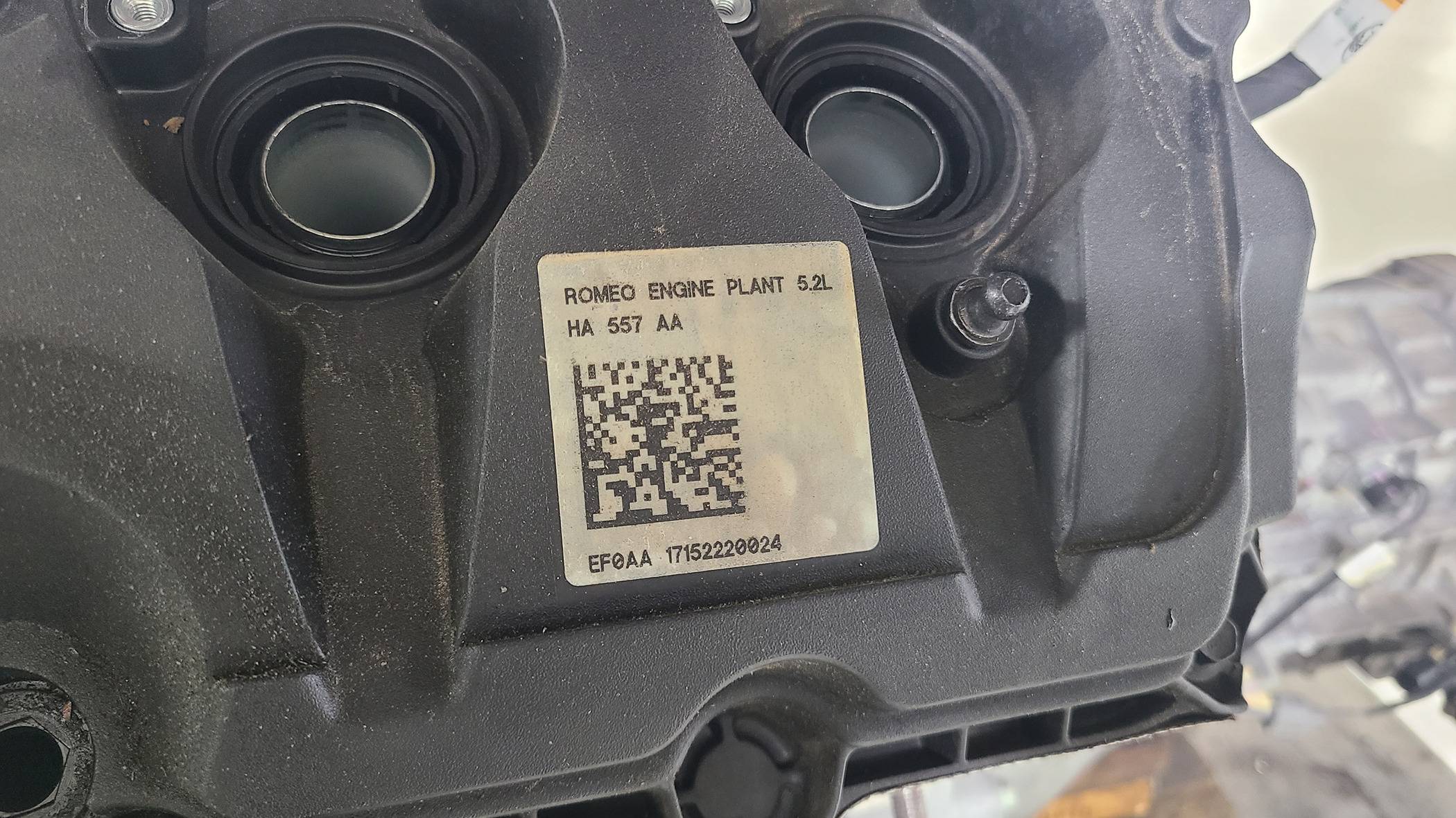

@Revan9 I got the same weird case.... (I am from Germany and was thinking about buying my first gt350) the owner sent me this picture...after I asked for it...
The weird thing is it's first car registration was in 2017, the engine was build (if I am right) on the 26th of October 2016 and the label says FA ....so a MY15?!?

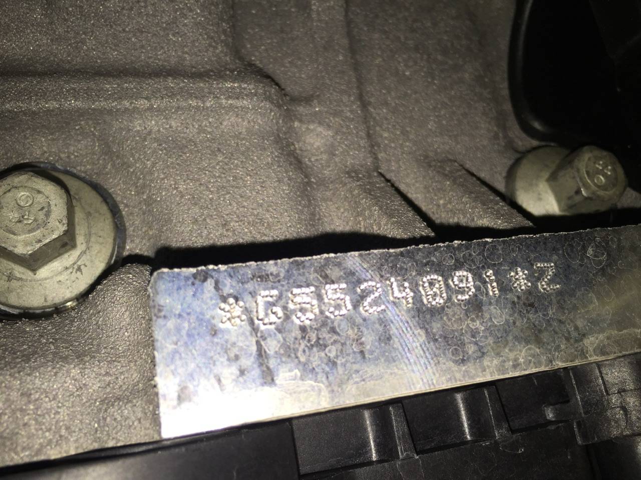

If your car has the original engine, the VIN is etched into the block on the bottom skirt, just above the oil pan. Just in front of the bell housing on the driver’s side:

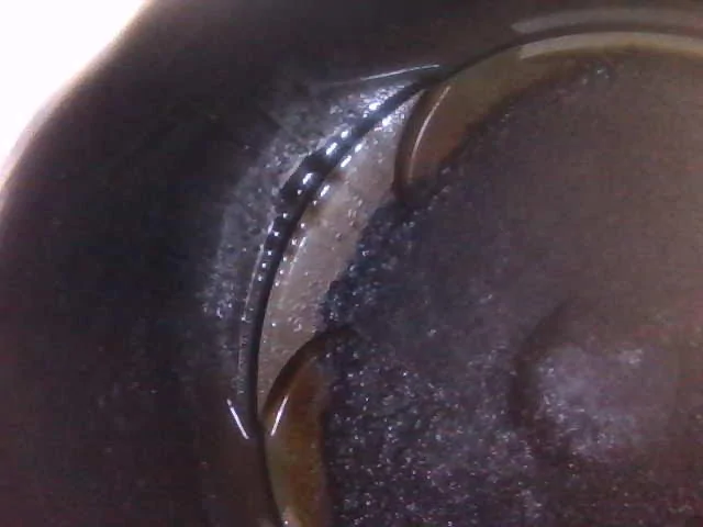

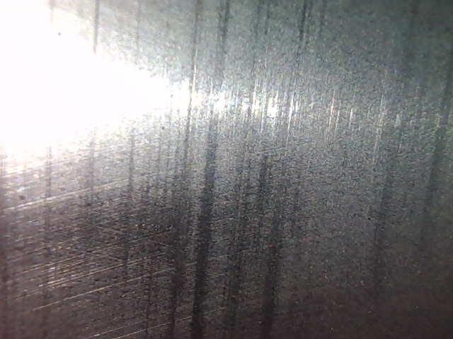

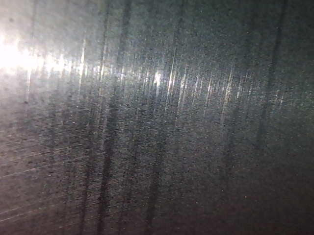

For those curious: My '17 had 25,000 miles when I brought it in for consumption test. Dealer asked me to perform six consecutive 500 mile tests. I was burning 1-2 quarts per 500 miles. After the last test, warranty company asked them to borescope the engine. Tech found a decent amount of bore scoring (with pictures.)
Can you get more information on this, anything that may point to a cause for the scoring inside the cylinders? Which cylinders were affected?

I meant to ask him today about which cylinder(s) the scoring was on. As to the cause?
🤷‍♂️ I don't think he took the valve covers off to see if the cams had any damage. Update: Followed up with tech, he said the scoring that's pictured was from cyl 1 and he saw no reason to check the others.
The car had 1,500 miles when I bought it back in 2019. I've been using Amsoil since then and I kept pretty accurate records, i.e. a spreadsheet, of every oil change and any additional oil I added between changes. I was always checking the oil and topping it off. It's not my first or even second car with a "built"/high strung engine so I'm diligent about letting it warm up before going beyond 3-4k RPMs or heavy throttle etc. 250F is the hottest the oil has ever got.
Engine ran great as far as I'm concerned. Weird, subtle hesitation around 2,500-3,000 RPMs since I got it. Excessive piston slap since I got it. But apparently that's normal and acceptable
:rolleyes:

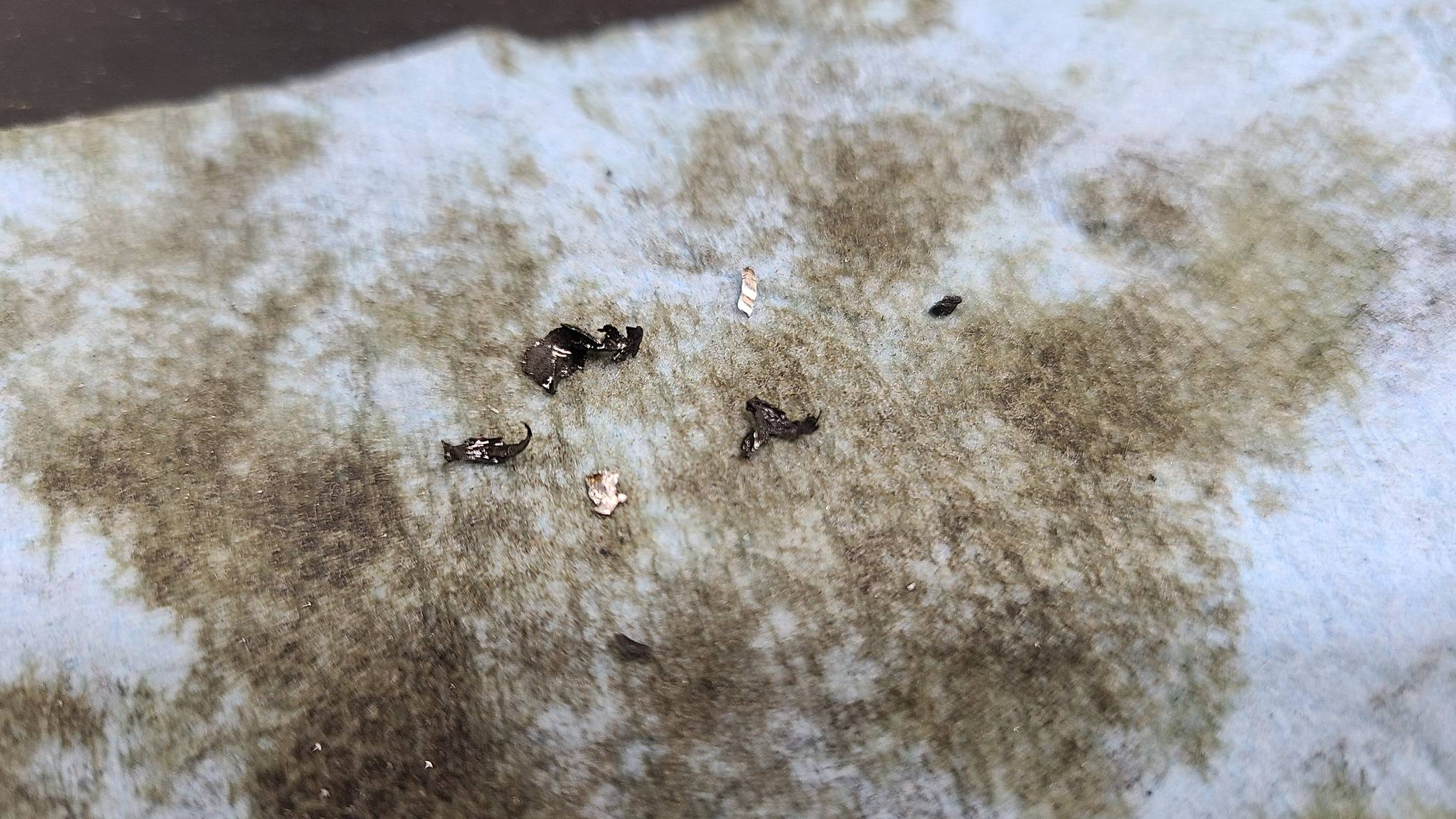

The red flag for me was when I last changed the oil, I found a couple metal shavings in the filter. That combined with the oil consumption (on one oil change interval, which was 5,800 miles since my last, I had topped it off with 11qts over the year) is the reason I decided to bring it up to the dealer. Well, that and I had a bad wheel bearing and the A/C had leaked from a line rubbing through on the valve cover.
And yes, I had done 4 Blackstone Lab tests over the years and they saw nothing abnormal, aside from the fact that 11 additional qts basically meant the oil was like new in there and wasn't a good indicator. TBNs also showed that the oil still had plenty of life left in it even with a 5,000 mile interval (which was longer than I was comfortable with anyway.)

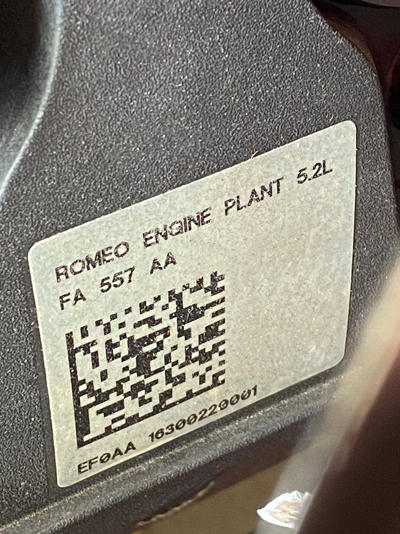

I looked at my engine sticker and saw the following, FA 557. FA I think is model year 2015. The engine was built on June 8, 2016 and the car was assembled on June 16, 2016. How is it a model year 2015 but sold as a 2017? I’m obviously missing something. ( original engine, stamped numbers on block match VIN)

FA was on all engines 2015 thru 2018 until 2019 block change and then changed to KA for 2019 and 2020

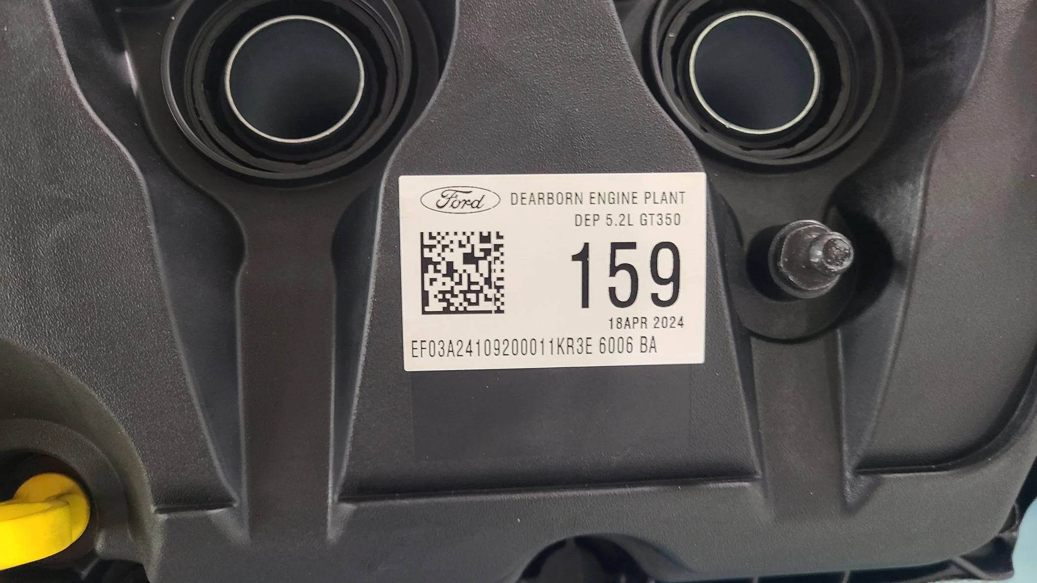

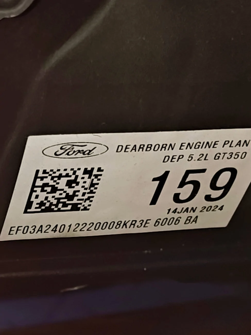

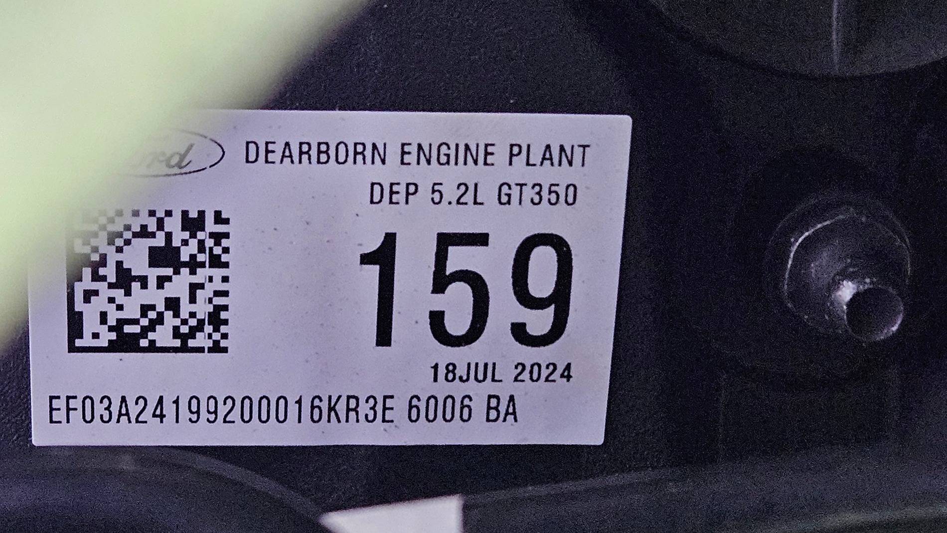

my car has a Jan 2024 Dearborn sticker. Did any of you ever figure this out? I have some people saying I have a gen 1 and others claiming gen 2. Surely being built in 2024 there is no way it’s a gen 1.

Gen 2, everything 2019 and up is Gen 2, when Romeo engine plant shut down, replacment engines come from Dearborn
