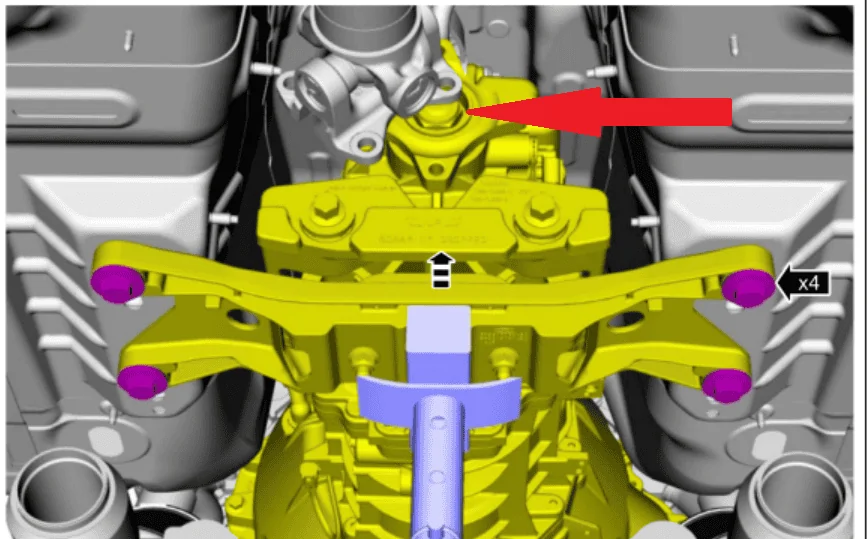

Indeed it is. I live 15 minutes from the track.
Thank you. Any idea how loose it gets? If I lift the car up tomorrow will I be able to reach in and feel whether or not it's loose by hand?
JAJ
Apr 9, 2016
2,232
1,987
Vancouver BC
2016 GT350 Track Pack
Unfortunately, the nut in question is the tailshaft nut on the transmission, and it's sandwiched in the space inside the U-joint at the front of the driveshaft. To access it, you have to remove the exhaust system and undo the driveshaft.
It's the nut that's partially obscured - the one with the big red arrow.

Unfortunately, the nut in question is the tailshaft nut on the transmission, and it's sandwiched in the space inside the U-joint at the front of the driveshaft. To access it, you have to remove the exhaust system and undo the driveshaft.It's the nut that's partially obscured - the one with the big red arrow.
I know where it's at. I just wasn't sure it is was something that would be obviously lose when I got in there. Either way, at that point it's easy to put a wrench on it and see.
