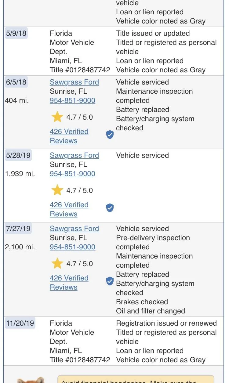

Hey Everyone,
I’m looking at this 2017 GT350 with only 2800 miles but I have a couple questions/concerns.
On the carfax report it says the battery was replaced at 400 miles and then again at 2100. Are we looking at someone who doesn’t know how to turn lights off/was letting the car sit too long or a potential bigger issue with the alternator here?
