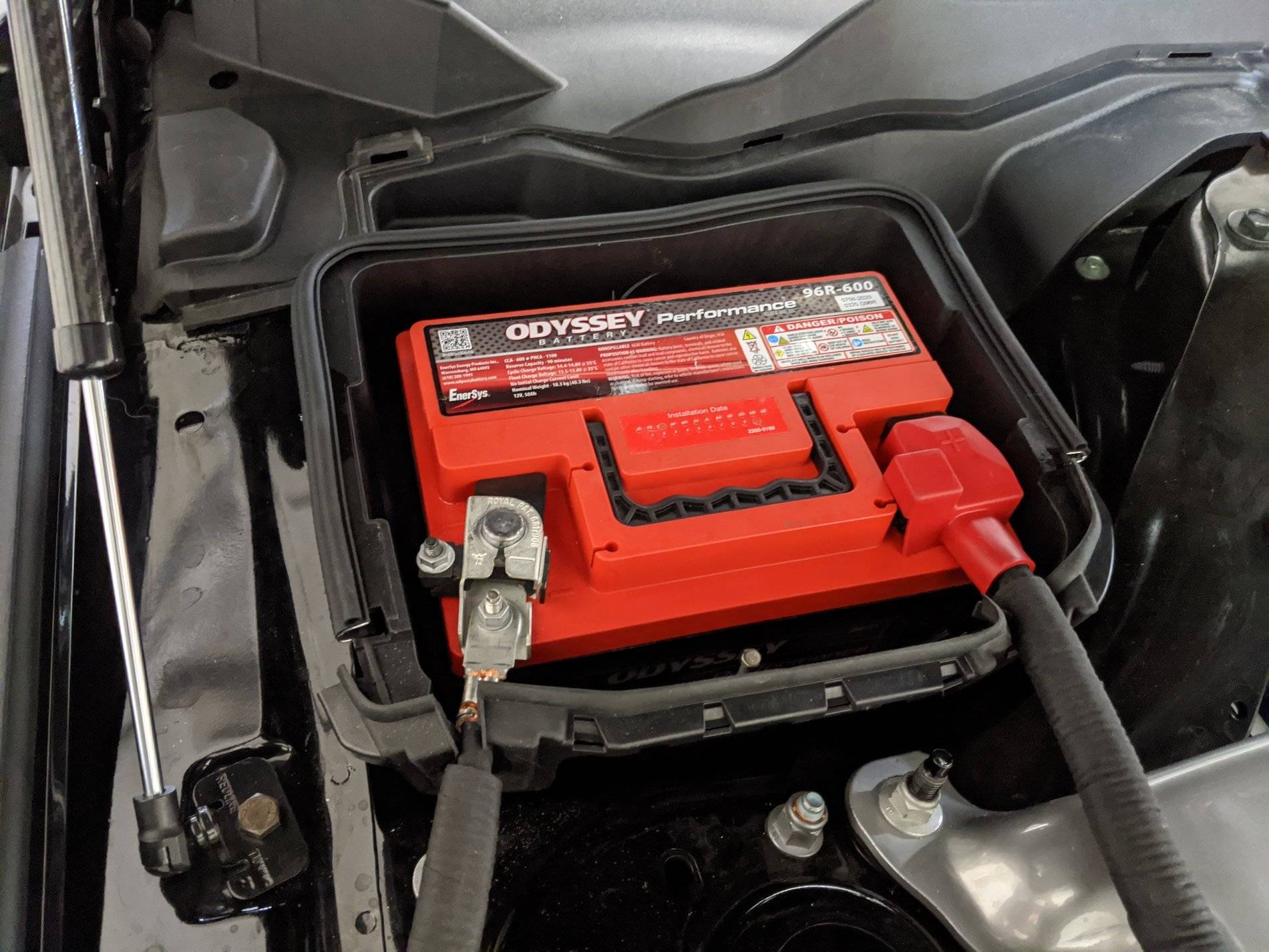

This Top Flight AGM Battery and Battery Maintainer are your friend, if you are not daily driving your GT350.
With the stock OEM battery your battery voltage will likely be below 11.5v after 10-14 days setting idle.
I was experiencing issues where the keyless entry system was faulting at those voltages even thought the engine would crank nominally.
