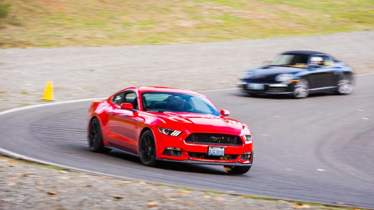

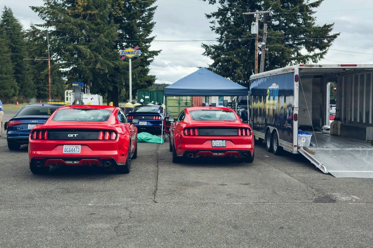

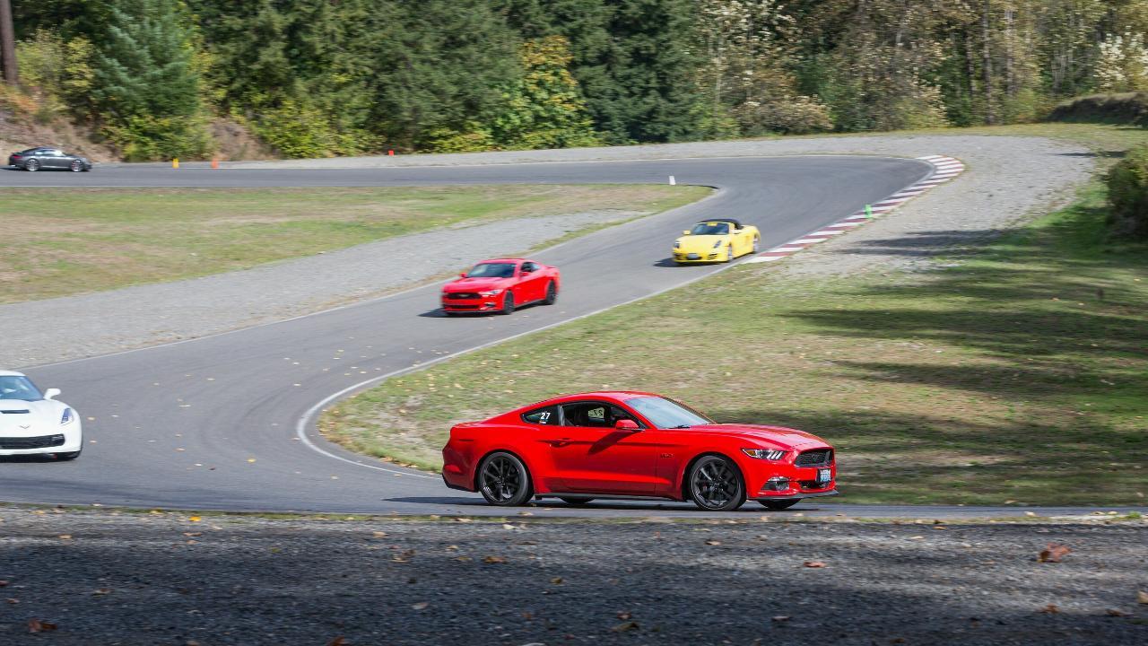

An interesting though. At our last Mustang track day a friend and I played together for 4 sessions. I use the torque of fourth and fifth to accelerate onto the front straight here at Pacific Raceway. Then shift into 6th at around 135 mph and let the torque pull me through turn 1 at around 152 mph. My buddy tops out each gear and stays in 5th until braking for turn 2. He needed to refill his tank at noon. I opted to fill up after our last session. We have good video of this on Utube. I like my economy car to play with. Slow cruise in town, 5th gear.
What's your Youtube channel or links of this session? TIA.
