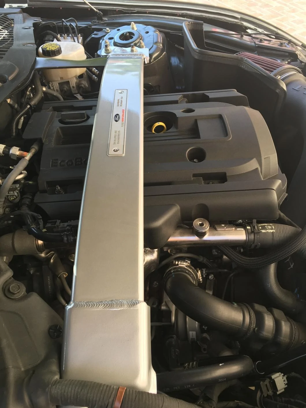

I just this morning installed my brace kit from Ford Performance. It included the Cowl Brace as well as the Strut Brace. I have a base Ecoboost 2017 Mustang purchased new a maybe six weeks ago. It now has 750 miles on it. A week or s ago I had the Ford Performance Procal kit installed for tune and intake HP/TQ which was worth the investment at $511 delivered to my door.
However, the $148 spent for the brace package was a bargain for ride and handling improvement bang for the buck. I don't autocross or drive aggressive, but the ride with the kit seems to keep the car more firmly attached to the road. It stays level on turns, feels more solid under all conditions, this is the way that the car should have been delivered in stock form from the factory. It is difficult for me to put into words the improvement this kit has made to the car.
