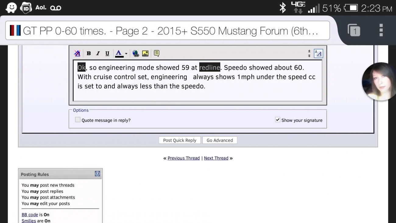

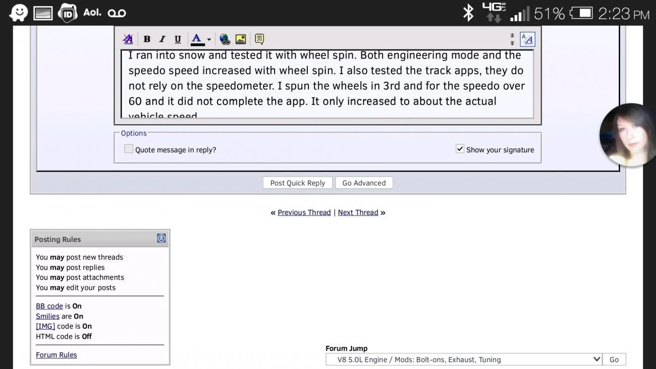

Sure thing bud, deflect all you want. Yes math doesn't lie but you don't have the right info in the equation for the track app. I already agreed with you on the speedo error. Anyhow this is a small little test I did.
I didn't feel like typing it all back up so I took screenshots since it wouldn't let me post earlier.
The app I selected was 0 to 30

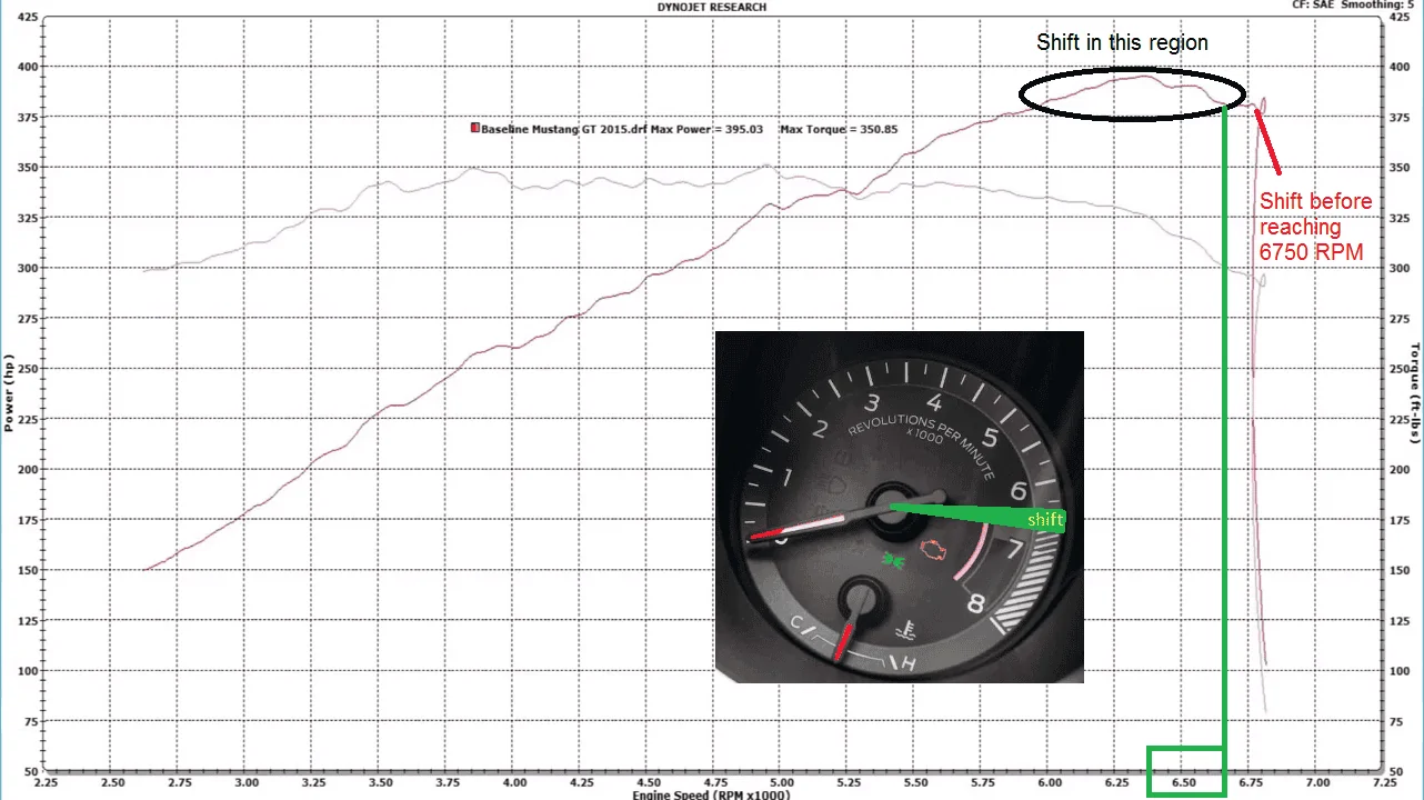

I was able to get 5.2 seconds without launch control by starting at 2500 RPM. The best results were when I shift around 6000 RPM and start off at 2500 RPM before quickly releasing the clutch (less tire spin). I think the main issue is that when I was shifting after 6400 RPM (best shift point), it takes a few hundredths of a second to physically move the shifter into second and that time ends up making me shift after 6750 RPM in reality. If you shift at 6750 RPM or higher, the power is lost. So as soon as you see the tachometer reach around 6000 RPM, it's time to tell your hand to start to shift as you might just make the shift around 6400 RPM if you are lucky.

Here's what the shift point should be from the HP/Torque graph:

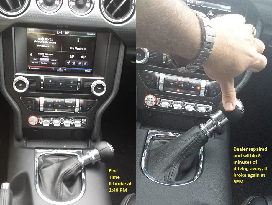

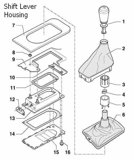

When I was trying to do a 'quick-shift' with the factory shift knob, I broke it off! I was able to still drive the car back to the repair center since it broke off while in 3rd gear and they fixed it. However, within 5 minutes of it being fixed after I drove out of the dealer, it broke again. The service guy said there is a screw that holds the assembly together and it had come loose. I asked him if he checked if the threads were stripped and I needed a new screw and he said no, it's fine. However, I suspect he did not closely examine the threads and I probably need a new screw. I'll see how it goes over the next few days, but now I'm worried to aggressively shift the stick for fear it breaks at a bad time (like when the service shop is closed or I'm at work).
For more info and pictuers on the broken factory shifter, see this thread:
http://www.mustang6g.com/forums/showthread.php?p=405652#post405652

I barely drove the car today and the stick is breaking again. The first sign of an issue is when I can go into reverse without pulling up on the part marked below as (1). The next sign of the issue is when 3rd gear is slightly difficult to get into. Finally, the stick just falls off and the car gets stuck in whatever gear I was last in. I will take it back to the dealer tomorrow for the 3rd attempt at a repair. It has not fallen off yet, so back to the dealer after I check in at work.
That is ridiculous! I'm will be installing an aftermarket shifter.

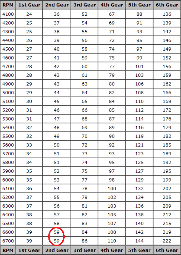

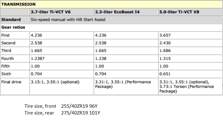

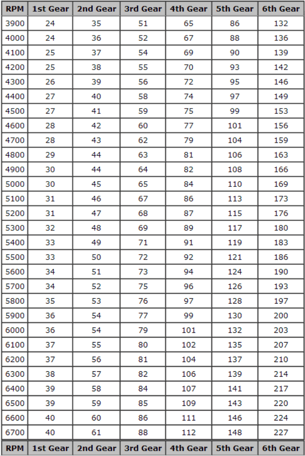

I just repeated the calculation that was posted earlier to show the RPM versus MPH in each gear with 3.73 rear end. I found a discrepancy between the front tire size max MPH in 2nd gear and the rear tire size max MPH in 2nd gear.
It looks like if the track-apps is based on the front tire size, you can only hit 59 MPH in 2nd. If the track-apps is based on the rear tire size, you can hit just over 61 MPH in 2nd. Looks like track-apps is based on the front tire size (or an average of front and rear):
Calculation using rear tire size/gears/RPM:
Calculation using front tire size/gears/RPM:
So that seems to be a good explanation on why you can't hit 60 MPH in 2nd. Note the calculator I used was found here: http://www.f-body.org/gears/
