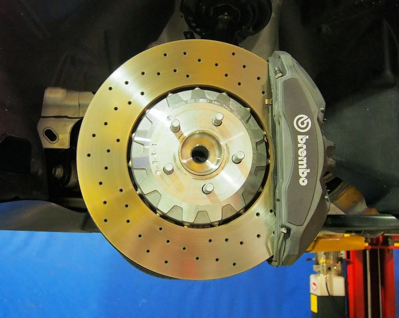

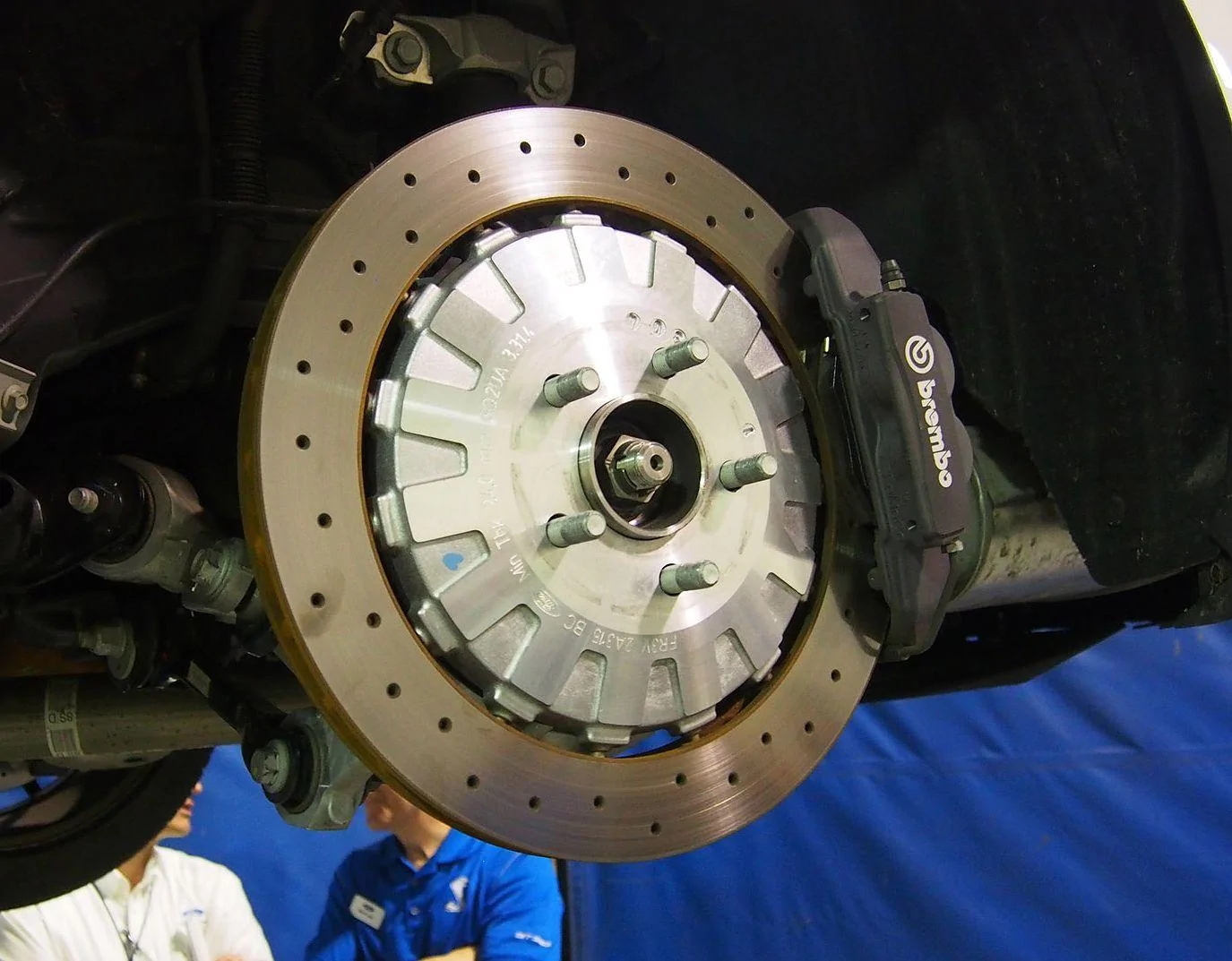

For the GT350 I will stay OEM for several track days, and see how things hold up. I am a little leery about the design of the rotors, and don't really know why Ford has done something different that most two-piece setups. Is their approach actually better, or is it simply cheaper? I also wonder what the caliper design is like.
I suspect that I won't need to do much except maybe pads and fluid. If I am not feeling confident about the brakes, I don't have a problem going to a nice kit, but with the work Ford seems to have done on these I am hopeful that no major changes would be required.

Those 6pot fronts look very similar to the GTPP 6 pot's. Wonder how much of a difference there is?
krt22
May 27, 2015
4,555
2,014
CA
2016 GT350 Track Pack
Likely not a huge difference, but does the GTPP have floating rotors?
I did the googling...the GT350 calipers look beefier (not as much material removal around the pistons and a larger pad surface) and the GTPP does not have the floating rotors.
