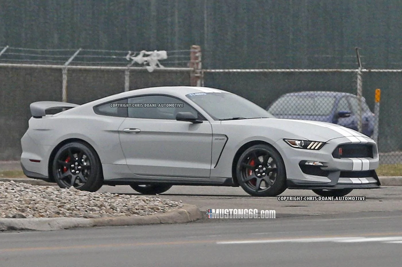

does anyone know if you can change the brake calipers color on the GT350R from the standard color of Black to Red ???? If yes, can you share on how? is there a special order number for the change
Red is the standard brake caliper color for the R. No options for caliper color changes on the R or GT350 as far as I know.
